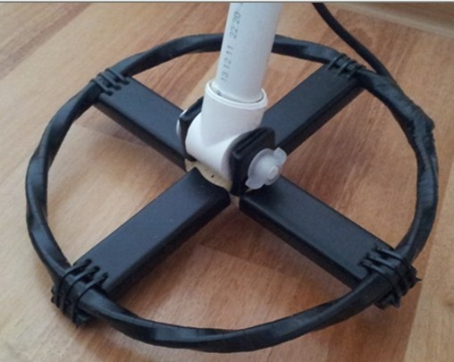

    • @ 6666
      Hi 6666, No, it's my smaller coil that is currently on the Surf PI Pro and sampling at 12uS, I think it's roughly 6.5 x 8.5 inch, 23 turns, .4mm. The larger coil will probably also sample at that delay but I built it for the Baracuda and havent tried it on the Surf PI yet. No longer have the Baracuda and can't remember what was the minimum delay i could achieve.
      Cheers, Jim

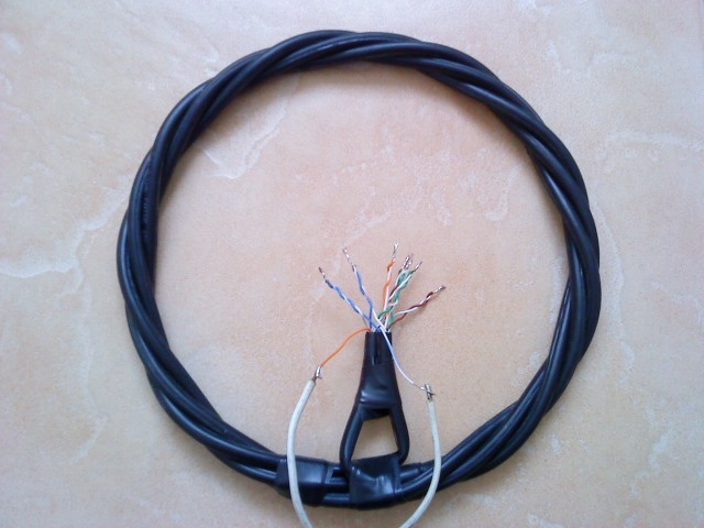

        • Originally posted by goldstar View Post
          Thanks, let me ask. Are you using 1 wire to make your coil or 2 wires? Let me explain when you buy the network cable, inside are 4 pairs of 2. Your coil is make of 1 pair of 2 of those 4 pairs? Or you do the same I did, I separate the 2 cables of that 1 pair of
          2 and use only 1 wire to make my coil.
          Yes. I have untwisted wires using electric drill. Sure it is a lot of work so it is better to buy 75 ft. network cables to save time because to make a coil you need only 55-60 ft. of wire in one piece. One cable let you make 8 coils. (8 wires in 4 pairs)
          • Cat7 cables come with wire shielding, so in order to make a real shielded coil you'll need less than 20ft of such cable and some smart wiring. How about that
              Interesting idea. Probably you can make a coil with using 2-3 loops of such cable.
              It may work if you want to push such cable inside plastic pipe.
              But probably the results will be away from optimum:
              1. Massive cable shield will keep eddy currents flowing inside the shield and make coil slow.
              2. Stray capacitance between twisted wires will delay decay and make coil slow.
              3. Stray capacitance between wires and shield will make coil slow.
              4. You will have 8 soldered connection inside the coil so you have to insulate it good
              or you will have some falsing and noise from moisture or current leaks.
              But you can try and compare it with another coils. May be it is not so bad.
              Anyway it is not good to use in water because it will be as bulky
              as any one stupid brand name detector coil and you will hate it once you will try to move it in water

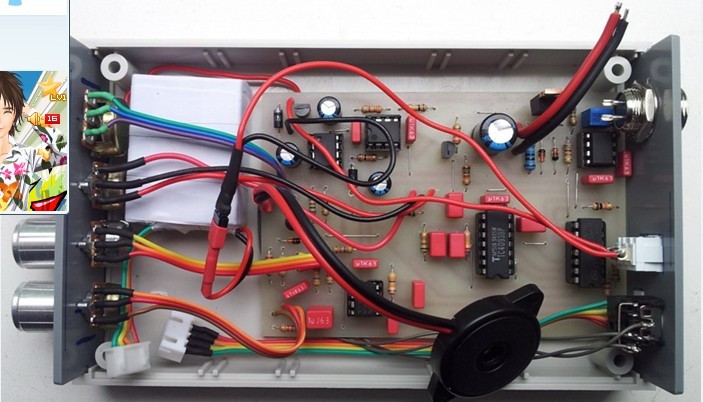

                • I got a few blank surf PI boards.
                  Recently populated and made a simple " dia coil 20t 0.3mm and it works suprisingly well - my coil has no sheild either.
                  Battery and pcb (wrapped in a pizza flyer so I dont get a jolt off the pulses) in coat pocket, long 2m RG174 to coil on a bamboo stick.
                  Adjusted without scope or meter. good little project you can start and use in the same day.
                  coil fits in pocket too, handle doubles as ramblers cane.
                  My try the pro one day

                    • Hi
                      Can someone explain in theory how using a cat 5/6 and connecting the cores in series, works the same as running continous single or pairs.
                      The reason why im asking is because by wiring in series within the network cable as a whole your in effect going from start of the coil to the end, then back to the start and so forth, unlike conventional winding which is start to finsh in one run.
                      It oviously works because a few of you here have had success and its been done previousy that way for a few years, I myself have tryed both ways using the Minipulse3 and striping cat5 and wiring continous is by far better result where as by series the cables has givin me very poor results.
                      Maybe its down to detector design, maybe not.
                      Many thanks in advance
                      • hello satdaveuk
                        use cat cable with higher diameter cat 5 ist to thin
                        better cat 6e or search wiki for utp network cable twisted pairs and the hole cables have only one shield for example stp type cable every pair has his own shield and that would be to much metal shield should be so small that it wouldnt be detected by the coil which is shielded with it
                        wire connecting is easy
                        easy example
                        start orange
                        orange connect to green
                        green to blue
                        blue to brown
                        brown end
                        so orange and brown are connected to pcb
                          hello satdaveuk
                          easy example
                          start orange
                          green to blue
                          blue to brown
                          brown end
                          Yes I understand what series means and wouldnt dream of using cat5e with screen for ovious reasons.
                          The cable I experimented with was cat5e unshielded which I carry in stock, the proper stuff what I use when installing networks, not the crap thats floating about on fleebay.
                          Has anyone else here actually tryed either paird or single to make a pi coil rather than using one complete cat5e and wiring in series, because if you haven't I sugest you try it and tell me your results to see if they marry up to my results, otherwise will have to make the surf and prove results myself.
