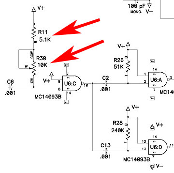

      For some reason I can pick all types of metals, including Silver. But not 14k gold, only 10k gold and I think that I can pick 10k gold because is not that pure. Why? should I work on my coil to do it better? I got a signal on a medallion and when I bring it home the first thing I did is to pass it near to a magnet and it stick it to the magnet and ... I try different setups using some 14k gold chains and nothing.
      I have no problems to detect gold with my PI. Any gold. 10k, 14k, 24k. And more. Most of gold rings I am detecting from distance 1.5 times far then distance I detect coins.
      First of all I am using short delays. 20 micro seconds or less. Check your R25 and delay pot P3 (hear input 8 of U4C - MC14093). If you have it 15k + 100k it is just wrong.
      Every 1 kilo Ohm in R25 + P3
      chain is practically equal to 1 micro second of delay.
      So if you using 15k + 100k in max range it will give you more than 115 micro seconds that is far away from gold ring decay time and good to detect coca can .
      You will never set precise delay with such range.
      Check original Surf PI Pro schematics below. It has 5.1k + 10k pot on the place instead of 15k + 100k pot for version we all building till now.
      I am using 7.5k + 22k pot to be able adjust delay in range I need but only because I search in salt water. For dry sand 5.1k + 20k pot will be OK.
      Also I think that coil design is important too. If you using single AWG 24 wire, not stranded, it will decay as long as your gold ring.
                          If you have connected coaxial cable straight to the coil than shield
                          in your coaxial cable will keep eddy currents even longer than gold ring decays. I am using twisted pair of stranded wires to keep coaxial shield away from coil.

                          Thanks I did read all your post and I just follow everything you wrote so I reshape my coil I use 24 awg wire "because "I. Was using 22awg " so I buy the same you post and I make an oval coil using 8" diameter coil and I detect a small 14k medallion at 3 inches. I did work on the delay to make it shorter. And I haven't check the resistor you are talking about. So maybe its better to use the oval coil or I think because the 2 sides of the coils are near an when the gold pass its making the gold more detectable. I'm going to post some picture of the coil and all my findings and the mesaurments when I sit on the computer because now I'm using my phone. The surf pi works we have to give time.
                          • I guess I will be back later because here in Puerto Rico is 11 in the morning. And maybe all of you are sleepin. So I will be back in the night.
                            My configuration with my 8 inch oval coil.
                            My P1 =100k [Trimmer] is on the midle
                            My P2 =10k [Tune] I'm using a little bit of noise so I can hear the sound when gold is near
                            My P3 =100k [Delay] is off completlly. And I'm gettin the gold, I wll check the resistor to make it more sensitive to gold.

                              Usually round coils give more depth than oval coils but oval coils cover more ground in one sweep. I like long coils that cover more ground even if there is no maximum depth to go faster. So you can choose what you want: speed or depth.
                              Get rid of 100k P3. Put 15-20K on P3 instead. And adjust it to have maximum sensitivity.
                              Replace R25 on 5.1k.
                              Even small difference from 0k to 10k of P3 will give you changes in sensitivity to gold in two times. 100k in full range will discriminate gold out completely.
                              Maximum sensitivity it is not always minimum value of P3. Only with 15-20k pot you can find that peak precisely but not with 100k.
                              Also there may be something wrong with this medallion too. Cavities, bad metal composition making it high resistive. Try it with gold ring or better with several different gold rings to be sure.

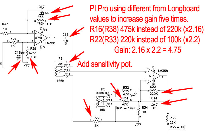

                              If everything works OK and assembled correctly you can try to rise sensitivity:
                              - You can change integrator values and add sensitivity pot like you can see it on PRO schematics.
                              - You can try increase pulse width changing 3.3k to 4.3k, 5.1k.
                              - You can try to increase dumping resistor from 390 to 430, 500 ohm. With some coils I even using 900 ohm.
                              All those measures can make your detector unstable so use it carefully to keep it working on the edge with maximum sensitivity but reliable.
