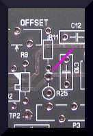

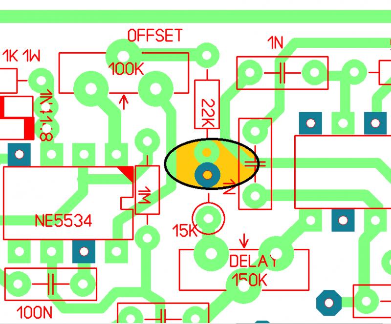

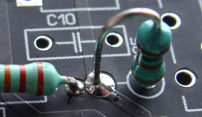

    Soldering R11 and R25 Resistors in place question
    I just fixed soldering resistors in place. Afterwards, thought about R11 and R25 solder pads.
    Don't remember if there was a trace connecting the two on top or if the solder pads were touching and the two resistor leads were to be soldered together or they were supposed to be separated on top. I know I bridged the two leads on one board but can't tell for sure on the other two even with a 16x jewelers loop. Taking a picture of the two boards looks like they are not bridged.
    Any clarity would be helpful as I can't tell from the orig. PCB pictures I took.
    Let me know so I can correct the board before I move any further.
    • #77
      Hello Sven,
      No problem if you made a "solderbridge" on the top layer, at the bottem layer the resisters are connected, both resistors are connected to +5 volt.
      At the most down jpg the top layer is turned off...
      Succes !
      Ap

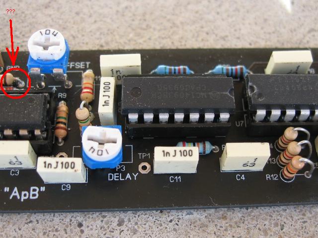

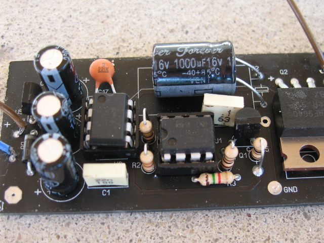

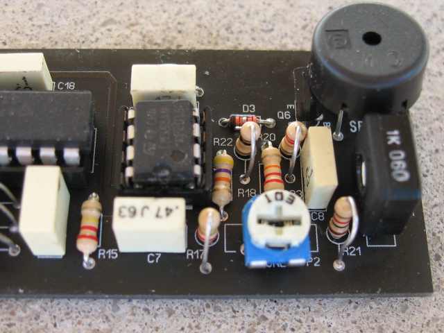

                HELP!!!
                Got my board completed. None of the pots are doing anything just getting a constant tone. When I turn each pot there is no change at all. The volume works as I can adjust the loudness but the coil is dead. Here are some pics maybe I screwed up somewhere.
                • #83
                  D1 - D2 ???Click image for larger version
Name:	bobs surf pi 002.jpg
                  • #84
                    d1+ d2 are where they are suppose to be with the correct orientation. Is that what you are asking?
                    • #85
                      Originally posted by plumabob View Post
                      HELP!!!
                      Hello Bob,
                      You have sound, so there are 'things' working. Put all pots in mid position.
                      Check now if your tune pot is working, it can be that you have to turn it (counter) clockwise to make the sound go away...
                      Succes
                      Ap.
