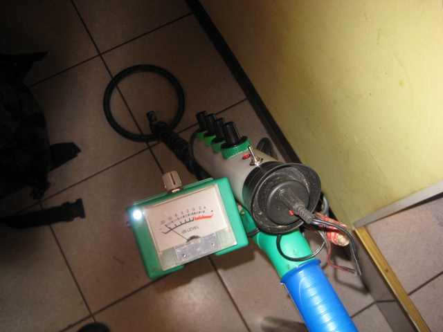

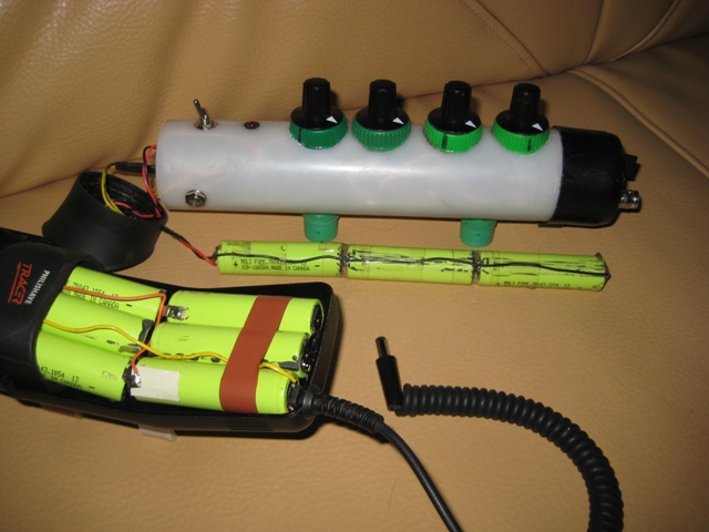

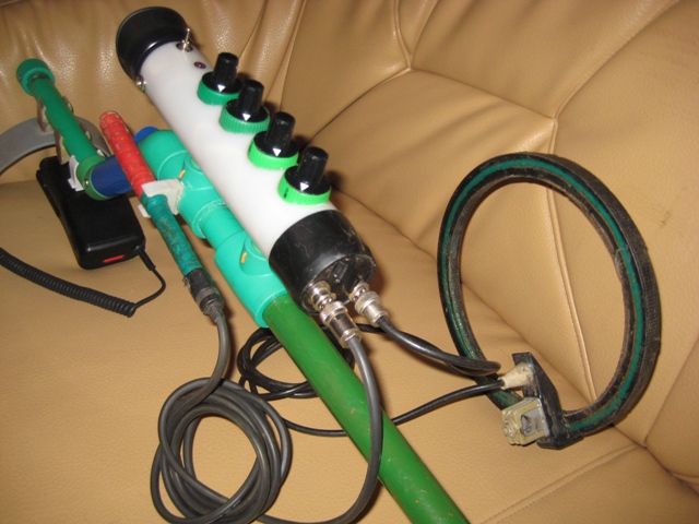

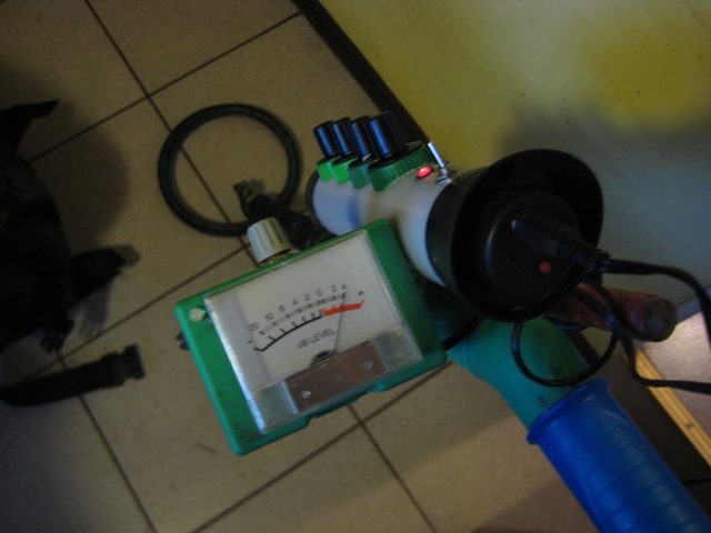

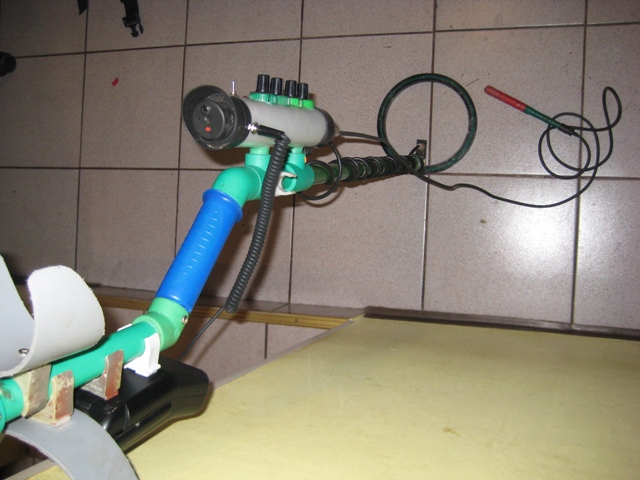

      • Ready for field testing - thanks to this forum
        http://www.youtube.com/watch?v=HdtYFCj2UxQ
        • Good Job !
          Pictures of completed projects are great - inspire many ideas
            Why the lower part of the detector made of aluminum ?.... Need to be made from steel!
            • Originally posted by smity View Post
              I have thought about stainless nonmagnetic steel or a complete plastic shaft for the lower part. But steel increase the weight and it is not so easy to work with. I dont know whether there is a big bad inluence from the lower alu part. In ratio to coil it dont move but it could have an impact to my magnetic pulse field?
              • professionals do it also
                see here they also use a crutch
                http://kts-electronic.com/content/view/16/57/lang,de/
                or did the made a mod to the lower part seen also at russian forum
                i will try a plastic lower end hope i got the right size in diameter at my hardware store
