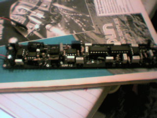

  • I can see whats going on now, I have almost finished my surf pi 1.2 board, and just got to far right hand end of the board,
    and I have noticed that for some reason on this board the "threshold" control is now called "tune"

            • Hi All
              I got my surf PI working today
              replaced a blown 4093
              and a way she went, I need to put it in a box
              and tune it up , looks like a bit of ringing on pin 6 of 5534, but its working
              The coil is nothing special, 21 turns .41mm , 9 inch Dia.
              detects an Australian 20cent coin at about 7 inches, small gold ring about 6 inches
