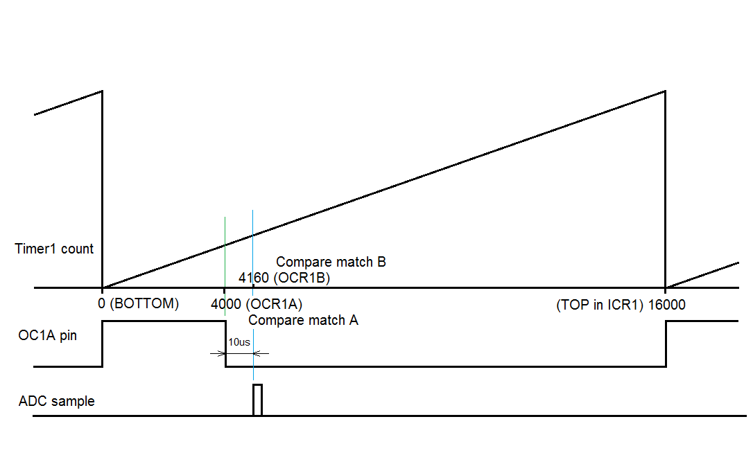

    It's better to use one PWM pin (OCR1A) for driving the MOSFET without servicing any interrupts.
    Pages and table references for Atmega328P datasheet at https://www.sparkfun.com/datasheets/.../ATMega328.pdf
    PHP Code:
    /*  Pages and table references for Atmega328P datasheet at    https://www.sparkfun.com/datasheets/Components/SMD/ATMega328.pdf
        Clock assumed to be 16MHz.                          */
    #define F_CPU 1600000L
    uint sampleDelay = 16 * 10; // 10 us sample delay;
    void init(void) {
      /* Timer 1 in Fast PWM mode 14 (page 136, Table 13-4)  */
      TCCR1B |= (1 <<  WGM13) | (1 << WGM12);
      TCCR1A |= (1 << WGM11);
      /*  Compare output mode in Fast PWM:
          set OC1A at BOTTOM (0 count),
          reset OC1A on compare match. page 135, Table 13-2     */
      TCCR1A |= (1 << COM1A1);
      /* Compare match registers for  timer 1  */
      OCR1A =  4000;               // 250us pulse
      OCR1B =  4000 + sampleDelay; // 16 = 1us
      /* The TOP value of timer 1 for Fast PWM 14 is set by the ICR1 register (page 139) */
      ICR1 = 16000; // 1ms period, 1000 Hz pulse rate.
      /* ADC configured to sample on timer 1 compare match B
         and generate interrupts on conversion complete */
      ADCSRB |=  (1 << ADTS2) | (1 << ADTS0);  // ADC trigger source: compare match B in timer 1
      ADCSRA |=  (1 << ADATE) | (1 <<  ADEN) |  (1 << ADIE); // Autotrigger, enable interrupt, enable ADC
      ADCSRA |=  (1 << ADPS2) | (1 << ADPS1) |  (1 << ADPS0);  // Prescaler 1/128; 125 KHz
      /* Start pulsing */
      TCCR1B |= (1 << CS10); // start counter at maximum clock speed
    int main (void) {
      cli();
      init();
      sei();
      while (1){
        // do your thing
    ISR(ADC_vect){
       // do your thing
