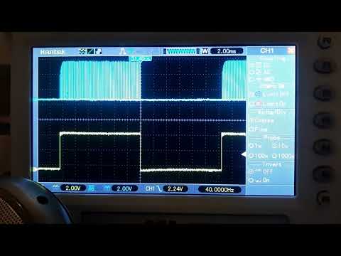

    - Timer0 produces a PWM signal at a fixed frequency beyond the audible spectrum (62.5 KHz).
    - Timer2 produces a square wave whose frequency can be set by the application.
    - TImer2 gates the output of TImer0 (pass if high, clear if low).
    - The volume of the square wave of TImer2 will depend on the duty cycle of Timer0 (set by the application).

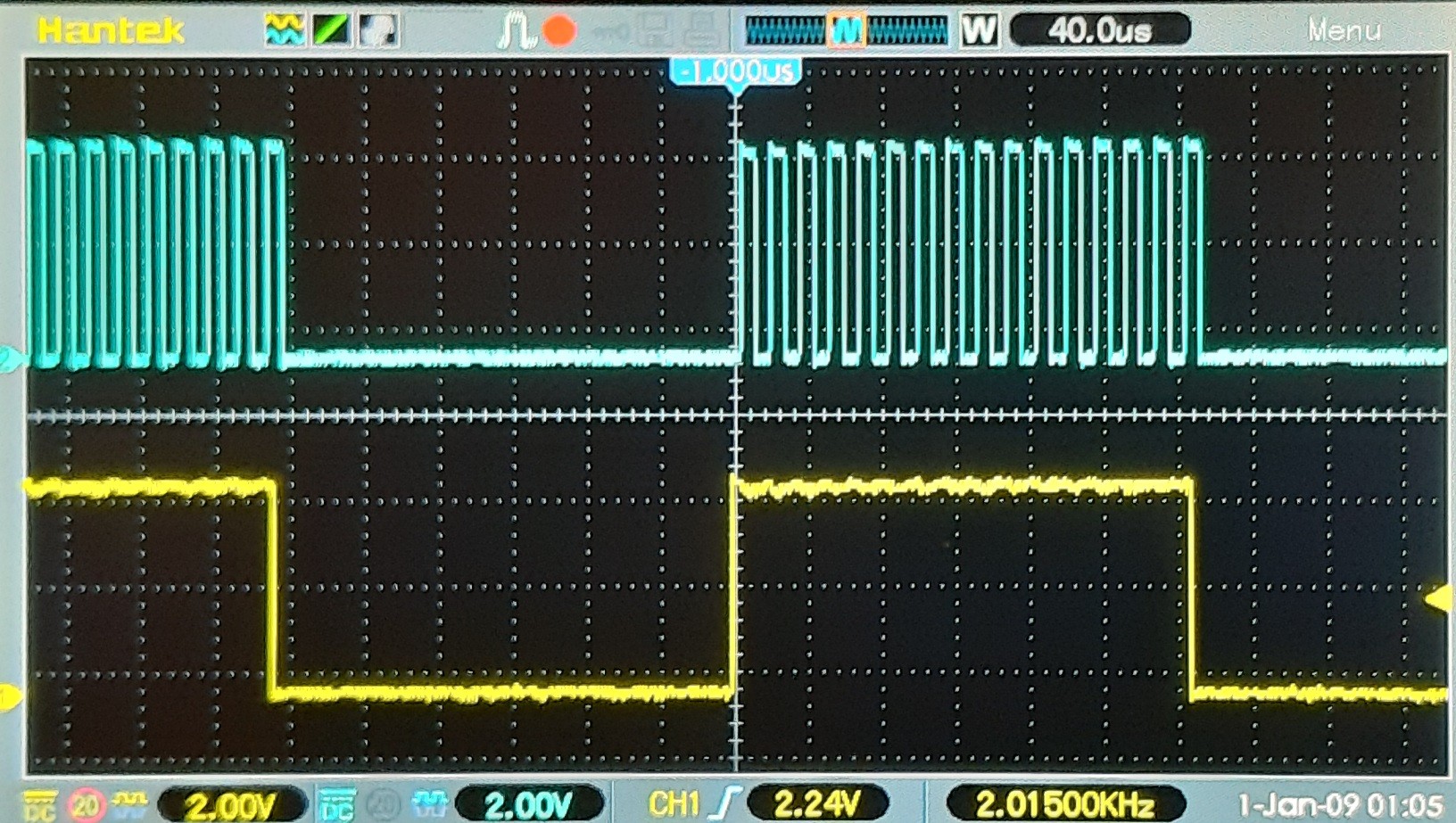

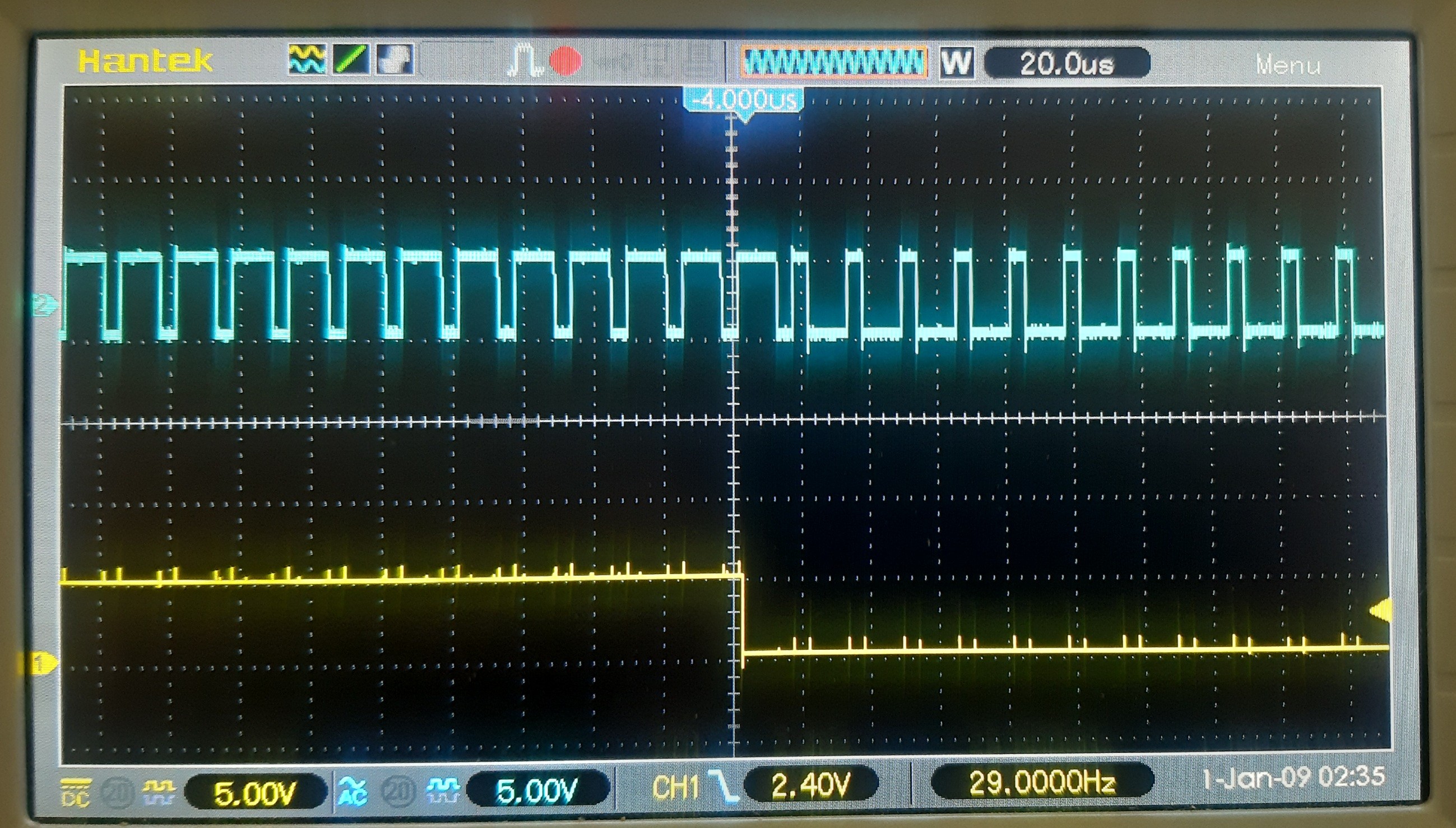

    This is an improved version of the library.
    VolumeSymetric.zip

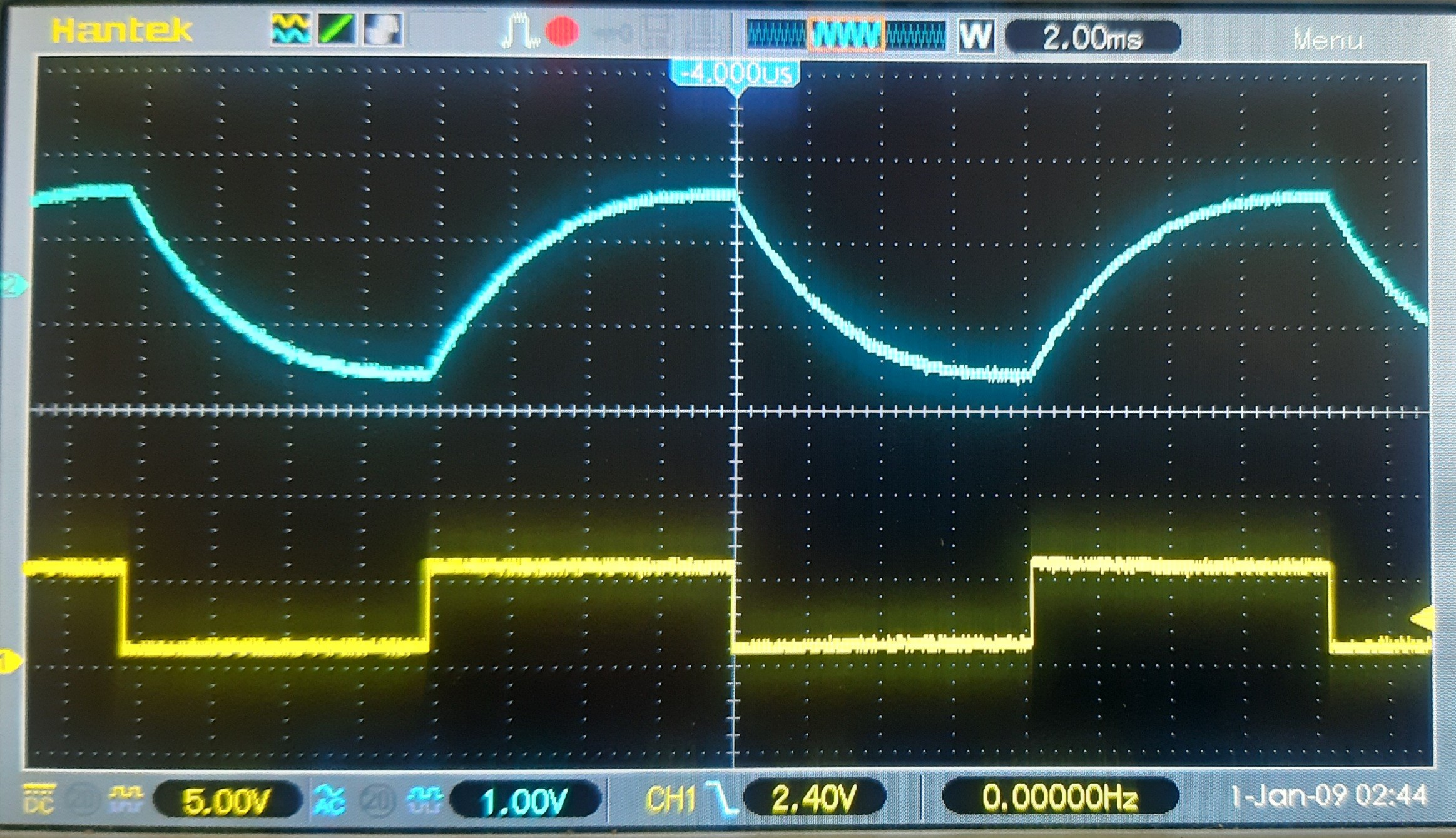

    The PWM modulation is now symmetric. For example, if the duty cycle during the "on" time of the square wave (yellow trace) is 75% then the duty cycle during the "off" time is 25%. The resulting low-pass sound wave (blue trace) is centrered around Vcc/2 and is perfectly symmetric.
    Click image for larger version  Name:	20240204_154640.jpg Views:	0 Size:	714.7 KB ID:	419807
    The modulation signal (unfiltered Timer0 output, blue) looks like this
    Click image for larger version  Name:	20240204_153659.jpg Views:	0 Size:	915.4 KB ID:	419808
    The sound produced is free from cracking artifacts because the DC bias is fixed to Vcc/2, unlike the former library.

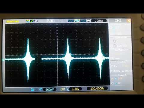

    This is an example of the sound caused when sweeping in and out of a target by modulating both the frequency and amplitude as a function of the target signal. Base frequency is 216 Hz. See the sketch "target.ino" in the examples folder.
    And this is how it would sound with amplitude only modulation.

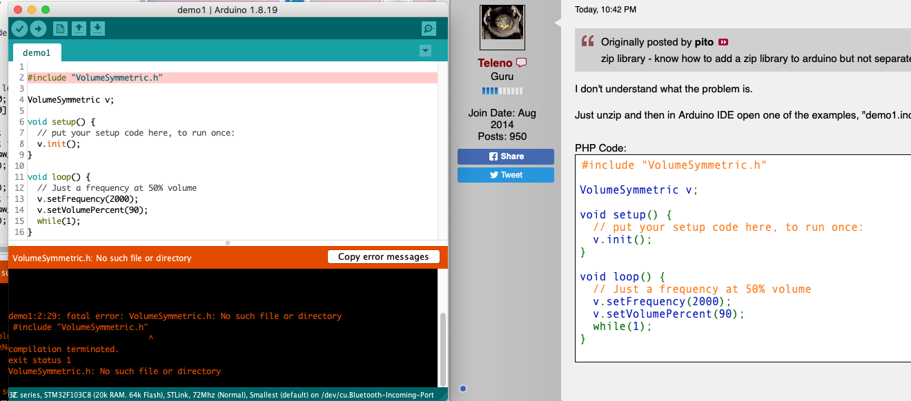

      fatal error: VolumeSquareWaveNano.h: No such file or directory
        How did you do the installation?
        The unzipped files should look as follows:

          I didn't, I do not see a zip file for it .
            Try this link
            https://www.geotech1.com/forums/file...etch?id=419973

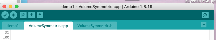

              zip library - know how to add a zip library to arduino but not separate cpp. and h. files which are in your folder.
                I don't understand what the problem is.
                Just unzip and then in Arduino IDE open one of the examples, "demo1.ino" is the simplest, and look how they're coded.

                  The problem is that the .h and .cpp files both need to be in the same directory as the sketch.
                  Simply copy the two files into the demo1 folder (for example) and the sketch will compile.

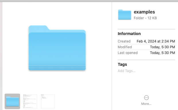

                    Just unzip and then in Arduino IDE open one of the examples, "demo1.ino" = I did
                      Strange, in my Arduino IDE (2.2.1) that requirement is not necessary.
                      I think I should have put those files under a "src" folder.
                      Try this: in the VolumeSymmetric folder create an "src" subfolder and move the .ccp and .h there.
                      This zip has the correct directory tree
                      VolumeSymmetric.zip
                      https://www.geotech1.com/forums/filedata/fetch?id=419984&d=1707346796
