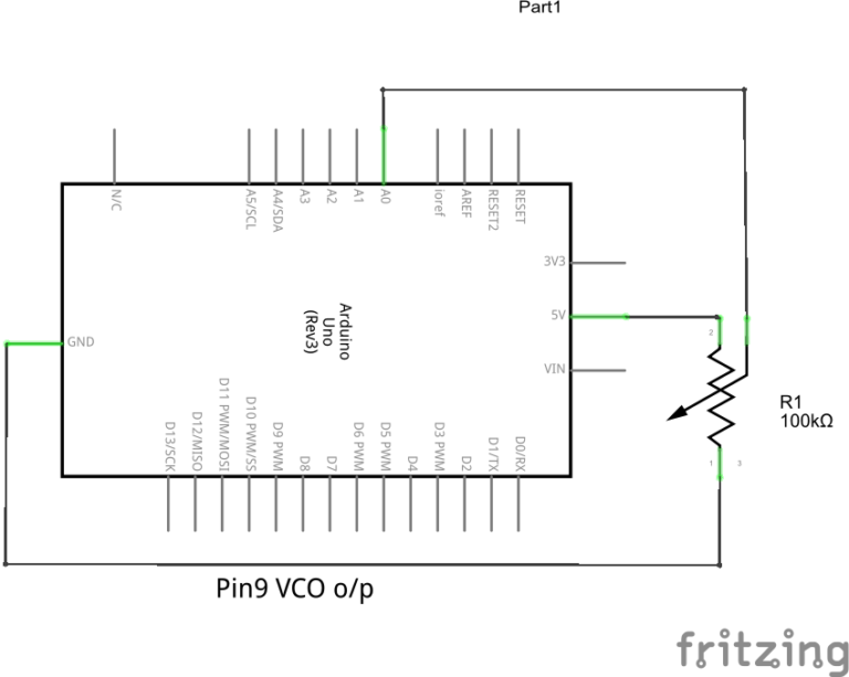

          here frequency is depend to voltage on A0, in your case is not related to voltage on analog pin, so is kind of music box.
          Click image for larger version  Name:	image.png Views:	0 Size:	55.2 KB ID:	419996​
          HTML Code:
          void setup() {
           pinMode(9, OUTPUT);
          void loop() {
           int frequencyinput = analogRead(A0);
           frequencyinput = map(frequencyinput, 0, 1203, 50, 5000);
            tone(9, frequencyinput);
           delay(100);
            HTML Code:
            void setup() {
            pinMode(9, OUTPUT);
            void loop() {
            delay(100);
            My friend, I posted a LIBRARY, not a PI sketch.
            You write your own PI sketch that reads A0, maps the frequency and then passes the frequency to the library using "setFrequency()". You can also read another pot in A1 ans map the volume to a value betwen 0 and 127 and pass it to the library using setVolumeRaw() or setVolumePercent().
            I won't write your code, i wrote a library so you can write your own code, whether it's a music box or a PI it's the same library.
            Code:
            #include <VolumeSymmetric.h>
            VolumeSymmetric v;
            void setup() {
                v.init();
            void loop() {
                int volumeinput = analogRead(A1);
                frequencyinput = map(frequencyinput, 0, 1203, 50, 5000);​
                volumeinput= map(volumeinput, 0, 1203, 0, 127);
                v.setFrequency(frequencyinput);
                v.setVolumeRaw(volumeinput);
               _delay_ms(100);
            ​you must use _delay_ms() instead of delay() for this library.
