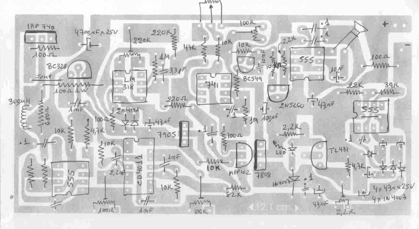

            Schematic (PDF-131K)
            PC Board (JPEG-167K)
            Parts Placement (JPEG-134K)

            The PCB for this project is a JPG file (PCB1), the final printed dimensions should be ~65mm X ~130mm. I recommend using the photo process to create the tracks, since the circuit is more or less complicated. After printing PCB1 flip the paper, the printed surface is the one that will be in contact with the copper layer. The components placement is in file PCB2.
            Please note that there's four jumps, make then with standard isolated copper wire. The S1 (jack support) is optional, and can be placed in the case. Keep the components with short leads, and close to the pcb, to avoid capacitance and inductance.
            Note: I've taken much care in making this pcb, I believe no tracks were forgotten (since this is insured by the software), nevertheless if any error as to be found, please inform me right away. [[email protected]]
            IMPORTANT
            After making the pcb, please check the tracks that go inside 4093 pins, insure that they are not short-circuited (correct with a x-acto blade if needed).

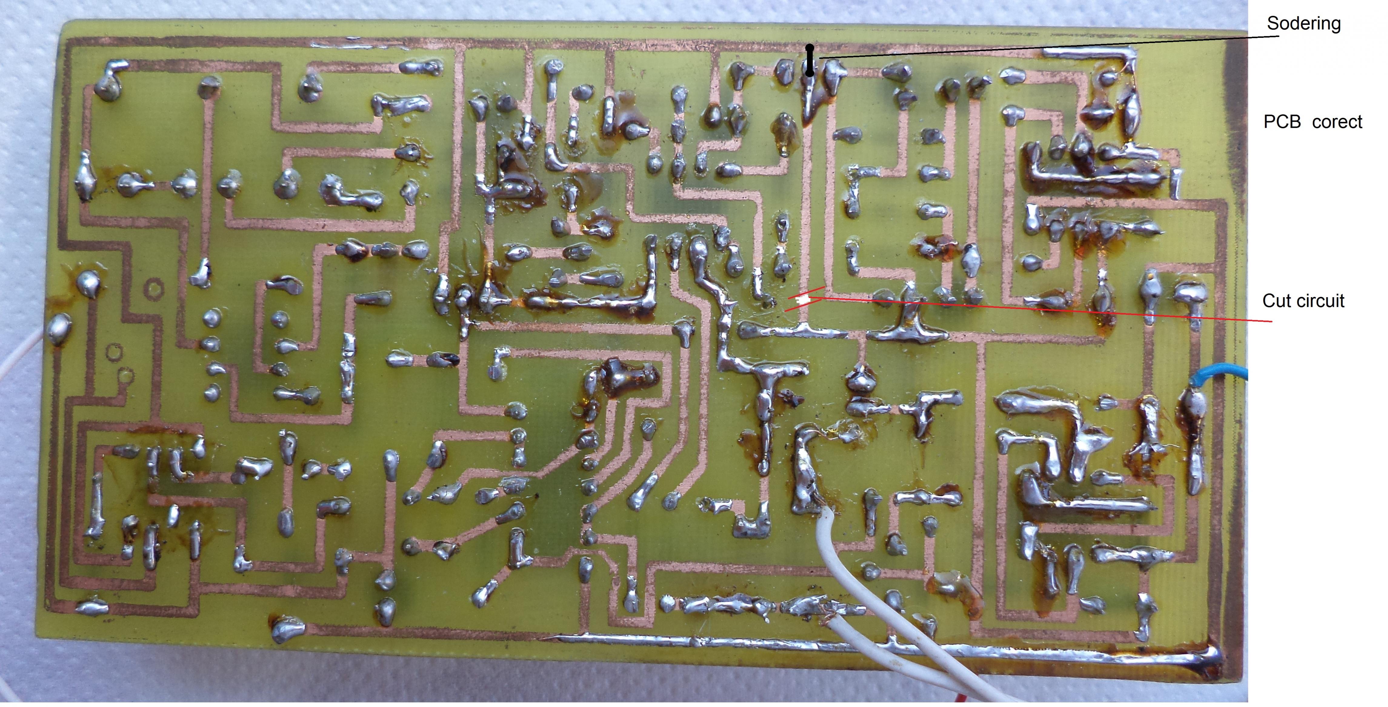

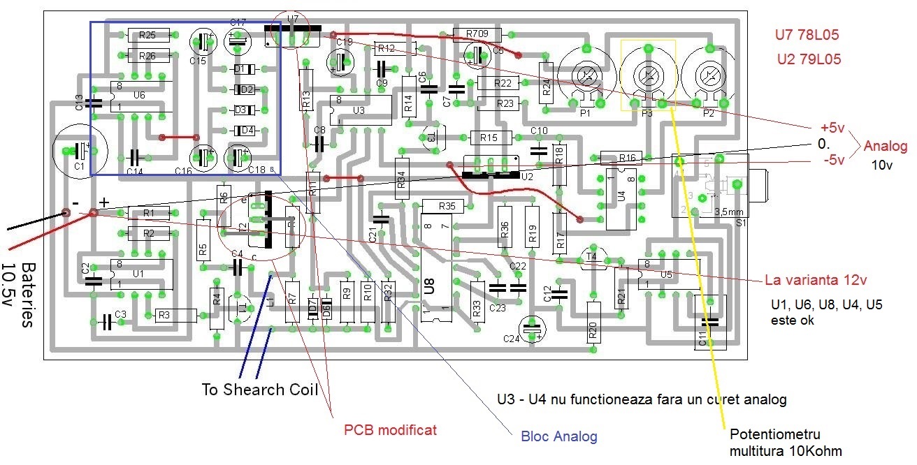

Name:	pi pcb modificat  corect.jpg
ID:	340329 I got this circuit built a buddy and I found the problem (for those who have made ​​this project) Click image for larger version
Name:	pi pcb 2.jpg
ID:	340330 now it works
