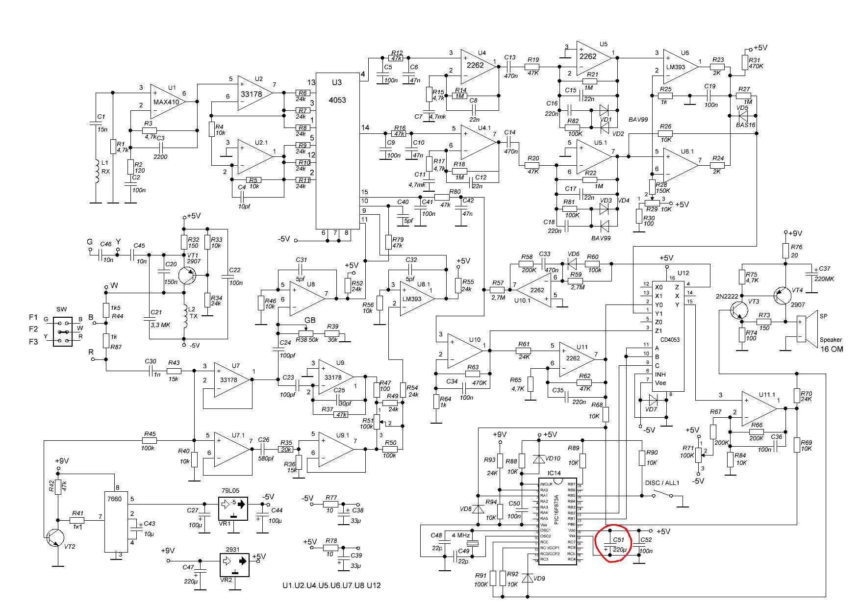

        • C51 appears to be reverse polarity.

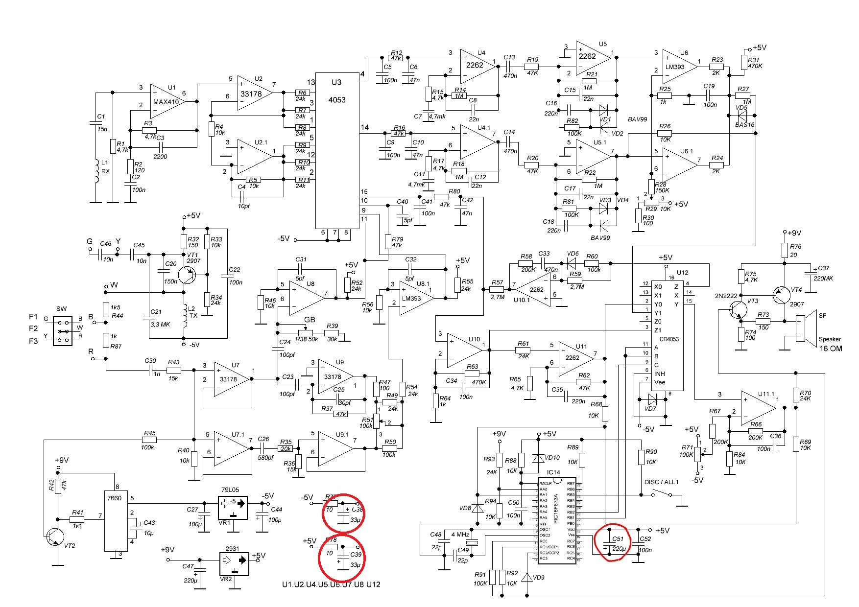

          • also C38 C39 Click image for larger version
ID:	337029 inversely
            • С39 also ))))))))))
              too many errors for one sheet )))))
              • C47 also
                • U3 has No pos supply.
                  S

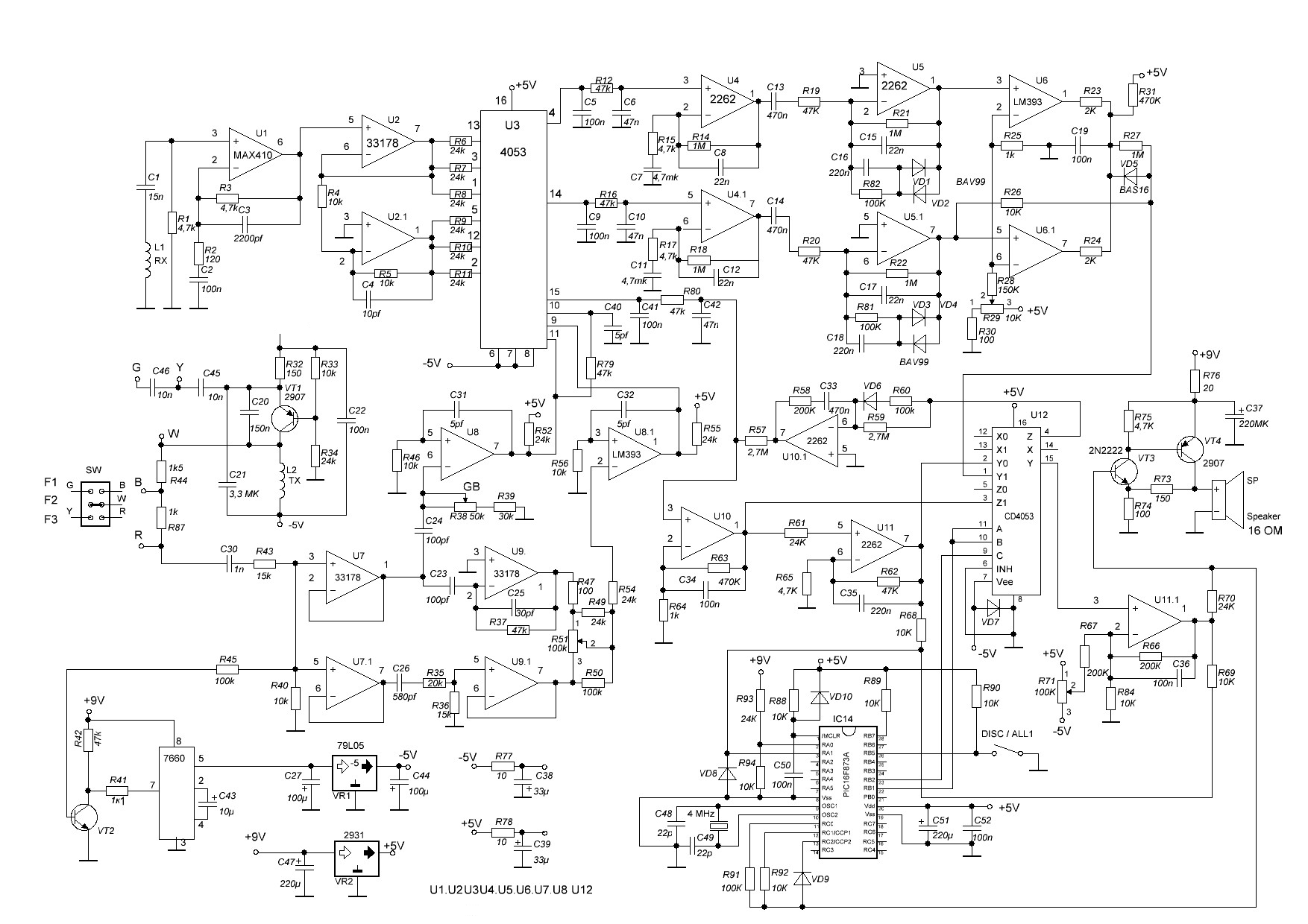

                  • I edited the image to make corrections. Any other changes needed?
Name:	Cibola_Original (corrected).JPG
                      With additional infos that i got recently; i made corrections in Cibola schematic and finally made it.
                      There are many differences between "original" one and the one i made.
                      The one i made now is working indeed decent.
                      So far i tested it ONLY in DISC mode and therefore i can't claim anything relating to All Metal mode and Nonmotion.
                      I get decent air distances for various items.
                      GEB is working just nice; rejects all minerals, ferrite etc...
                      Disc is working excellent!
                      Treshold is working, Sense is working... seems everything is on it's place.
                      I couldn't obtain some of "original" ic's so i made series of checks and tests and established most proper ic's for present conditions that i have now.
                      Funny thing, but TL061 is performing very well at RX front end!?
                      Much better than a pile of other types that i tested!
                      I intentioanlly wanted to avoid second 4053 and instead i will use ordinary mechanical switches, by now i only made wire jumpers so to settle it only in Disc mode.
                      Also i intentionally wanted to avoid use of CD4024 and instead i used simple VCO taken from White's Classic schematic.
                      Without additional buffering; 7660 will not synchronize directly via resistive coupling so i used most simple method: capacitive coupling!
                      What to say? This thing is working and it is working indeed very decent!
                      I have original Tesoro coil (for Tejon, Cibola and Vaquero) and all the checks i did with it.
                      Cheers!

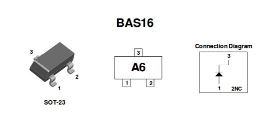

                      one question: there is a diode D5 (upper right corner) in the shematic named 16, is it a zner diode 16V ?
                      thanks
                      • It is a standard small signal diode in a surface mount package.
                        MercClick image for larger version
                        • many thanks merc,
                          i have seen it now in your schematic (i need goggles)
                          what substitute as a wired standard component can i use instead of this smd version
                          i have ivconic´s standard pcb variant (wired components)
                          i think i am finished up to 95% some little parts hard to find, like this uncommon pico farad caps
                          but will post it when i get ready
                          thanks again for fast answer
                          • A common 1N4148 or 1N914 should work just fine. Nothing special.
