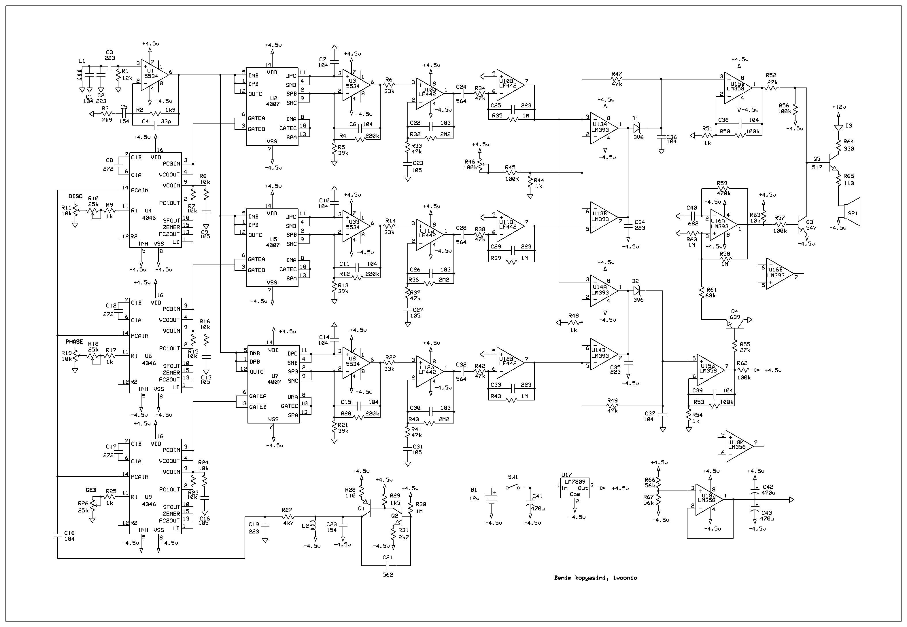

    coil 13 cm diameter rx 0.25 coil 50 turn tx 0.35 coil 50 turn 18 khz frequency dedector

      This is not PLL design at all, but VLF with PLL phase generation. Interesting and promising, looks like good design. 3 channel machine, probably some sort of ratio-metric GB employed, or 3 ch. disc. Or some combination of. Not alike similar Russian designs, i will have to retrace it completely. Coil seems to be ~10 in, actually two 13cm DD halves. Very nice.
        I'm missing a schematic here. There must be a way to produce a proportional tone with this rig...

              I took freedom to make some trivial changes, for example: instead NE5532 i used 2xNE5534 etc...
              Such changes doesn't affect nor disturb original idea and setup.

                      Here is mine. A month ago I've drawn and now I will test it. Hope it works well. Greetings.

                        Nice work!
                        I see differences.
                        I was in doubts about some wirement also.
                        Especially there at BC639.
                        Luckilly that part is easy to correct even later on prepared pcb.
                        Have you made pcb?
                        I don't like the long one so i made my own, bit smaller.
                        Cheers!
