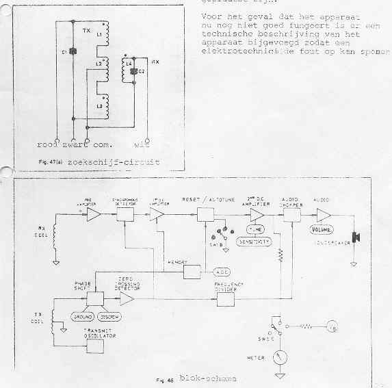

    Hallo Mohades
    I am not willing to open the coil. It is then destroyed and i don not like that. I will show a schematic of the inside of the coil.Click image for larger version
    Leendert
    P.s.
    rood = red, zwart = black, wit = white, com = common. The colors of the kabel.

      thanks this is help me.http://8pic.ir/images/m7zf8399hbgts7xn0a98.jpg i said correct in picture.
      if you have shematic of metadec , you can put that.

            i test by multi meter this components.some of them are destroyed.
            TR102,TR101,TR103,bfr60,bfr50,reg320l79l05 at the second board.
            d8,d9,d4,d11,d10 at first board.
