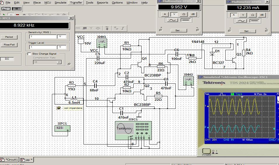

    Push-pull oscillator.Works well in practice with the values ​​of the capacitors of the pattern.

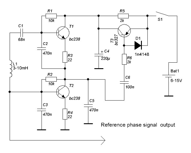

                    Clear scheme

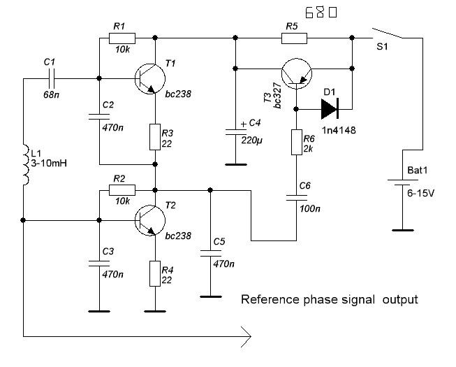

                      Change R5 -680om. For stable start.Click image for larger version

                        Thanks scs.
                        Can you explain what is purpose of this push pull oscillator in your metal detector project?
                          There is a large amplitude-50-70v pp .low current consummation-25ma in 10v. Detector working with small gain and is sustainable. With this oscillator I've done detector in 7.2Khz frequency.Work very deep.
                            Thank you. What changes in oscillations do you sense at target detecting? Changes in amplitude?
                              Detector is induction balance VLF tipe.This oscillator is search oscillator.Work with very stable amplitude and frequency.
