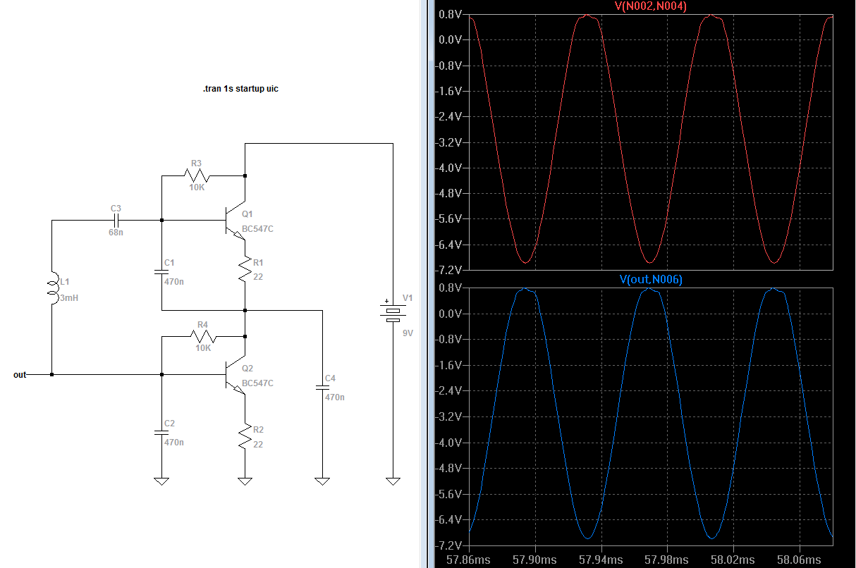

Nice, clear, you use it in your VLF/IB project. I was thinking that this could be part of some Q-response model.

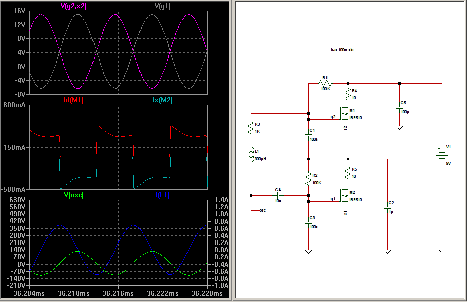

Push-pull oscillator
I do not own a white's 5000D, I had plan to make 5000D circuit from schematic diagram, with mods to make a vlf all metal deepseeker.Originally posted by scs View PostThe problem is that in most factory search coils there are parallel connected capacitors. In this circuit the capacitor is connected in series

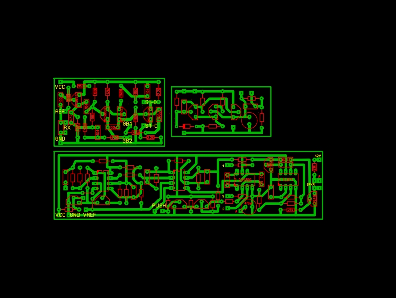

I plan to make in modular form, in order to try different things.
Your oscillator design seem interesting.
The coil, I plan to make my own DD. Here is what I have so far. Only thing missing is TX oscillator.Attached Files
This oscillator will destroy the transistors because the reverse Vbe of T1 and T2 is way -7V, the tolerable maximum being -5V.
