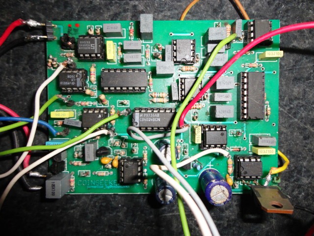

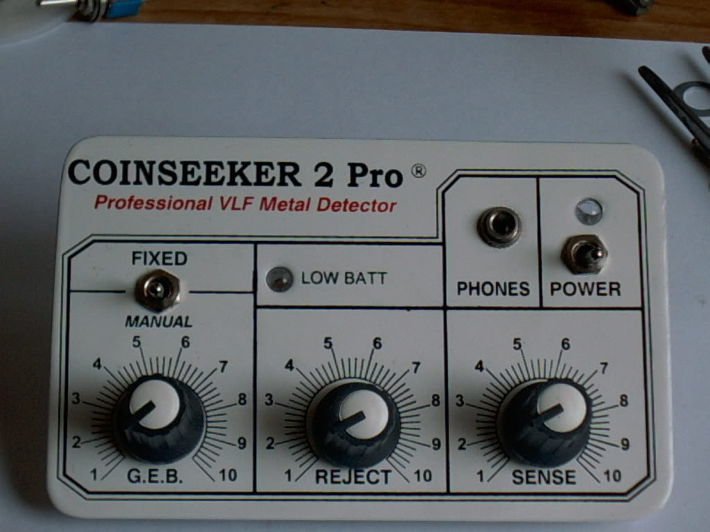

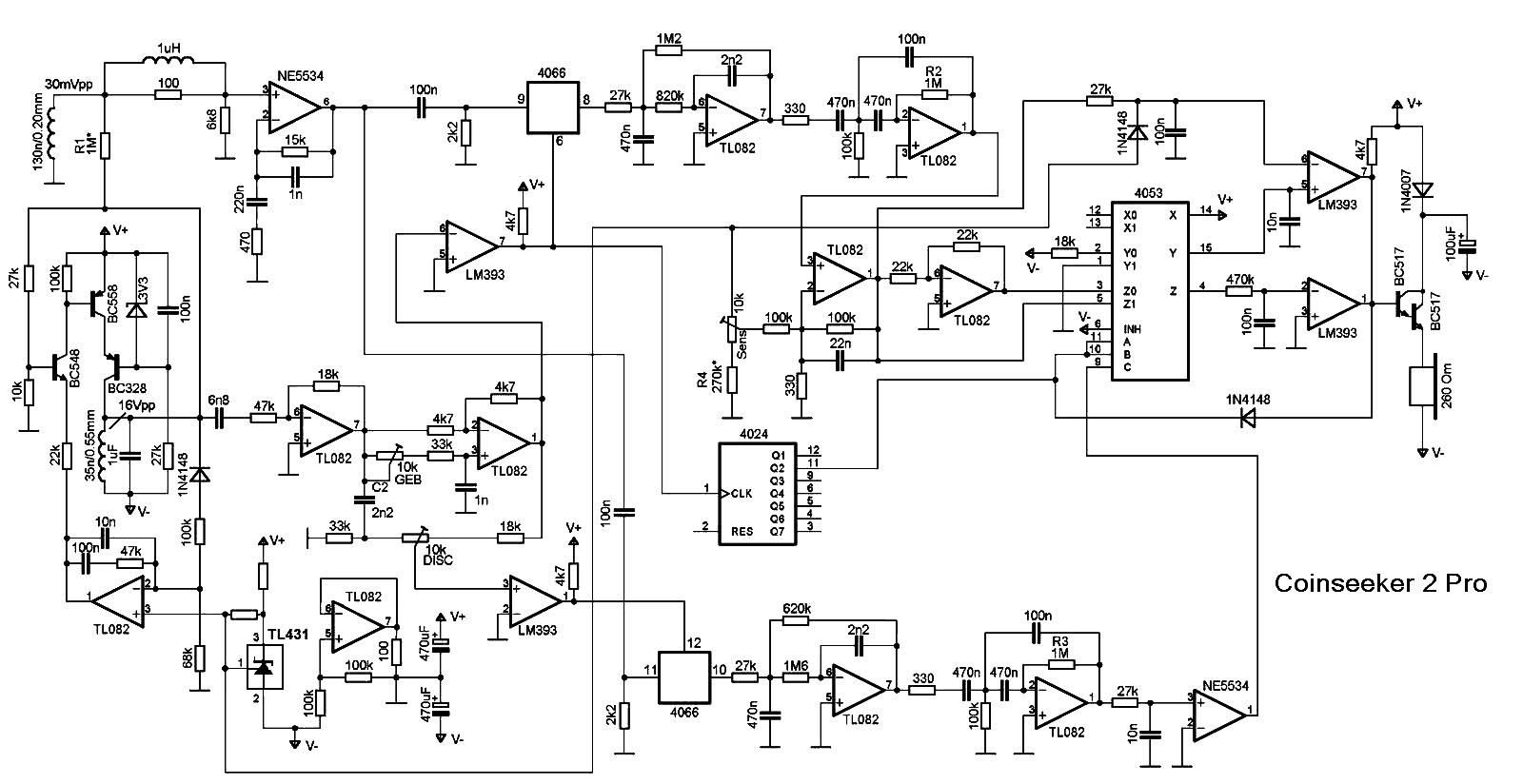

    hello to all the forum, I'm Italian, I need help to mount an electronic board of the coinseeker 2 Pro, the card already installed but I do not know where to connect the positive and the negative
    hi, what is Coinseeker 2 Pro you mean? white's electronics? fisher? garrett? can you give pics of your board from both sides?

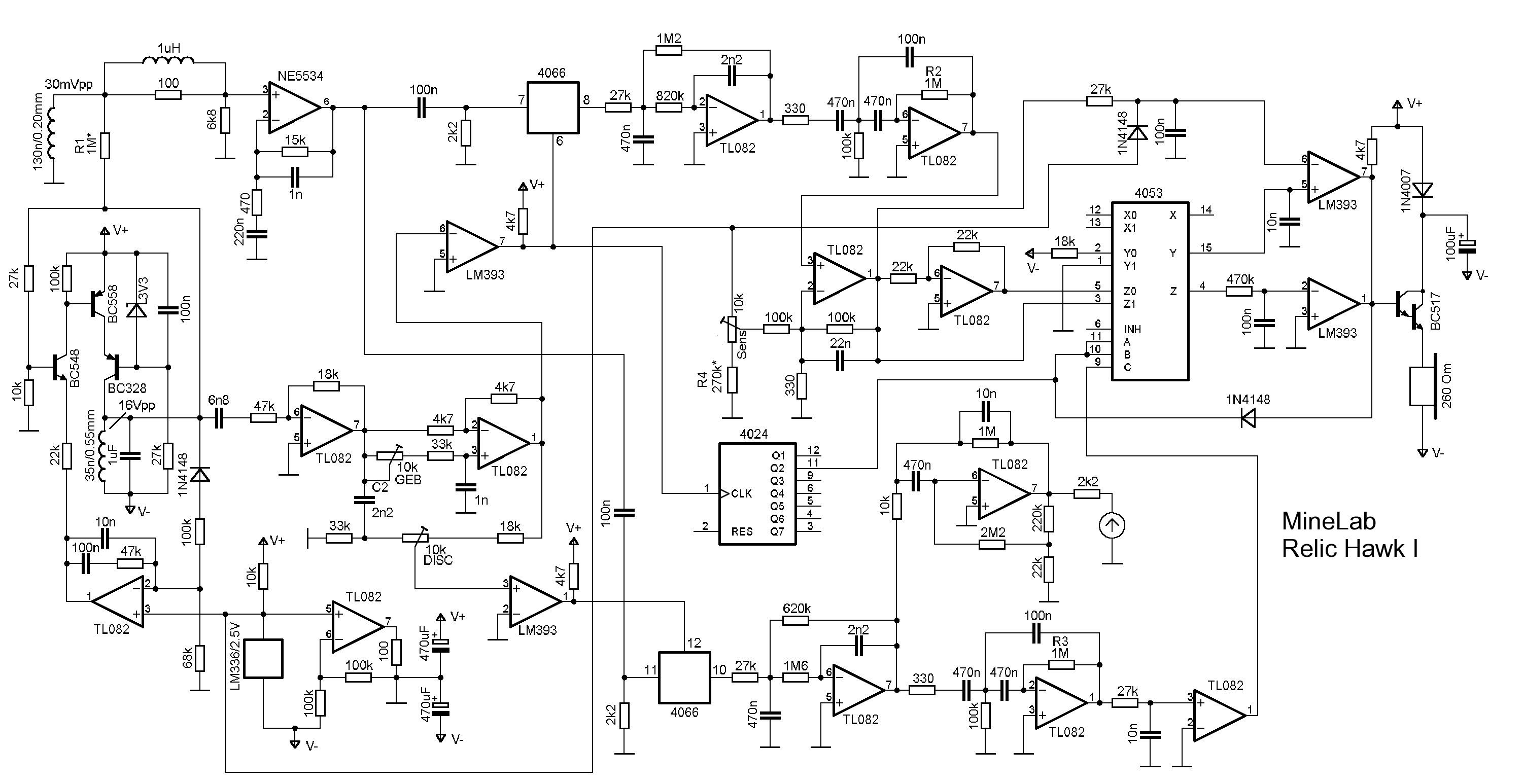

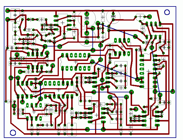

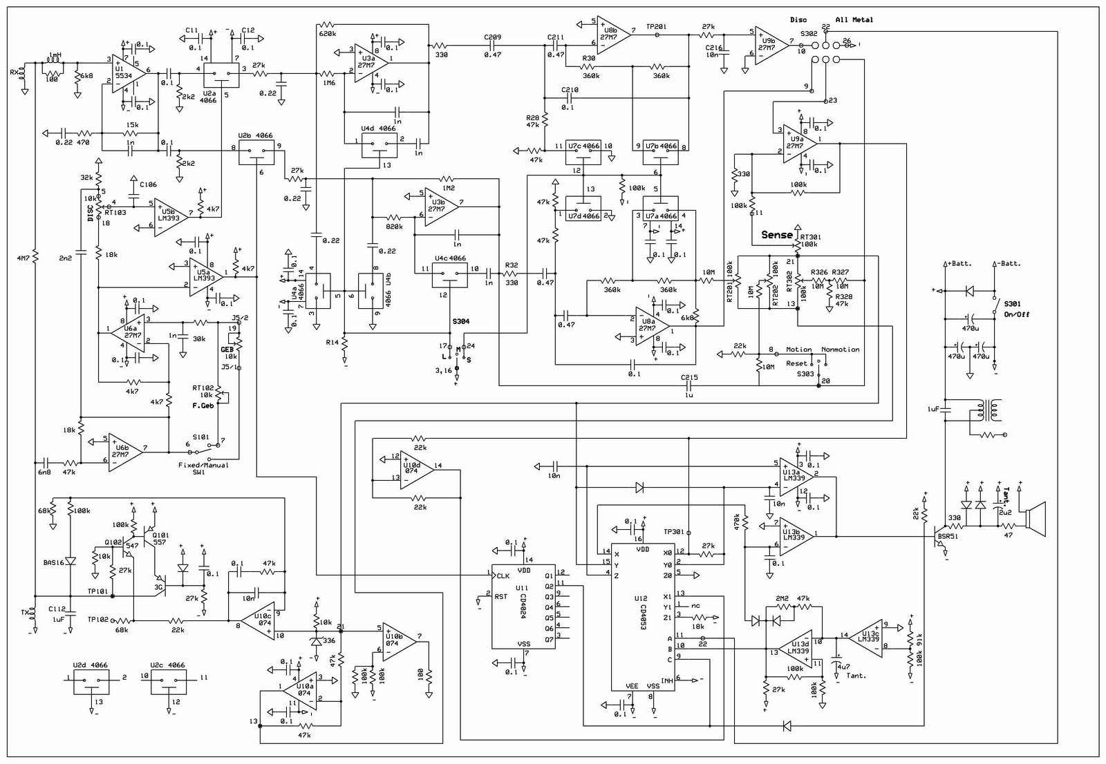

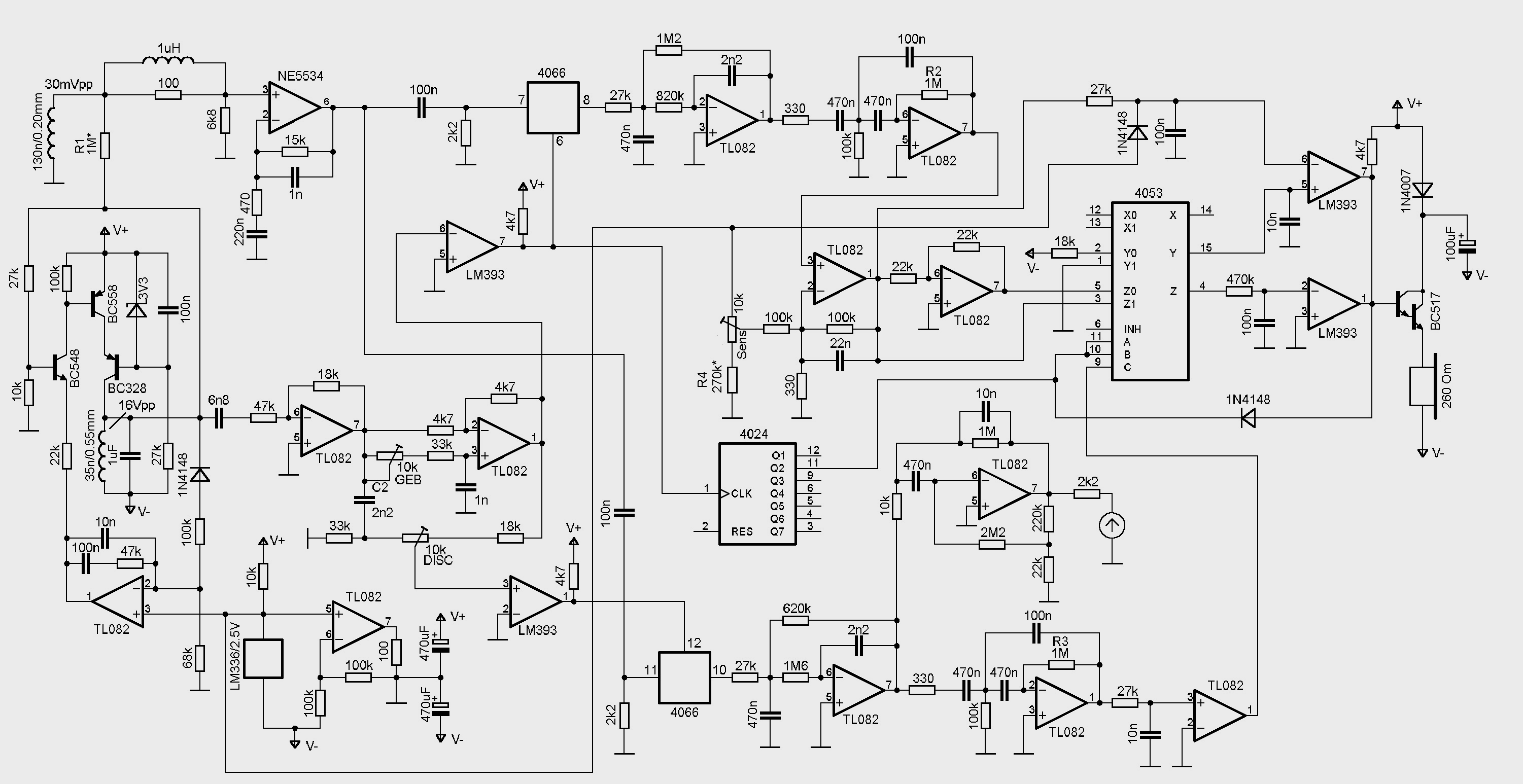

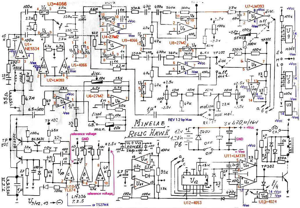

        it's a clone of Minelab's Relic Hawk...while I am not in this matter, did not follow it was actively debated in this forum... who made this clone I do not tell you now about, do not know. anybody from this forum.
ID:	336794Click image for larger version
ID:	336795Click image for larger version
ID:	336796Click image for larger version
ID:	336797Click image for larger version

            Hello everyone, you might have 1 photo of the pcb coninseeker 2 pro and parts list? tanks
              The schematic looks like the Relic Hawk...

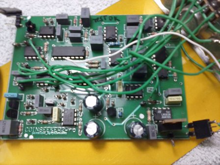

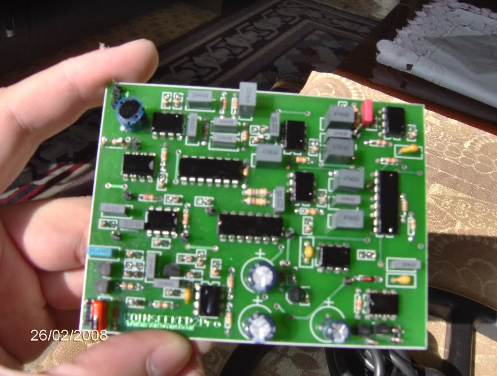

                      I bought the new kit, pcb with components already installed, but not working for me and I do not know why, I have the original plate, but nothing is wrong. best regards
                        roccocoin - What not work in your detector? Tray to find first 2,7volt aftrer 5v, 7v and start generator.
                        I made this project and work werry well. About coil I made dd28 Tx 48/0.6 Rx 170/0.2.
                        WHITCH COIL YOU MAKE FOR THIS DETECTOR. THE COIL IS THE SAME LIKE MINELAB RELIK HAWK.
                          thank you, lax pcb I c omprata already installed and I have the original coil made ​​in bulgaria, but it does not work I do not know why.

                            Primo:
                            Tu serve mejure :
                            1---2.5-2.7 voltage dopo lm336
                            2--- +5v and -7v
                            3--- mejure kuando colegato Coil - generator lavoro/no lavoro ..... dai fotografiko plata montaja

                              hello plboy these are the pictures of my pcb, but it does not work, emits only a little noise but nothing piu.tu can see if possible error?
                              coil bought already assembled so. tanksClick image for larger version
