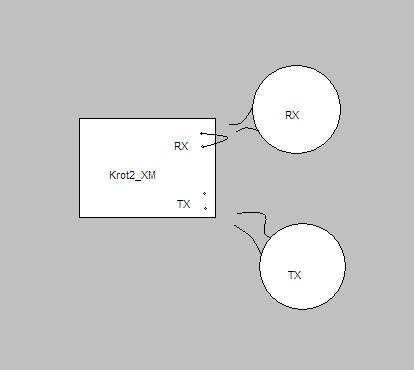

                        Also i ordered new ics to replace the other so to stop giving erratic signals.
                        Today i received the MCP601 so i replaced with a new one.
                        Erratic signals remains very strong and quickly .
                        So now i wait to receive the ATXMEGA32 and the programmer so to replace and it....
                        What other i can do????
                        Maybe the hammer?????
                        • If you remove the power TX to zero, there is a hindrance?
                          • Originally posted by smity View Post
                            I have the erratic signals even if i remove the D1 (34119) and coil..
                            Everything i do..... the erratic signals remains.
                            • I want to attach here a video (MP4, 2.94MB) so to see what is happening but system don't allow me.
                              If Qiaozhi read this thread please lets make an answer if i may send the file to him, so to attach it here.
                                This is correct method for "Zero Adc" ?
