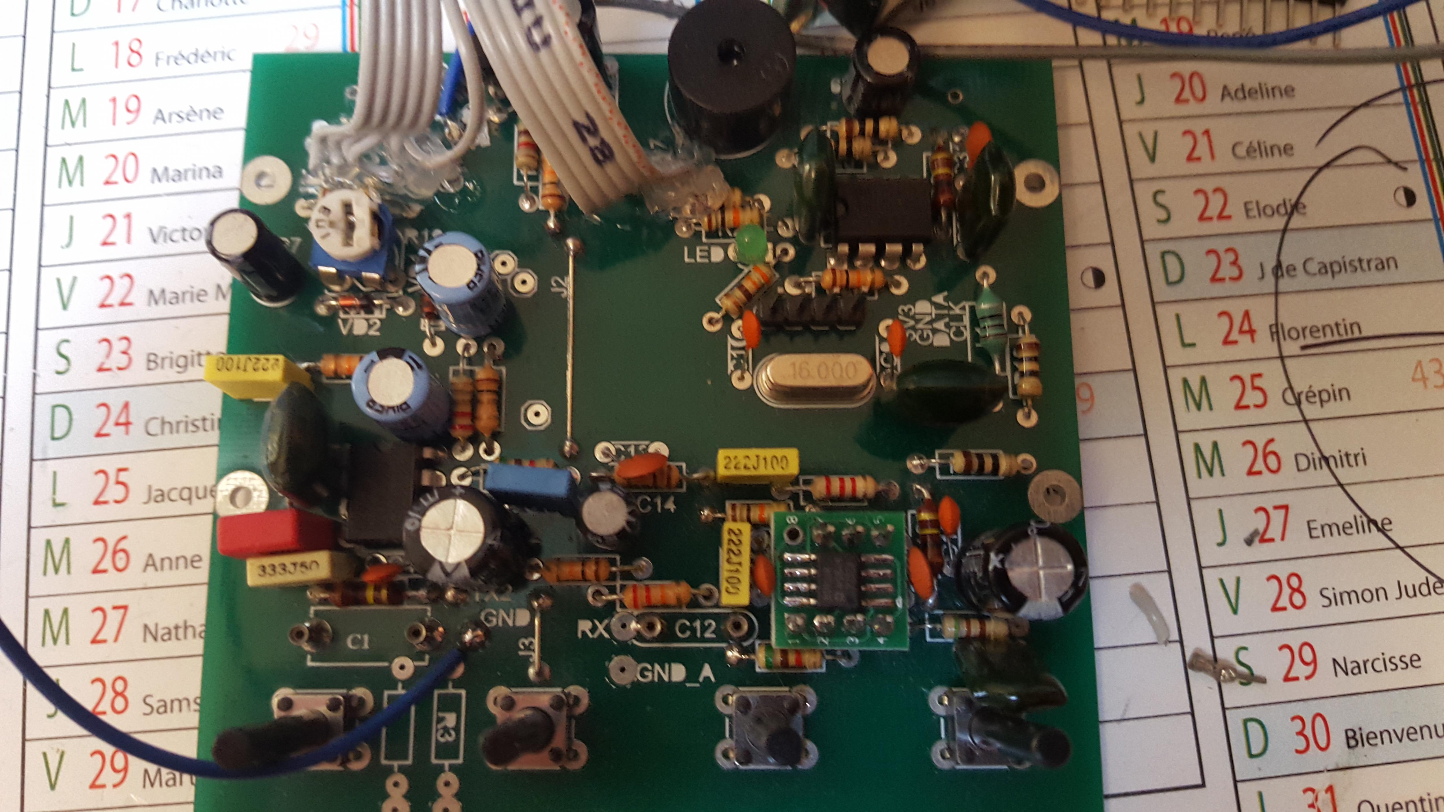

      Take a picture of the good quality of its printed circuit board.
      • Hi Smitty Ive verified the resistors and capacitors and they are what you say. Capacitor is electrolytic Are there any more things i can try ???

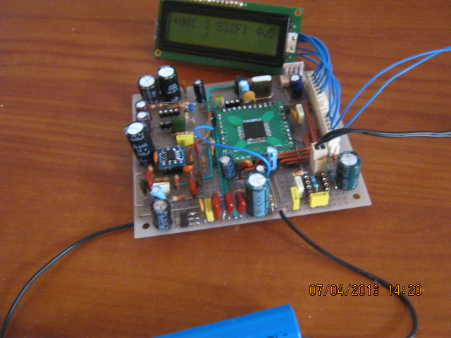

            I'm on 200mv without coil. ... could i see some good HD photos of your boards ?? I'll get some up of mine tomorrow
            • Of course, but my PCB is breadboard prototype .

              • Nice. Is that a 8091ar smd ?
                  • No 8091, MCP633 I think it is best choice.

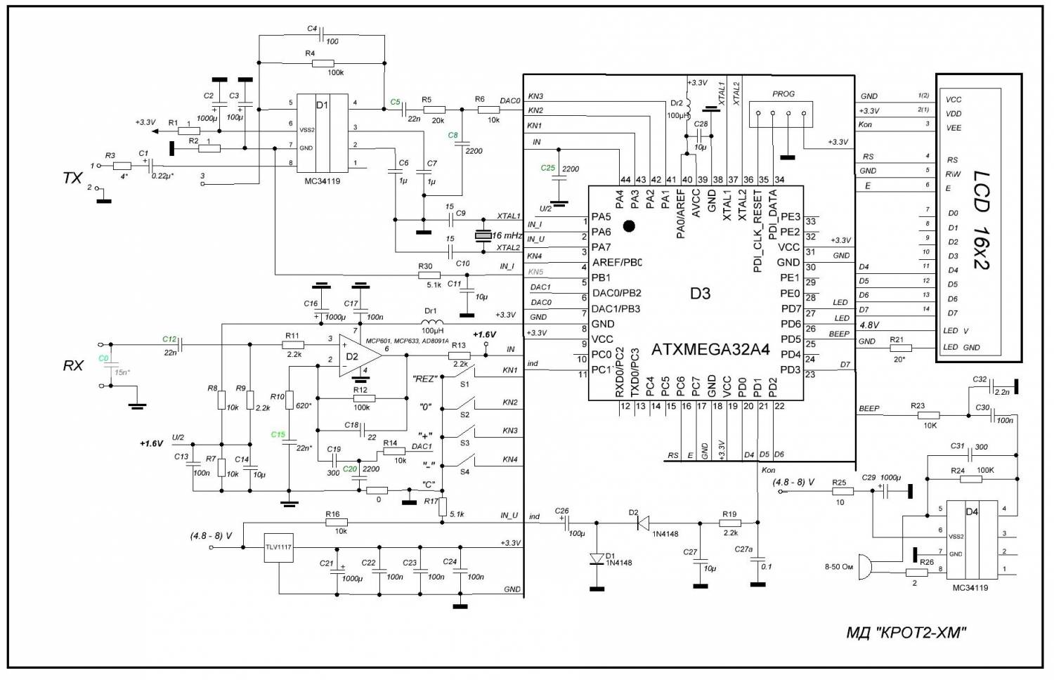

                      • In normal Mole 2 C18 - 22 pf , only in 3 frequency version C18 - 50 pf . Especially important C20 , C25 , C8 to be quality . R8 R7 is only volt divider , It is essential that there be a 1/2 of 3.3 v . R10 corect gain OA , It has a value of 600 om to 1.2 kom . For me 820 . The author recomend MCP633 and hi not use R11 .
                        • Tried your method and my rx returns to 326mv. If I remove r11 it shoots to 4236mv ?!.
                          • This is not my method, it is 1:1 with the original scheme of mole2xm. My change in the scheme only the replacement of capacitors with polar electrolytic . Of course that these may be replaced.

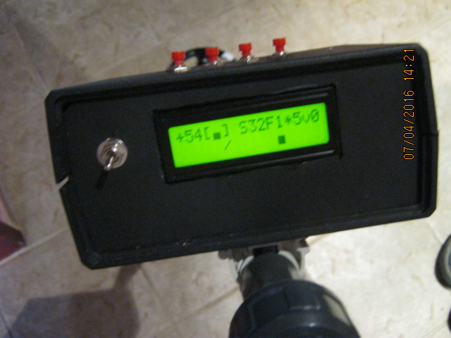

                            • Hi Everyone,
                              All is done now and i would like to know how to tune the whole detector.
                              I've finished the coil and plug it into my unit.
                              There are many tuning menus and i don't know how to start.
                              I don't want to fill my coil with epoxy before getting it working good.
                              i can see many tuning features :
                              TX frequency, coil balance, ferite, gain, etc ...and also the "mechanical coil balancing".
                              I have a 60MHZ oscilloscope.
