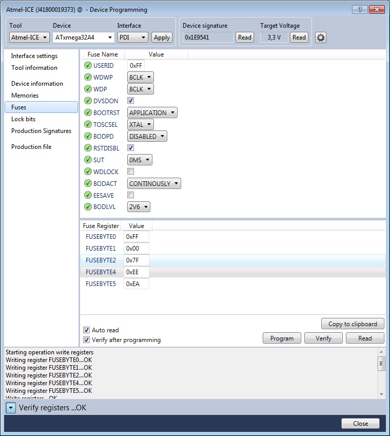

    • Hi,
      I'm looking for a fuses programming specialist ...

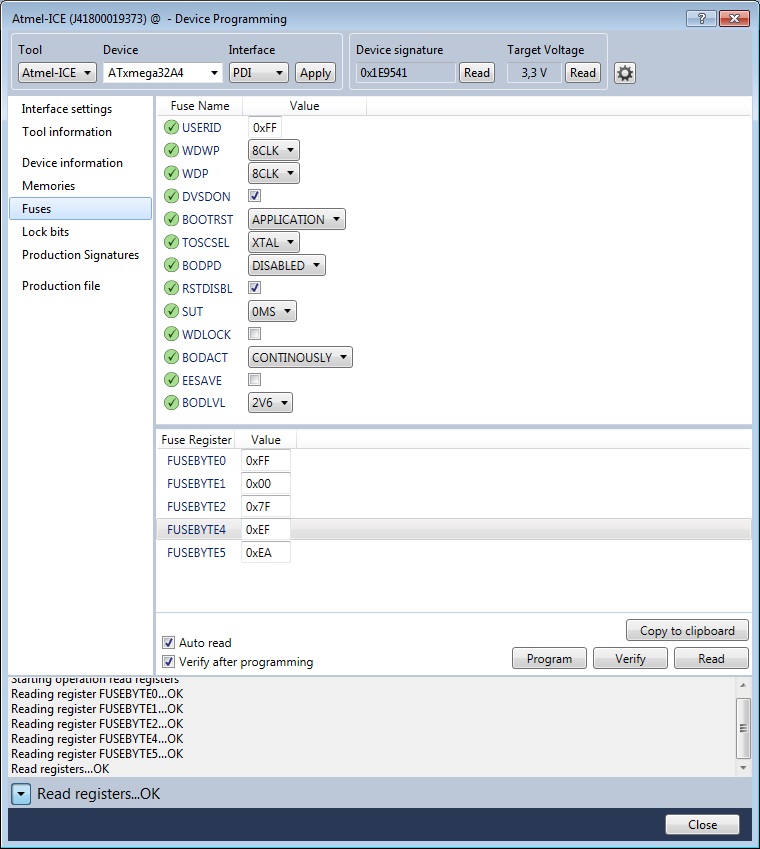

      I'm trying to burn few chips with the good fuses, the write operation seems to be ok but when i read fuses after burning,
      i get the wrong value for FUSEBYTE4 (I read 0xEF instead of 0xEE).
      I'm using atmel studio with ATMEL ICE programmer. The chip is a ATXMEGA32A4.
Name:	Sans titre.jpg
Name:	Sans titre2.jpg
      The required fuses configuration is there :
      Your help would be great !! THANKS

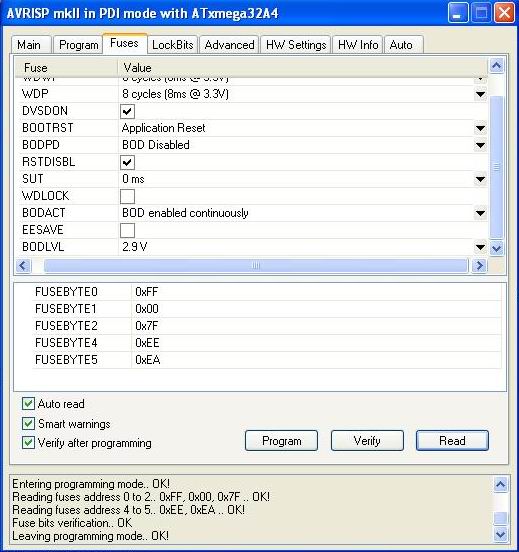

      • No need extra fuses configuration . I use avrstudio 4 /AVR Studio 4.19 and up/ and avrisp MKII . Mole in programing mode power from USB , reset and everything works .

          Ok, thanks but at the bottom of the author's page, there is a screen copy of the fuses with FUSE0=0xFF, FUSE1=0x00, FUSE2= 0x7F, FUSE4=0xEE and FUSE5=0xEA

          • My MCU is ATXMEGA32A4-AU . Screen copy of the fuses shows ATXMEGA32A4 , they are different MCU
            • My unit works good. There was a bad soldering joint on the MCU ...
              I'm getting lost with all those differents MCUs and fuses ...
