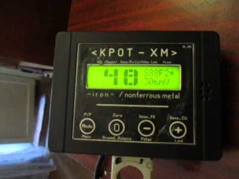

  • Thanks WM6 for explaining and this value 50-80 is in mV displaying in menu ··gain··? Or this mean how many times signal from coil is amplify at outpup opamp?
    Geo I belive that Dr1 is to filtering noises between analog and digital ground, if yes bigger value means only more filtration.
    • Originally posted by reiv View Post
      KY = KU = koeficient usiljenja = coefficient of amplification (A) = ratio of the output amplifier to the input of those amplifier = gain.
      It is ratio and is given in (integer) numbers, but can be calculated out of input-output data given in mV.
      On display you have:
      At Bottom of display:
      on left: RX tank circuit balance Voltage in mV
      on right: RX Amplification (Gain) in (integer) numbers
