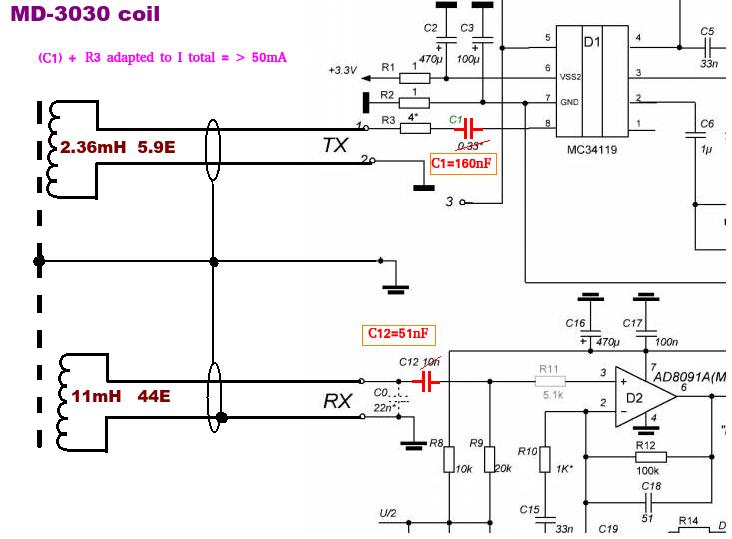

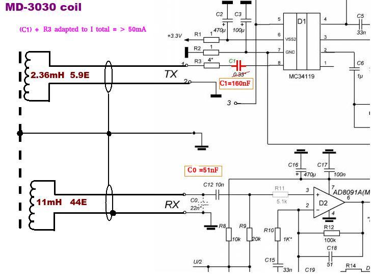

    I will try this MD-3030 CC coil, cause it is right now available for me here. As I understand author, KROT is very adaptable regarding coils.
    Results will not be taken as final judge how detector perform. My intention is to build proper one coil too.
    I have all needed for coil building according author (Andrei) data, but this will take some more time.
    Here MD-3030 coil data, if you wish to give some additional comments here:
    MD-3030 working frequency = 5.9kHz
    Coil diameter 10", CC type.
    TX coil
    L=2.36mH
    Q=25
    R=5.9E
    Z=148E
    Ctx=160nF (parallel with TX coil)
    RX coil
    L=11mH
    Q=16
    R=44E
    Z=693E
    Crx=51nF (parallel with RX coil)

        Agreed, that coil balancing coil be problem, but I am not willing to open this coil, rather build new one.
        Coil cable is not a great type, presumably they use microphone cable.
        Please take a look at this MD-3030 coil adaptation shematic and comment if it is basically correct:

        Values calculated to work at about 8.2kHz

        • RX is paralel resonant, keep C12, connect 51nF as C0, otherwise looks reasonable, at least for first test, offset TX\RX freq. by some 20%, but not less than 10%, monitor coil imbalance signal
          • Originally posted by Tepco View Post
            Thanks Tepco.
            TX/RX resonances are calculated (using standard value of C) at about 8.2kHz/6.72kHz. Mean offset of about 18%.
            If we use in TX 180nF and in RX 56nF we get frequencies of about 7.72kHz/6.4kHz and offset of about 17%.
            Which offset would you prefer?
            • About right,any version, also TX is differential, bridge type, output to coil can be connected between pin 5 and 8 for increased TX drive
                I was thinking that point 3 (pin 5) is there a test point?
                Corrected MD-3030 coil connection sheme:

                      Measure inductances of those coil and recalculate C. Problem is that TX here is serial resonance. RX, according author will work even without parallel Co (so untuned to resonance). If TX and RX tank circuit are tuned to resonance, then RX resonance should be set about 1.5kHz lower than TX resonance. Best working (TX) frequency from 7kHz to 9kHz.
                      You can try to adapt your coil to KROT2 using autotune procedure, as author show on this video (if fail then coil should be better adapted by changing tank capacitors in first line):
