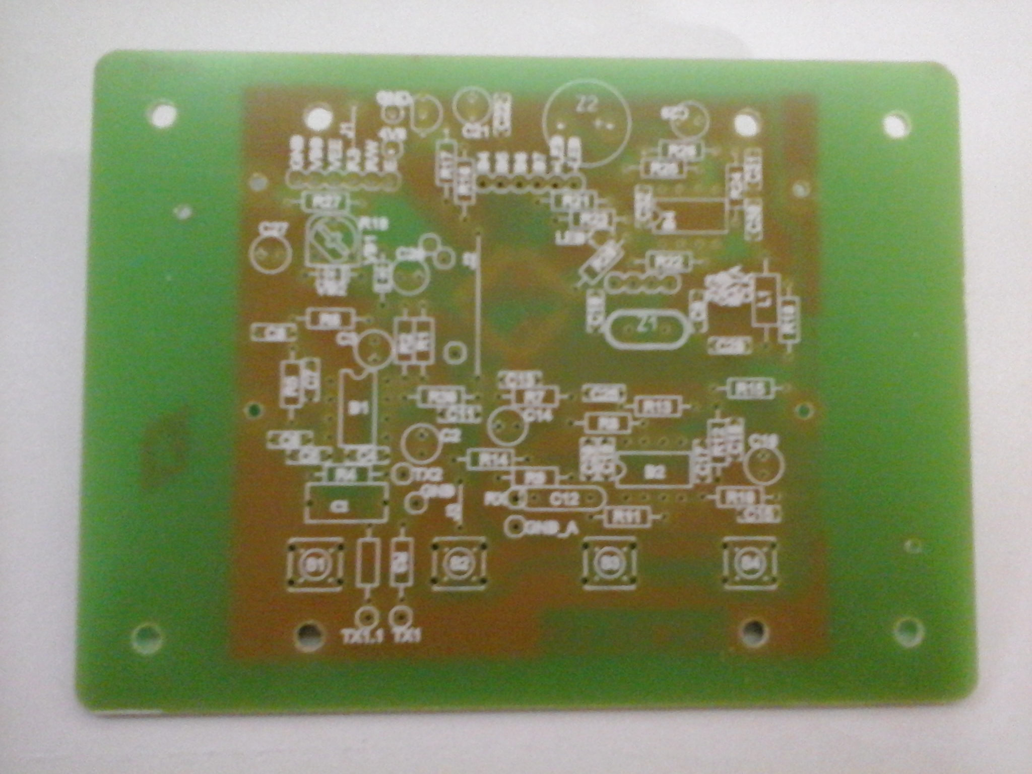

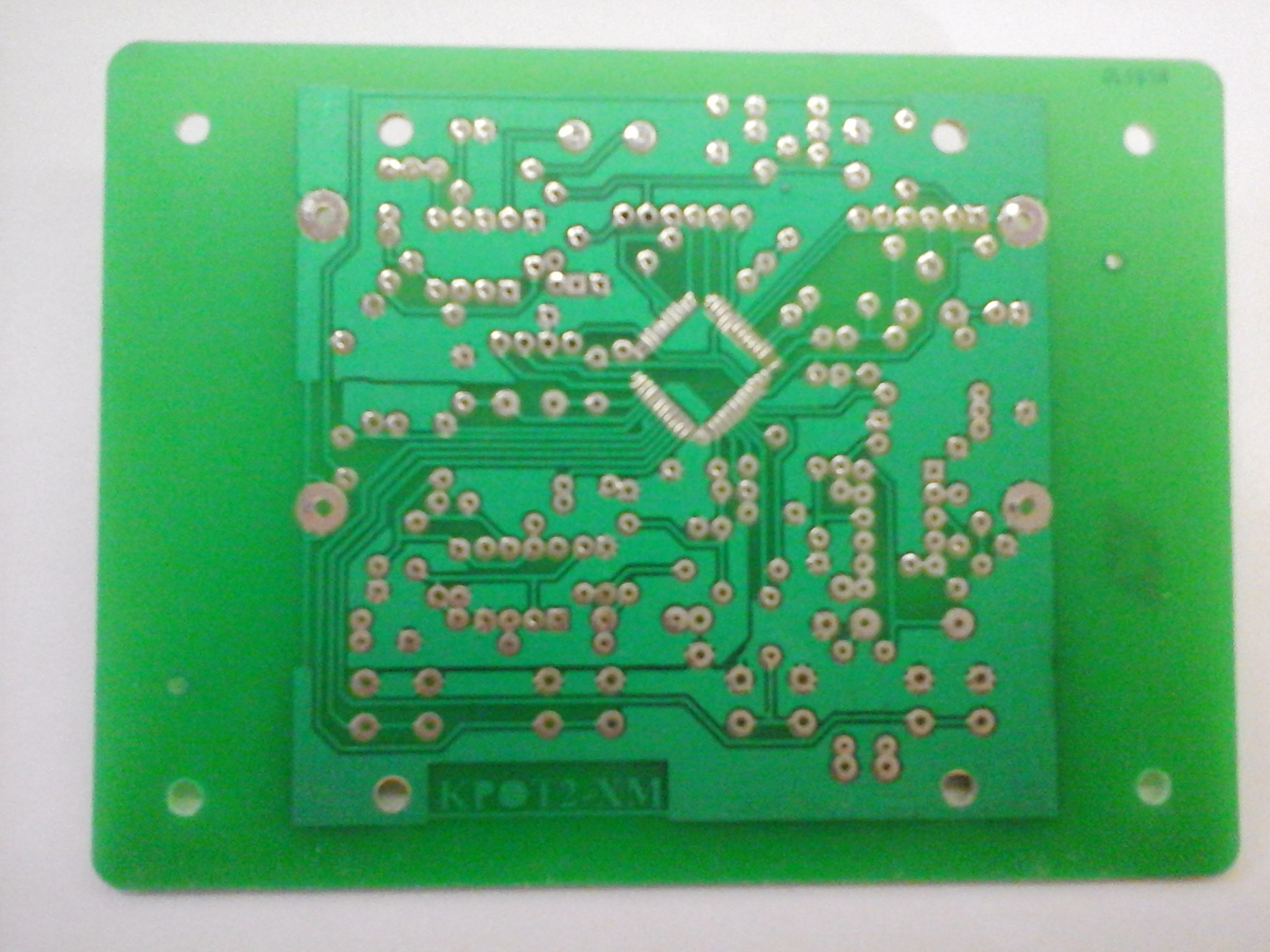

'KROT2-XM' (mole), new project Xmega32
  • [ATTACH] 30083 [/ ATTACH] 30084 [/ ATTACH] Is it true that PCB?

            Does any error in this pcb?

              Thank you SimonS, at this moment new PCB is over my need, I still have two unpopulated PCB's from Geo (waiting for ...). I asked just for general info.
              @dekoratör: As I can see your pcb is ok. Wish you full success with this project.

                • I believe that pcb for KPOT2 must be 2 sides with one side to use for shield.
                  Maybe if there is not the shielding side it makes KPOT unstable. This is the problem that i has with my homemade KPOT. I bought one full unit from Andrew and it works fine.
                  • It`s not true, I have one side PCB and my Kpot is totally stable
                    • Mine is stable too, on single sided DIP board. With shielded coil (graphite) and proper cable ( some audio stage\studio wire of unknown origin) not a single false beep outdoor at highest sensitivity, even indoor is relatively quiet in noisy apartment flat. Recently I updated newest K3 V12 software to play with multifrequency and different coils, everything works fine.
                      • So.. it is time to play again with my homemade KPOT. I have an original coil from Andrew so i can try it to see where is the problem.
