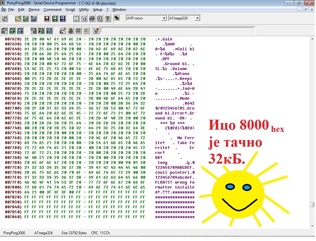

  • I must admit that i am bit confused about this.
    ATxmega32A4 (from authors schematic on site) is having 32+4kB flash.
    Latest K3 HEX files are all above 70-80kB size.
    How about that?
    It is possible to flash those HEX files only in ATxmega128A4 chips.
    Or i am missing something here?
      How about that?

        But i want first to clear up about those large HEX files, they can't fit into 32 chip version.
        Unless author figured out some special trick?

            Ицо - program is exactly 32kB size long in hex - all others are FF(hex) or empty space for disassember. This is due to AVR studio or similar development saved complete reserved buffer in one hex.
            If you reserve more buffer space than 32kB you can see how program sequence is repeating. For example you can open buffer 1Mb and it will be filled till the end with repetitions of loaded segment 32kB.
            By the way KROT thread on Andrew site has 320 pages and many people were successfuly programmed their 1.8V-3.3V ATXMEGA32A4-AU. AU is automoto processor with industrial temperature range - so it can run under - Zero temoperatures.

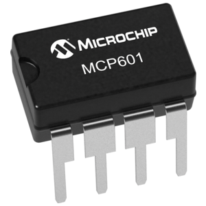

                  • 2nd MCP601 Front-End Receiver
                    MCP601 rail-to-rail operational amplifier (op amp) has a gain bandwidth product of 2.8 MHz with low typical operating current of 230 uA and an offset voltage that is less than 2 mV. The MCP601 uses Microchip's advanced CMOS technology, which provides low bias current, high-speed operation, high open-loop gain, and rail-to-rail output swing. The MCP601 operates with a single supply voltage that can be as low as 2.7V, while drawing less than 325 of quiescent current. The MCP601 is available in standard 8-lead PDIP, SOIC, TSSOP and 5-lead SOT-23A packages. This amplifier is ideal for industrial process control, low-power battery-operated devices, portable equipment, data acquisition equipment, test equipment and low-end audio applications.

                    • How to boost KROT (MOLE) targets recovery speed ?
                      Lets see what recovery speed is on example of Makro Racer 2.
                      Ok what is wrong with MCP 601 ?
                      1st. Very slow Slew Rate 2.3V//µs or in prospecting term slow target response. This simple means that small signals from target in the soil will be very probably dispersed in the highly mineralised soil before front end receiver will even handle them.
                      2nd. Very miserable Gain Bandwidth Product of only 2.8MHz. In prospecting term this means that for very short in time and small signals from targets we will have very small gain of Front End receiver because as signal is shorter for given open loop gain amplifying is smaller. It further means poor detection depth. These are MCP 601 engineers design restrictions.
                      To solve problem we need Rail-to-Rail OP with extremelly high both Slew Rate and Gain Bandwidth Product. Proble is easy solvable and depend only from money. There are many excellent high speed rail-to-rail operational amplifiers on market.

                        • Ico resicemo i to. Stace sve u 32kB. Taj program je za KROT-3 (MOLE-3).

                          Ivica size of hex program will solve. That hex code is for KROT-3 (MOLE-3) detector.

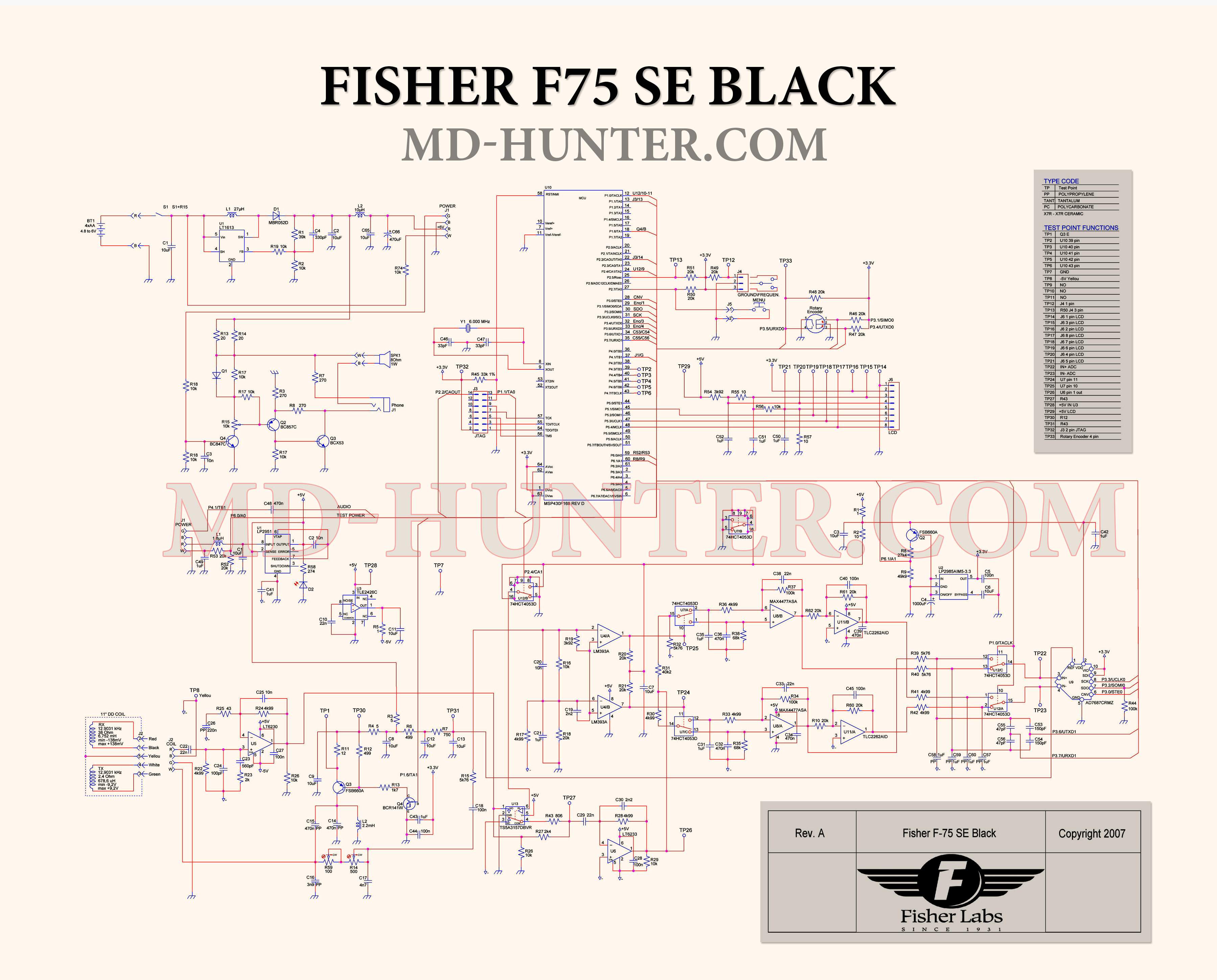

                          • Ok GOLD prospectors now lets see how Fisher has solved problem with Front End Receiver in F-75
                            F-75 schematics - click to zoom !!
                            What is in ?
                            Linear Technology LT6230 - excellent Front End Receiver.
                            Make difference to MCP 601:
                            Gain Bandwidth Product = 215MHz . !
                            Slew Rate = 70 V/µs . !
                            And for only 7 bucks . !
                            Product Attributes Select All
                            Linear Technology
                            Tape & Reel (TR)
                            Active
                            General Purpose
                            1
                            Rail-to-Rail
                            70 V/µs
                            215MHz
                            5µA
                            100µV
                            3.3mA
                            30mA
                            3 V ~ 12.6 V, ±1.5 V ~ 6.3 V
                            0°C ~ 70°C
                            Surface Mount
                            SOT-23-6 Thin, TSOT-23-6
                            TSOT-23-6
                            Factory info:
                            http://www.linear.com/product/LT6230
                            http://cds.linear.com/docs/en/datasheet/623012fc.pdf
                            http://cds.linear.com/docs/en/applic...te/an148fa.pdf
