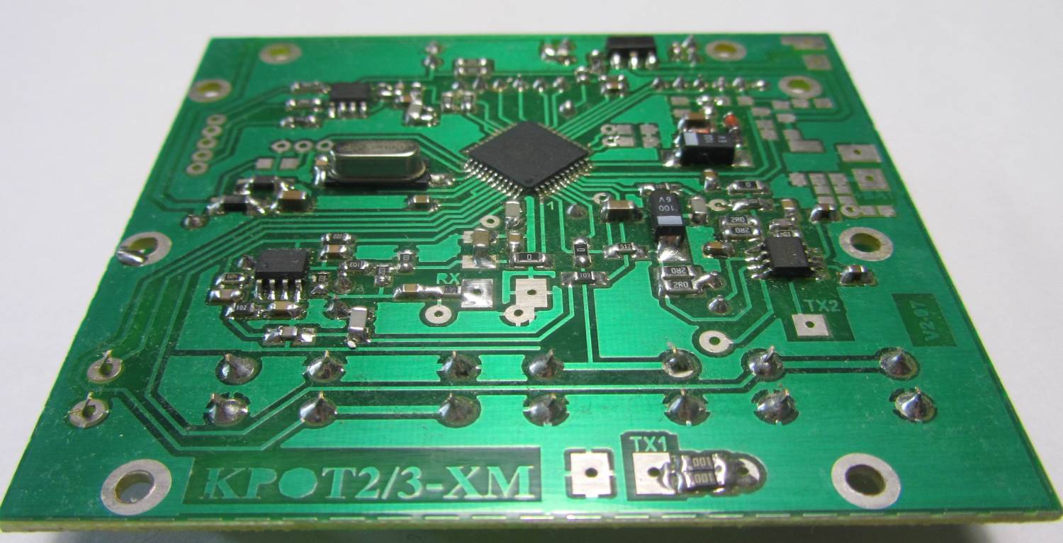

      • New builder
        I hope this thread not dead yet
        Im already made one of mr.fred (blobber) mod pcb:
        And made avrisp mkII by krot author, i think its work:
        Im not use lcd and not make the coil yet, but when i put 5v battery its make a sound and when i short the button its make a tick sound.
        By reading bernte_one post i can use cheap 1602 lcd hd44780 with 5v voltage supply, i'm right?
        Im not sure about 2n2 NP0 caps that must use, i use multilayers caps for now, cant find 2n2 NP0 anywhere
        • Adjust the trimmer R19, here you make the contrast setup. If nothing happens, replace R27 with a trimmer and try again.
