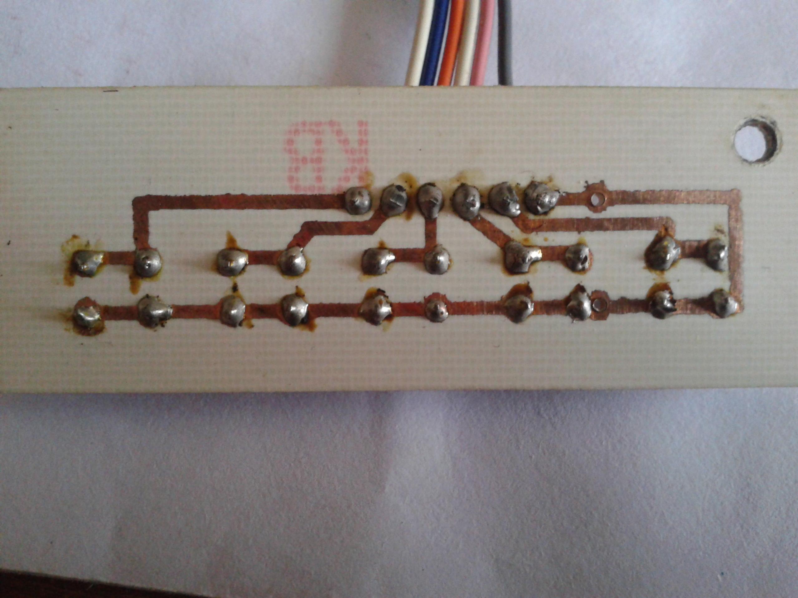

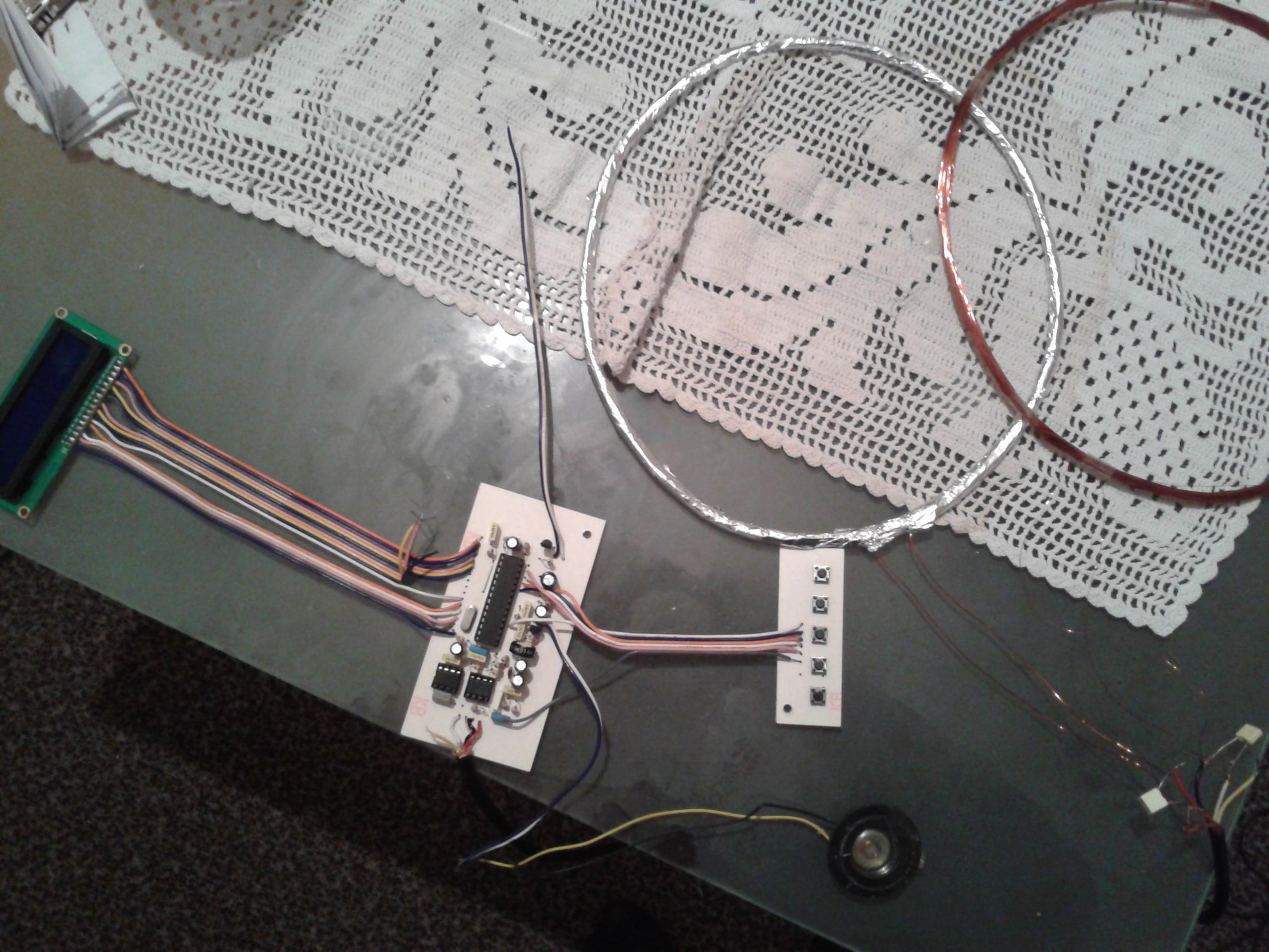

i made the detector (modified version by Tepco) 3rd post in this topic

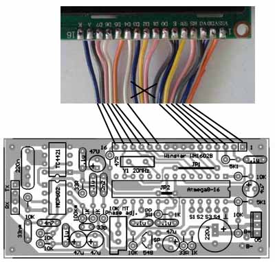

The coils are not finished yet , i made TX ~ 45 turns of wire 0.4-0.5mm c1 = 0.3 microfarads //RX ~ 200 turns of wire 0.15-0.22 mm C0 = 0.022 microfarads... just to shealld properly

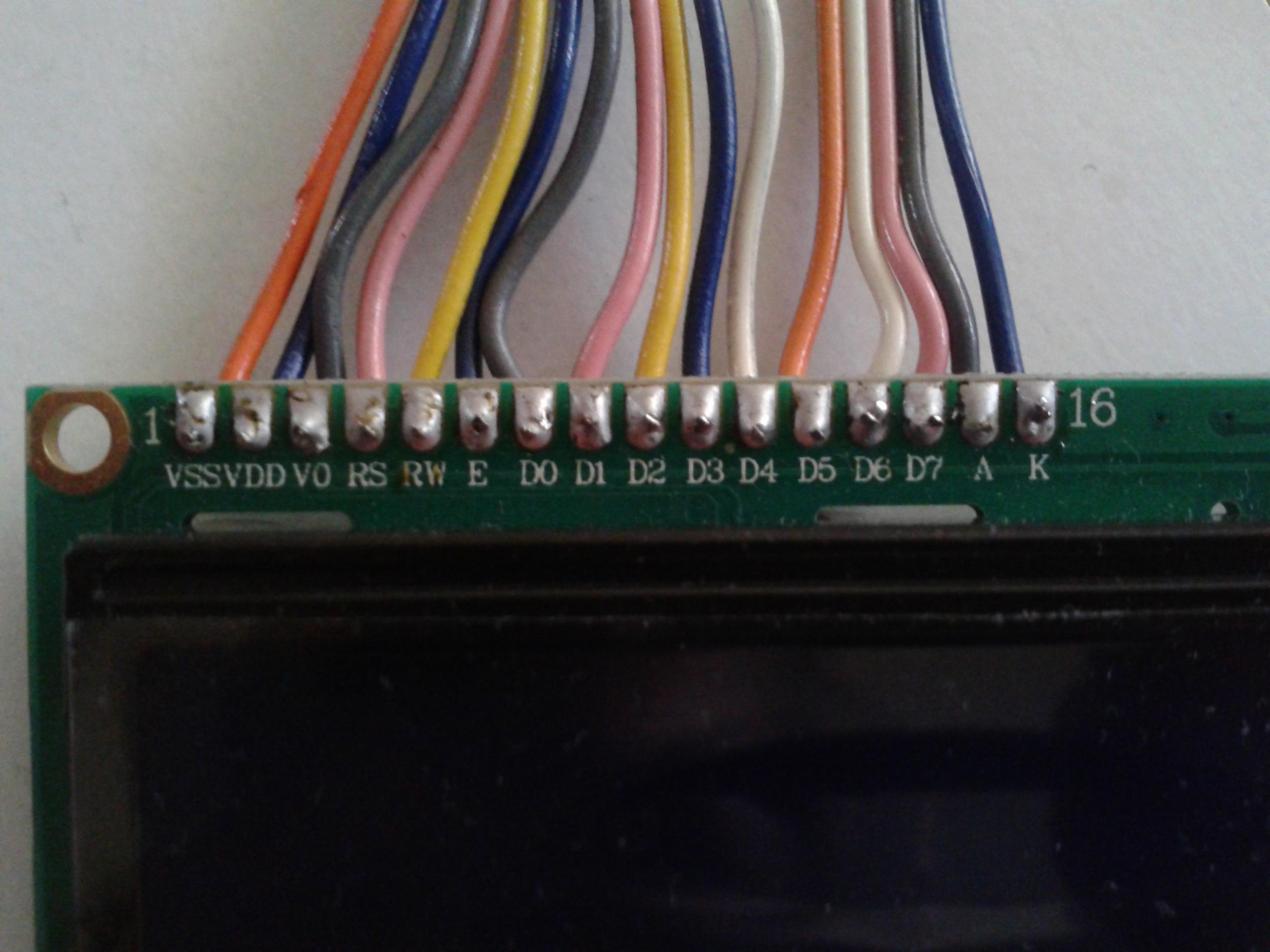

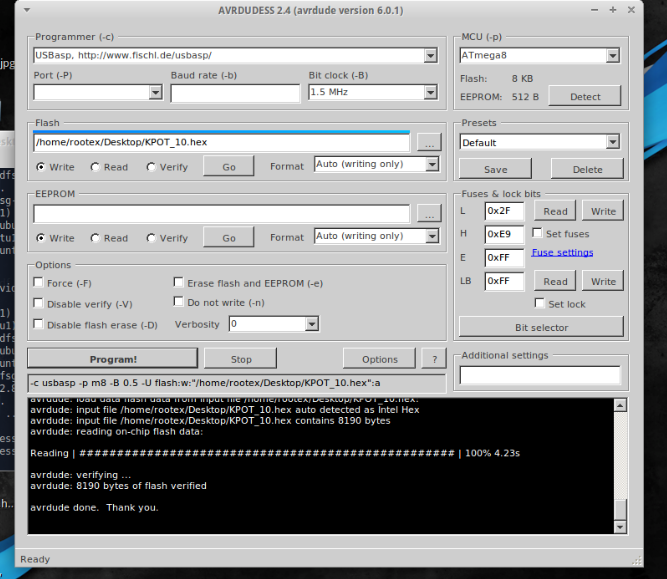

The problem is: when i connect the power source , after 20-30sec the LCD screen start to light but nothing on it to read just blue screen light...And on the speaker constant beep sound (like vibration from telephone) I try to reprogram the Atmega8 chip few times the problem continues... All parts are like on the modified project by Tepco,instead of IC - MCP602 i use (MCP6021) so is possible that it is the problem, so is there any replacement for this IC??? Any suggestions help ??? thanks friends
