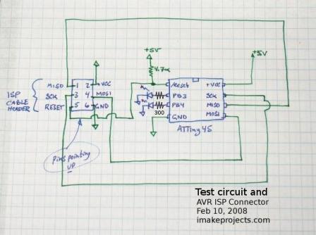

      AT FIRST I am a novice in this field...
      I've supplier of software assembly of company ATMEL And name it IS ( AVRISP MKLL .... & STUDIO 6.1)
      the programming language is ( C )...
      and microcontrollers ( ATTINY 45 )...
      So I started BEGINNING new project and then declare their GCC C EXECUTEBCE PROJECT C/C++ , AFTER I MADE DEVICE FAMILY and declared the ( ATTINY 45 )....
      I finally appeared EDITOR and I wrote this little program FIGURE 1..
      unfortunately until here, I know not what DO I DO Below ...
      From here we need your help..
      Thanks in advance g.s..
        You are using Progammer MKII? Recognizes AVR Studio the MKII? Detects the AVR Studio the ATtiny45 when connect the circuit? First you have to be sure that your programmer with the software works. Can read the chip-....

            Important: The correct installation of the USB driver on your computer. Nothing else is possible.
            I seem to remember that you must also set in the AVR Studio first the target programmer (MK II) and then the right chip - in your case the ATtiny45 ....

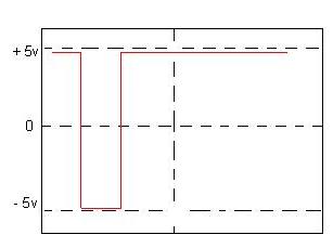

                          All the microcontrollers have been POWER +5 and gnd ,Well , When I want to created a length square pulses where to starts -5 volt until +5 volt How can they do that ??
                          Think it can be done with a similar power to the happens with driving with a transistor ??
                          and the through planning ??.
                          If you know and can you tell me about this ...
                            Microcontrollers are a good thing because you can save a lot of components. If I understand your question correctly, then you can not generate negative voltages (-5V) with a microcontroller. You can setting pins of an MC for example to "HIGH" or "LOW" (0V or ca.+5V). Transistors for switching larger loads are meaningful (or relays).
                            For output voltages of graded you will need a digital-to-analog converter. Which can be easily set up with a resistor network .....

                              I mean one shown in FIGURE
Name:	pic to pic.JPG
