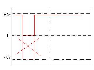

    The rectangular curve is not under 0V. (With only microcontroller) See picture:
Name:	pic to pic.JPG
    To generate +5 V/-5V rectangular curve you need any other additional components.
    The question is: What do you want to build a circuit?

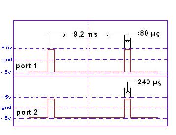

      Hello! Dixix YOUR I show splurge .. Click image for larger version
Name:	g.s m project.JPG
      this is what I want to build..
      eee FORGOT is in 100 Ηz
        I also have a queries ..
        how Can You Grow TIME on (HIGH) without moving the price off (low) , namely riding to the price of (low)..

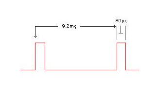

          Good evening dixix ..
          I created this program ..
          $regfile = "attiny45.dat"
          $crystal = 10000
          Config Portb = Output
          Const Ondelay = 8
          Const Offdelay = 919.2
          Do
          Portb.4 = 1
          Waitms Ondelay
          Portb.4 = 0
          Waitms Offdelay
          Loop
          End
          corresponds to the figure shows.. is correct year that I made ??
          the dot at what thy They show ( Const Offdelay = 919.2 ) ??
Name:	g.s p 1.JPG
ID:	338089Click image for larger version
          Thanks in advance
            I do not think this will work that way.
            You have only times you acquire a basic knowledge of AVRs. The best thing you build an experimental platform. And then little by little work ahead. Basic literacy skills. (ATTINY has only one port B)
            Please do not be mad at me, but I think you have too much you made ​​for the beginning.
            In your case you want to create two different pulses. Output on two different I/Os.
            The commanding DELAY is not the right way. with every DELAY you put the processor lame .
            I think its better to work with TIMER / ISR
            Timer runs independently from the actual program in the MC in the background.
            There are 8bit timer and 16bit timer.
            If a timer with a frequency of 1 MHz processor controlled.(8bit timer) Then the timer counts per second 1 million times more. A "tick" then takes 0.001 ms. Per timer overflow can then be trigger an interrupt which performs certain actions in a subroutine. and so on ....
            I do not know if ATTINY45 the 16bit timer has.
            First, you must the Data Sheet of the ATTINY45 read.
            Please search in the WEB for AVR programming tutorials. So you can lerning the basics.
            I am also just beginning to programming of AVRs.
            I can tell you in those specific questions not help ...
            Dirk
              Specifically meant, you need a signal in which the frequency remains constant. But the ratio of "ON" time to "off time" should be changed. To eimen certain percentage of the time is at a 5V level and in the remaining time 0V.
              Generated with PWM.
              So: If the frequency of the PWM signal is constant. BUT: The pulse-pause ratio is determined by compare-value.
              IMPORTANT: The signal is output to precisely defined pins of the microcontroller. (ATTINY45: PB1 and PB0)
              The pin is defined in the program as output. (CONFIG PINB.1=OUTPUT)
              Dirk
                Sorry my mistake. By hardware PWM you can use only one pin of ATTINY45 - PB1.
