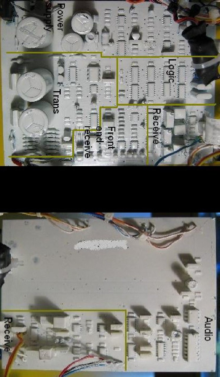

    The audio output of my 3500 does not work.
    perhaps, power (audio) cable may have inserted it incorrectly,
    Waiting for help from people experienced in this field.
    White coating on the PCB, the PCB can remove without causing any harm.
    Best Regards
    Adem Adem
    try to clear PCB by spirit. can you give pics inside or you mean only theoretical labour, labour of thought?

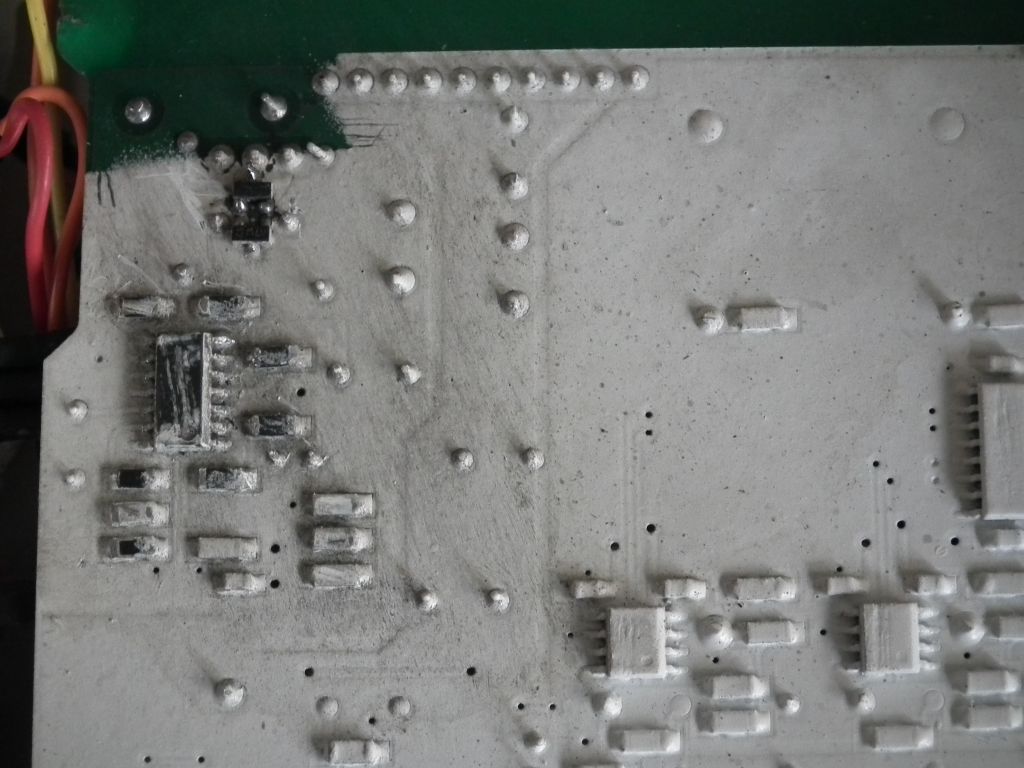

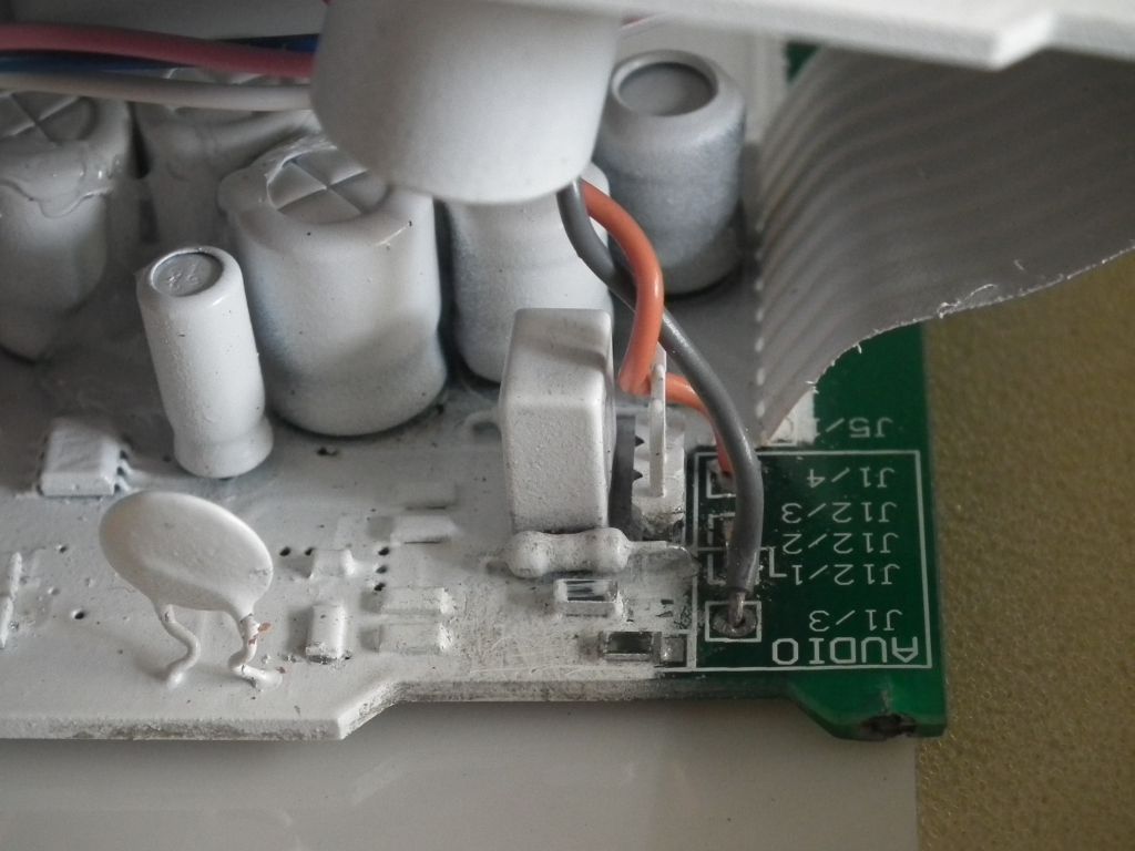

        I tried cleaning with alcohol and lacquer thinner,
        I checked the diode (2x A7W), no problem

            Hi Adem,
            There are many reaonswhy the audio may no work on a 3500. If the coil is not connected, the audio will appear not to work. Have you checked thepower/audio cable? Different headphones? Are yu trying t drive a speakerdirectly from the detector audio output? It will not drive a speaker without a booster.
            In my opinion, you are better off sending this to minelab and have them repair it than to attempt repairing it yourself. It will be money well spent. If you try and repair it yourself, you will
            Nail polish remover will not touch the paint used on he ML boards, it will just dissolve the plastic coating of the wires and melt the capacitor casings!

                  Hello, I do not think that minelab used a solvent paint thats would be risky for the parts.
                  You should think more of waterbased paint used. That is dificult to solve, remove.
                    What happens to the paint as warming up with a soldering iron?
                    Will it be soft?
                      Hi Nupi,
                      Hot air from a rework station softens the paint which can then be removed with a small flat screwdriver(without bent edges). However, the part numbers are all scratched off the ic's, so even once the paint removed, you are still flying blind. It takes a lot of experience to be able to reverse engineer any of the ML pi's and a hell of a lot of time. For a one off repair it is just not worth it, whats your time worth??? $1/hour???
                      Adem, You say the audio is not working, can you confirm that the coil is pulsing? Do you have a scope? If you don't have a scope, I STRONGLY suggest you re-assemble it and send it off for repair, even if you do have a scope, still send it in for repair, or I will give you $200 once you have finished with it....
                      There are no schematics for this machine publicly available. It is very different to the sd2000.
