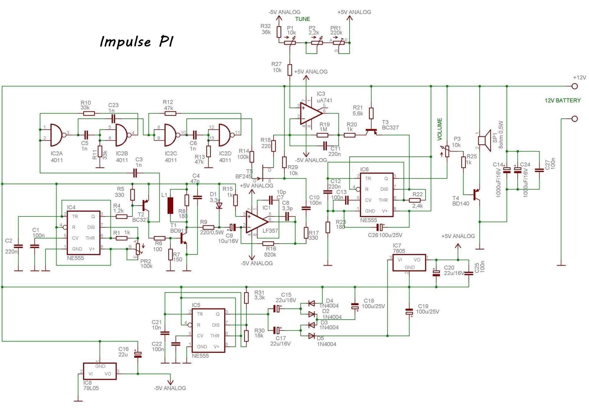

    Anyone know anything about this PI or has anyone built it? are there pcb files anywhere for it?

    I carnt remember the original name for that circuit but Silverdog used to sell the pcb.
      Component values are different but otherwise looks almost exactly same as the ProScan, for which there is a project page here.
        It was Lucus Lab or something like that.
          it was lucaslab, i did build one and had boards for a while
          it was ok but not great, had a horrible sound as well
          there are certainly better projects around
              I had a electronics magazine named "elrad" a few years ago. There was a complete instruction in it, so I build one. As far as I can remember this detector was passable in function. Could find iron objects very well, copper and gold wasn´t that well. The reaction commonly a bit lazy. I think that can be improved ?
