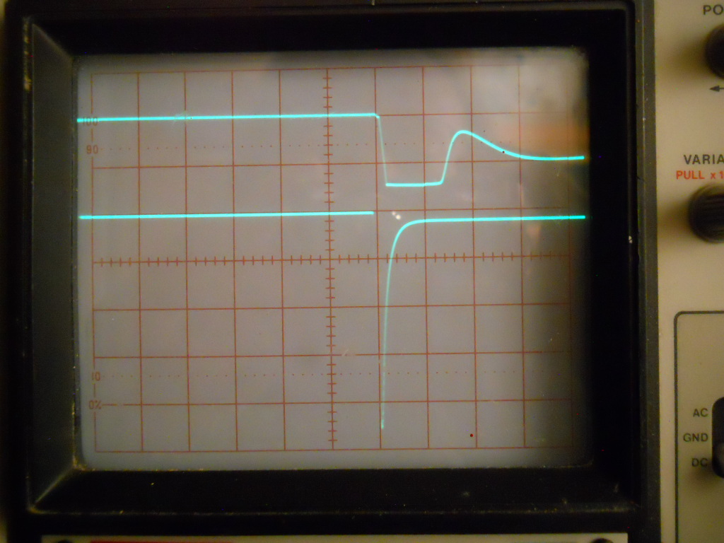

              Have you been able to scope your fly back yet? The reason I ask is Mine seems to be inverted??? Im wondering if this is specific to the kit or I messed Up!
              Mine spikes down at 250 volts. Must be inverted somehow. Seems to work fine though.

                      You can set you damping resistor from pin 6 of the 5534 and Ive been looking at the flyback on the input side of R6. Im not sure why it is inverted yet.
                      Scope is set at 5us, 5 volts top trace, 5vx10 bottom trace.

                        Looking at the scope image, I don't think the signal is inverted. I believe you've mistaken the overshoot as the inverted signal. The top trace (preamp output) starts off following the lower trace (TX) until the opamp rails out. Once it comes out of saturation, the signal again starts to follow the lower trace, but overshoots slightly due to being underdamped, and then settles at 0V. If the value of the damping resistor is reduced, you will see the overshoot decrease in amplitude, and the two signals will match (except for the point where the opamp is saturated).
