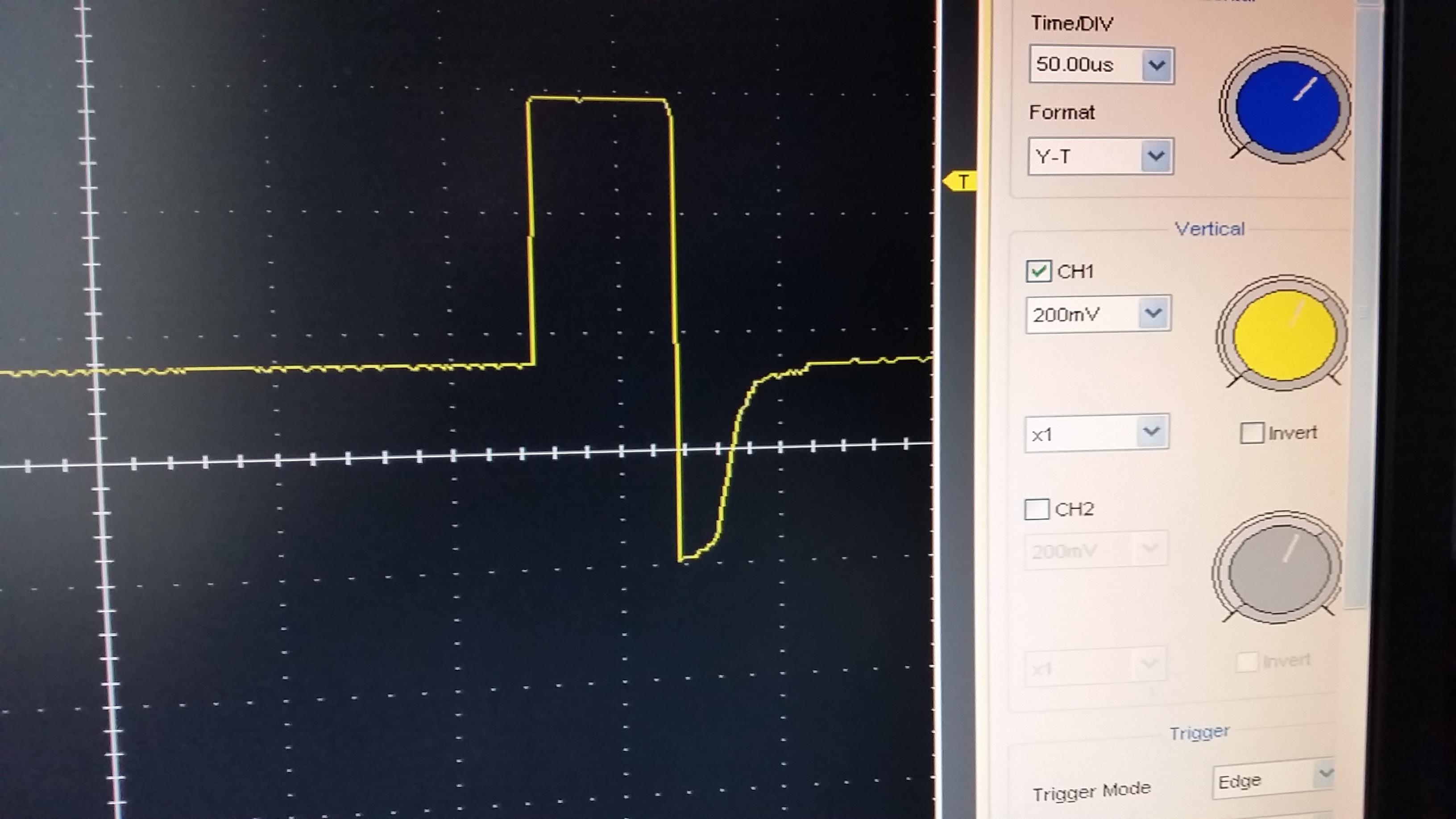

    If you want you can still adjust R6 without a scope. Its not perfect by any means but you adjust to best performance.
    Using a resistor setup like in post #10 of this thread> http://www.geotech1.com/forums/showt...mping+resistor
    That being said best performance for me is not perfect damping on the scope. Slightly underdamped as in the picture is where Im getting my best sens to small gold with the coil in scope picture.
    I also am having better luck with coils in the 300 uH range and thinner wire for this kit .
    I set up R6 on my board with D-sub connector pins for easy changing of the resistor and hook up of the adjustable set up.
    What is your voltage at the coil connector If you dont mind me asking? Mine is at 40MV for this coil. I have tested higher and get a tiny bit better depth but pick up too much noise and sens to my ground sample . At this level I can set a palm sized peice of magnatite between the 4 inch coil and the amp does not saturate and it can still get a 1.2 gram nugget at 4 inches. The magnatite actually quiets the coil. Im wondering if the extra wire is in effect doing the same. (Partially damping the coil?)

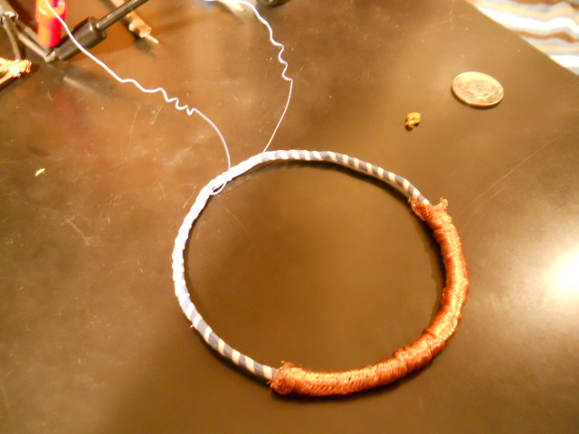

                  It sounds like your coils may be fine but you are getting overload when metel is too close. The concrete outside may have rebar reinforcement. My coils do the same thing, overload and just go silent whereas my VLFs have a ring tone for this I prefer the silence!! If you check a clean area outside with your VLF you can sit the coil down on the ground and it should be ok, otherwise?? Ive been playing with copper shieldind a little and it works great but my method is pretty ruff and I am restricted to a minimal coil to shield spacing. I am lacing my coils into the shielding from my coil cable.
                  For the spiral coils Maybe if you cannot find carbon paint some conductive mylar (space blanket) might work. I have not tried the scotch 24 it looks a little thick on the guage.
                  Here is another way to experiment with a similar method. http://www.geotech1.com/forums/showt...-shield-method
                  This is a picture of what Ive been playing with for shielding. Fast coils wound inside of the shielding, Click image for larger version

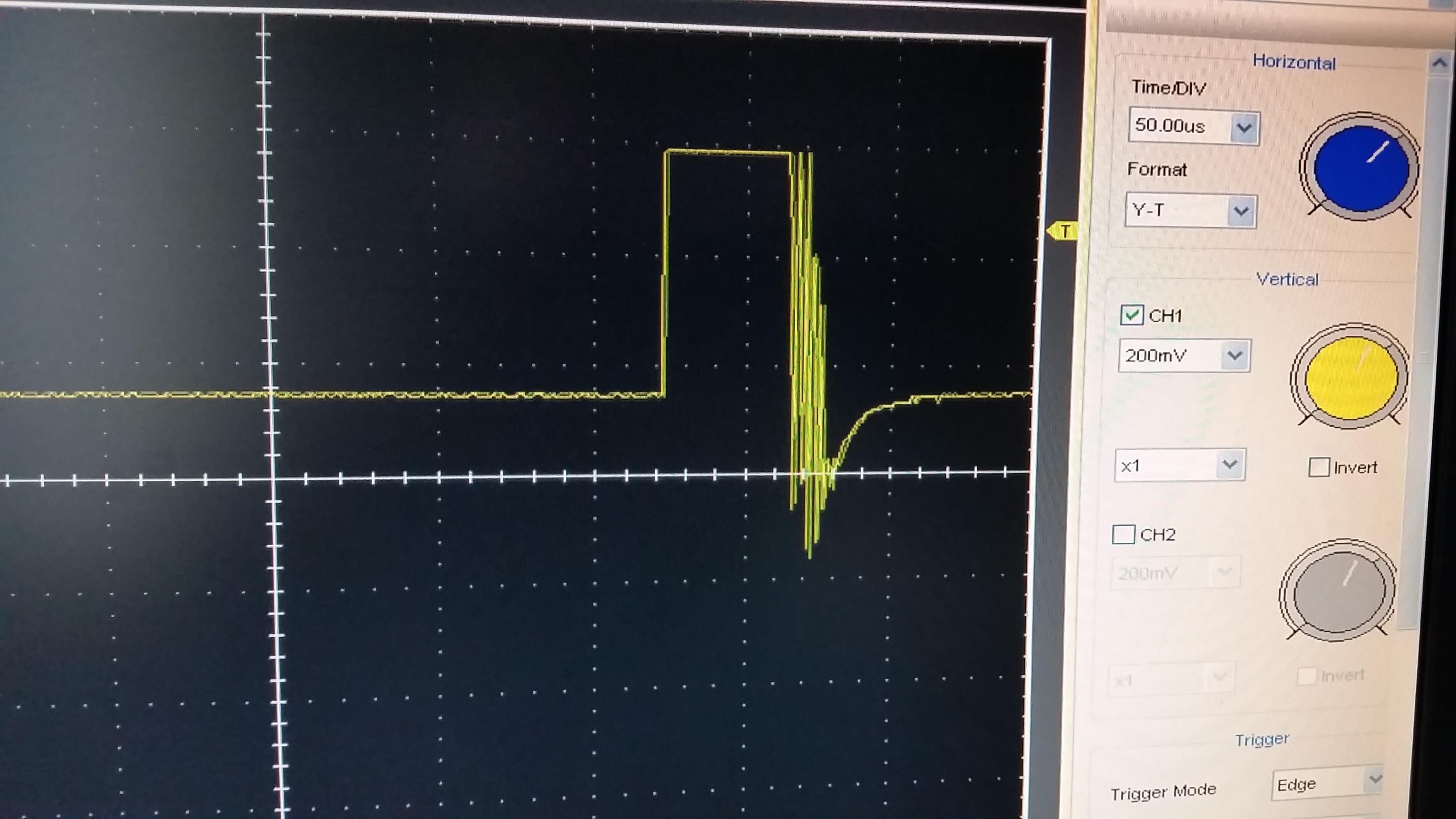

                      Hi Guys
                      I cant seem to get any shielding working. I tried first of all wrapping with some copper braid stuck to tape, but it was very thick and didnt work. Then I tried wrapped with foil. The waveform is below. But the detector made no noise at all. The only way I could get at working again was slowly changing the load resistor. It seemed to work ok but had a crazy ringing waveform. But this was the only way I could get it working. How can I shield this coil and get the proper waveform and depth?Click image for larger version

                        Maybe off base, but are you grounding the shield?
                          use graphit paint for shield, and how it is been told everywhere connnect the shield too
                            Hi Chris
                            Also what is the coil to shield spacing? Capacitance between coil and shield? Are you leaving a gap in the shield? when I use the copper shielding it is from a 99 ofc free microphone cable and the weave is very fine. It has two wires and a shield wire for independant grounding. In the kit instructions it is stated that only solid core cable will work. This is not true. I had problems with coax. It is better to join the shield to the ground in the box. I drilled a new pin in for this. Also when I attach the shieldind I fold the wire over itself and use shrink tubing to lock it together. If I solder the shield at the coil I loose sensativity( coil goes dead ). The solder joint becomes a target and nulls my coil. My coil to shield capacitance is .31 nf I am using both teflon mega tape and silicon rescue tape as the insulator but the rescue tape has to be wraped tight so it might not work on a spider coil.
                            Hope you get it figured out. Oh Yea Just a thought on the foil are you cross hatching it before you wrap or using solid foil? See the hammerhead article how Carl preps his foil. That might help.

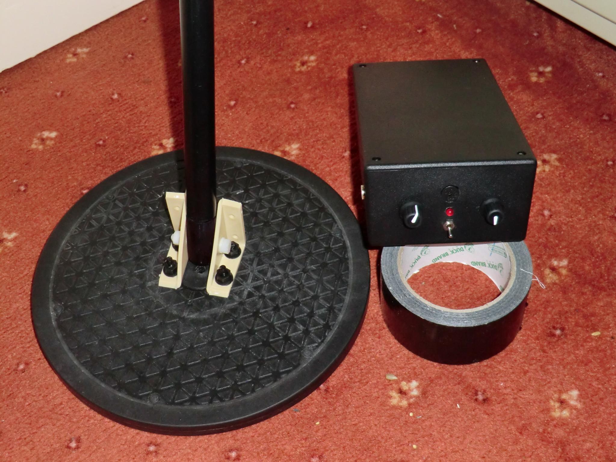

                              Hello regarding the Surf PI and its hardware, I mounted mine a Project box with all the controls at one edge and the coil input connect close to the end but on the side, so I can use a right angle plug to keep it all compact, I also think I shall use it in a bag or on a belt mount to reduce swinging fatigue. As for the search coil I bought a cheap cake icing spinner and used that to house the coil. Click image for larger version
