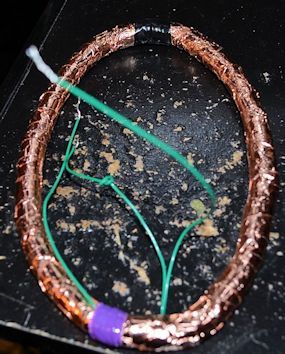

        Thanks for Carls page info, I will check that out in a minute. My coax is just a single core with the braiding wrapped around, is that the right stuff? I dont have a meter that measures capacitance tho. The coil with the extra winding is connected to my braiding, and the other connection goes to nothing. This is still the coil that performs better than all the others I have just made. So I will try my carbon powder on this first. I will experiment with the powder and varnish ratio, painted on some masking tape and try to get the correct resistance per inch, which I think I have read somewhere needed to be 1500-1800 ohms per inch.
        Kenny 444, I agree, that coil shell looks good.
        Multieagle, whatever I seem to wrap around my coils seems to stop them working for some reason. Thats why I'm giving the powder a go. Does yours still work with the copper tape on it? Is the depth reduced?

            You know, you may have something there with the twin coax. I thought about this when I first started but when I saw the screen is still connected to one side of the coil I thought it wouldnt matter, so I used old tv coax that I had lying about. Its all good fun experimenting.

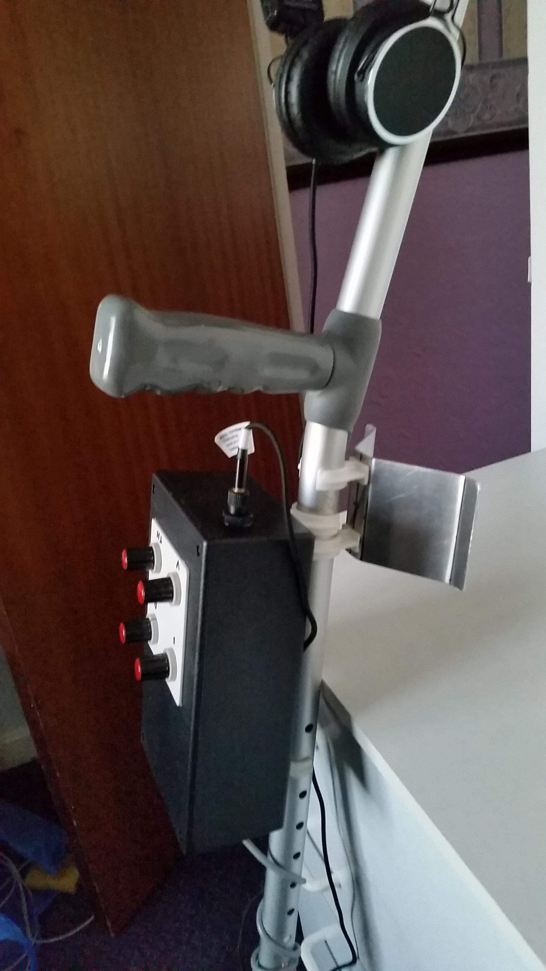

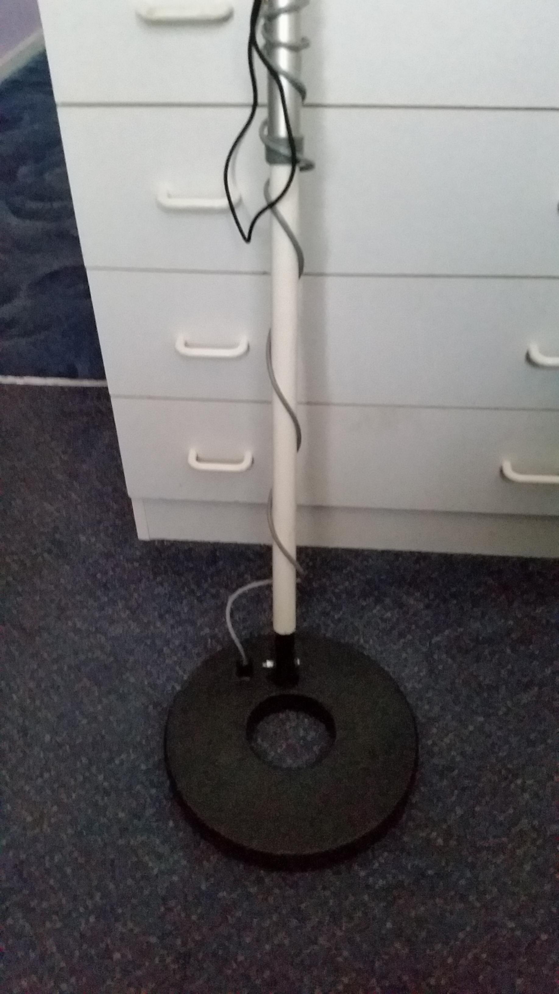

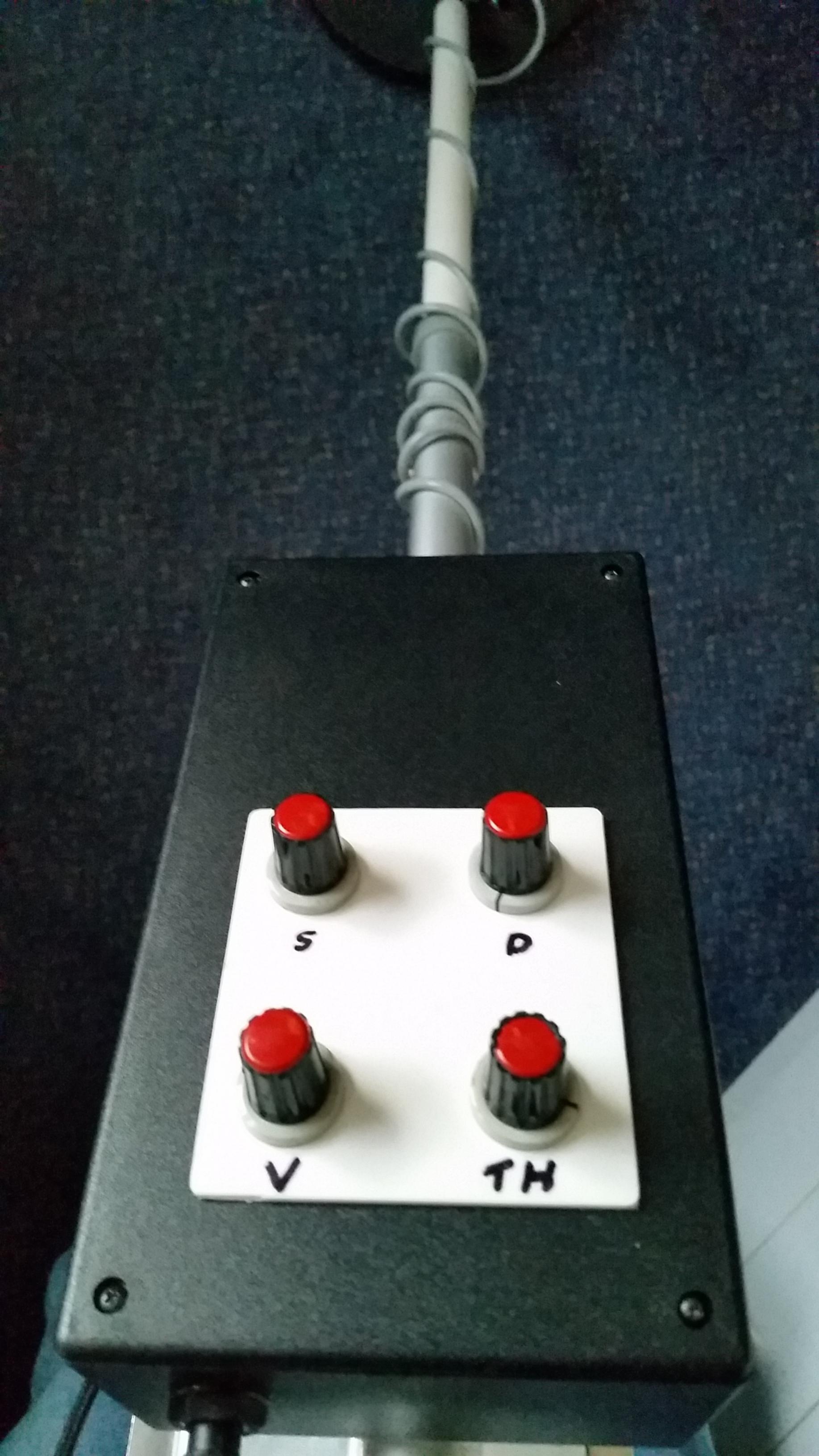

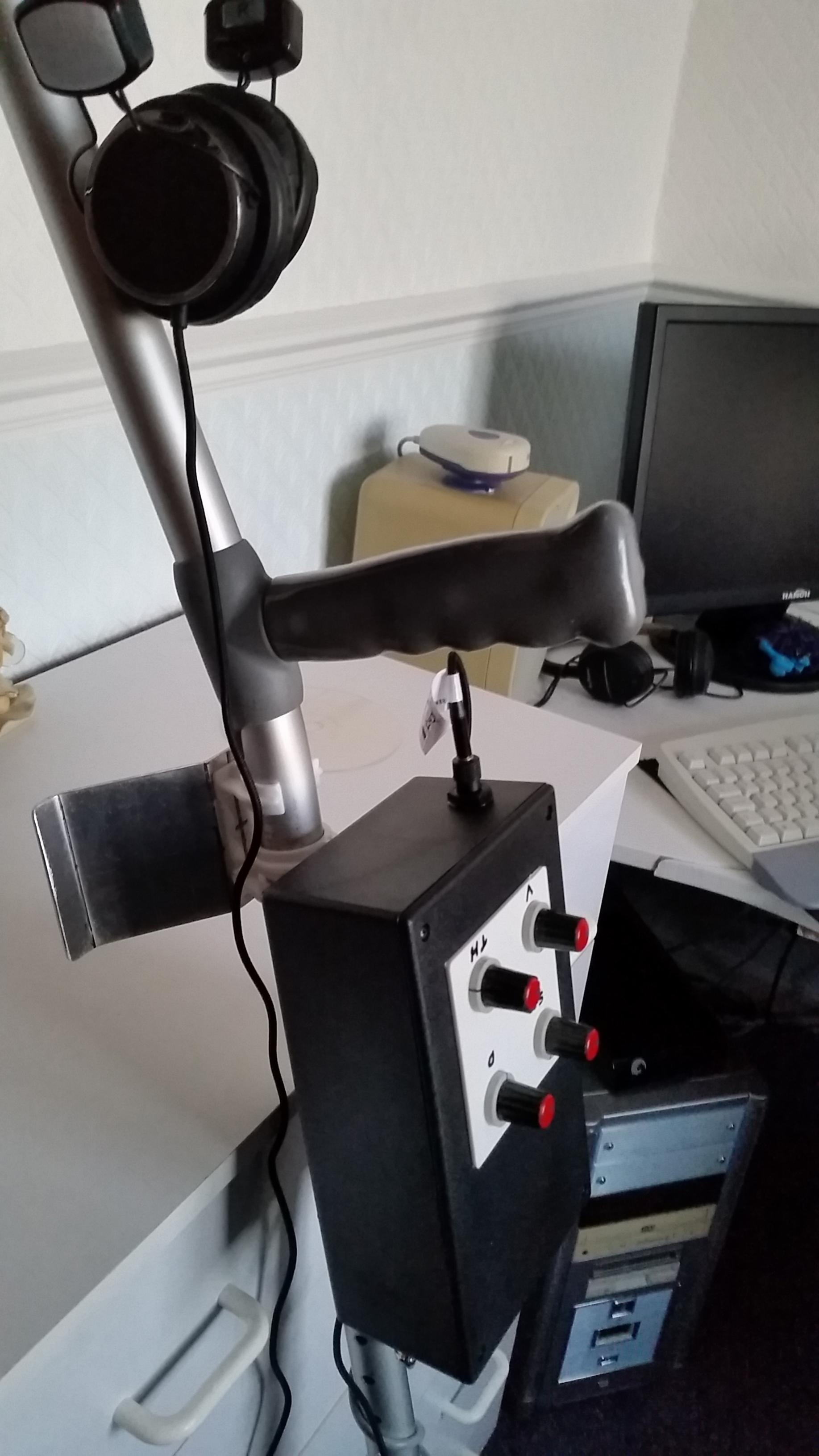

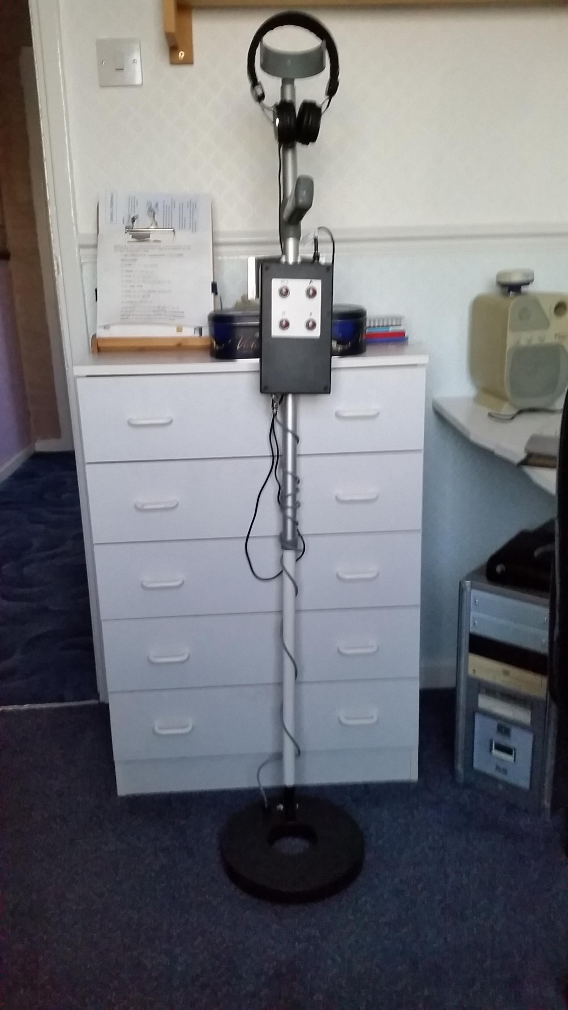

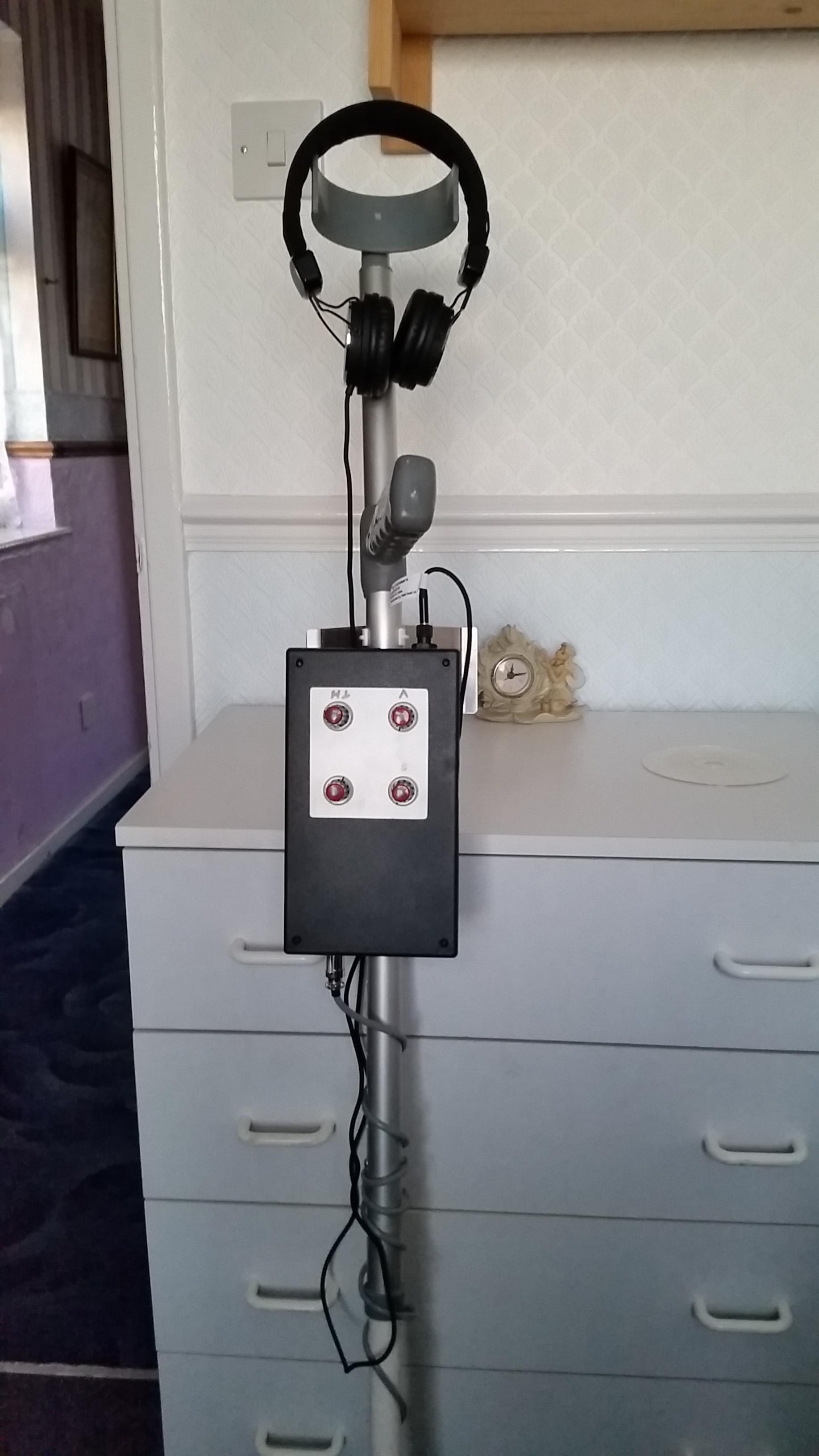

                                Hi Guys,
                                Ive finished. My objective was I wanted around 12" on a coin and good sensitivity on small rings. Well, with an english two pence I am getting 13-14" in the air. My small gold ring, about 10-11". So I am happy with that. These are in air tests indoors.
                                Outside is another matter. I tried outside and the detector found signals everywhere, I could find a piece of quiet ground. If I reduced the delay it helped a little. So I am not sure if its doing this because my shielding isnt effective or just because its mega sensitive and theres junk everywhere. In the end I think I upset it because I just got a continuous tone, (sensory overload ). Its ok on the living room floor; it found some funny signals but gave me a good depth with my coins. So I was wondering if there was some test I could do indoors to test if my shielding is working. I used carbon powder in varnish and wrapped a few turns of wire for a few inches then taped it up. It doesnt detect my hands so I dont know if this is a good enough test.
                                Anyway Take a look at the pictures. My next project is a Mirage PI from Sven in Canada. So just waiting for the board to arrive.Click image for larger version
