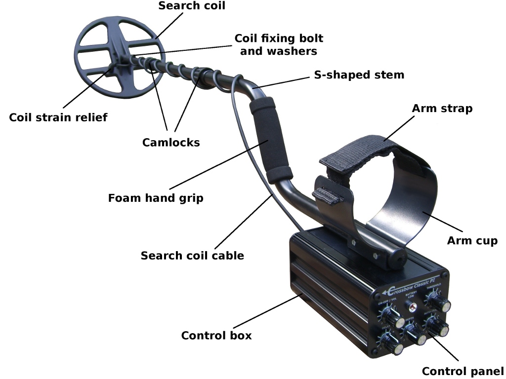

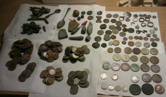

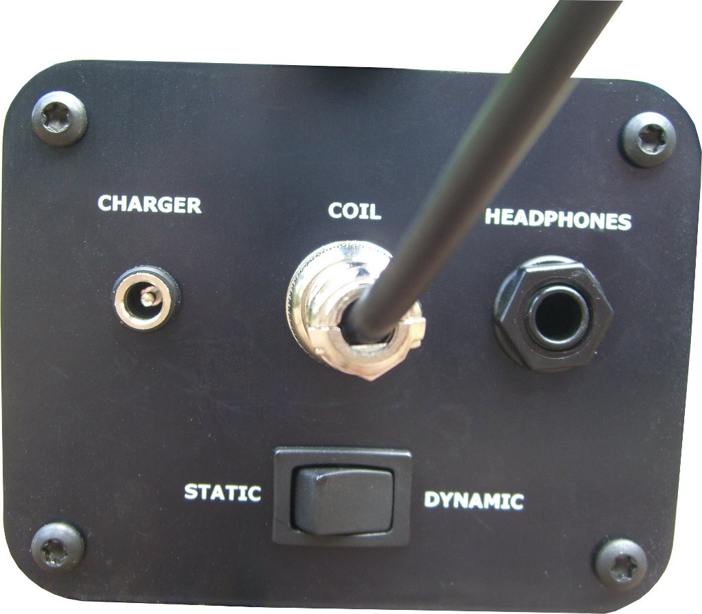

                  The Crossbow Classic PI detectors are based on the Hammerhead design, and were specially manufactured for someone who (unfortunately) never paid. Whereas the Hammerhead is designed as a learning platform, the many options can be confusing and make it difficult for a beginner to construct. Essentially, Crossbow is an HH variant with some modifications. The detectors were eventually sold to cover the manufacturing cost and to make a small profit. There were originally 12 detectors, but one person bugged me to build number 13, and luckily there was one spare enclosure, and enough spare parts left over to make it. In reality they were worth a lot more money, and the performance was excellent. For a couple of owners I made a small modification so that the Crossbow would work with a large Minelab coil (might have been 18"), and Garrett Seahunter coils (both the 14x8 and the 8"), and the supplied 10" mono. The feedback I've had is that the 8" Seahunter coil is the nicest one to use. Someone even converted his to a carbon fibre straight shaft.
                  Sven contacted me, and I gave him the complete details, and also updated the PCB to REV-B to resolve a couple of small issues in REV-A. The board contains a constant current battery charger circuit on the PCB, which requires an external standard laptop charger.
                  I've attached a couple of photos of the completed detector, and one of several items found by a satisfied user.
                  George

                          The split TX-RX connection is the same concept as with Minipulse Plus. It allows you to use separate TX and RX coils (e.g. induction balance). Then you can have a RX coil with a higher inductance to increase sensitivity. Each coil will need its own damping resistor.
