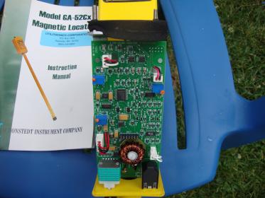

      I believe that is a fluxgate magnetometer that someone has put into a aquapulse
      housing. See my photo and note headphone jack and green rotary switch. Same as the
      findmall photos. The Aquapulse never had either of these parts. Circuit wise the aquapulse
      is almost identical to the mini pulse with manual threshold and a lower pulse frequency and longer tx width.

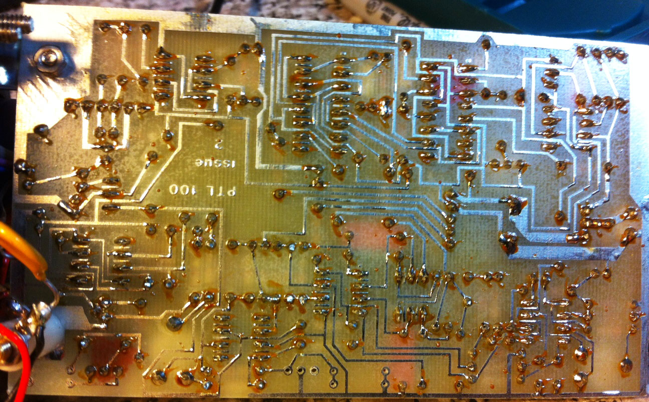

                bot side

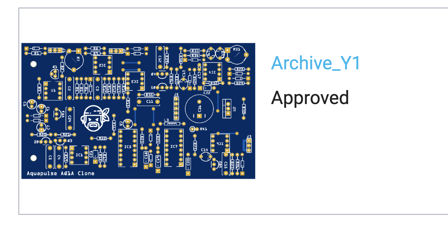

Name:	Screen Shot 2020-04-16 at 6.49.06 PM.png
                        Which project did you build ?
                        I bought a older model Aquapulse at an auction, opened it up and seen its no longer usable (burnt rails, dry soldering / corrosion), designed the PCB based on what i have, sent off to have the board printed, just finished ordering all the components, hopefully have it built in the next two or three weeks and the ill have to dial it in.
                          Originally posted by jasonNZ View Post
                          [ATTACH]49936[/ATTACH]
                          This is really interesting. Hopefully you can document the project here as you progress.
                          Cheers

                              There is a Sprint file of the layout for the Aquapulse AQ1B here on the forum.
