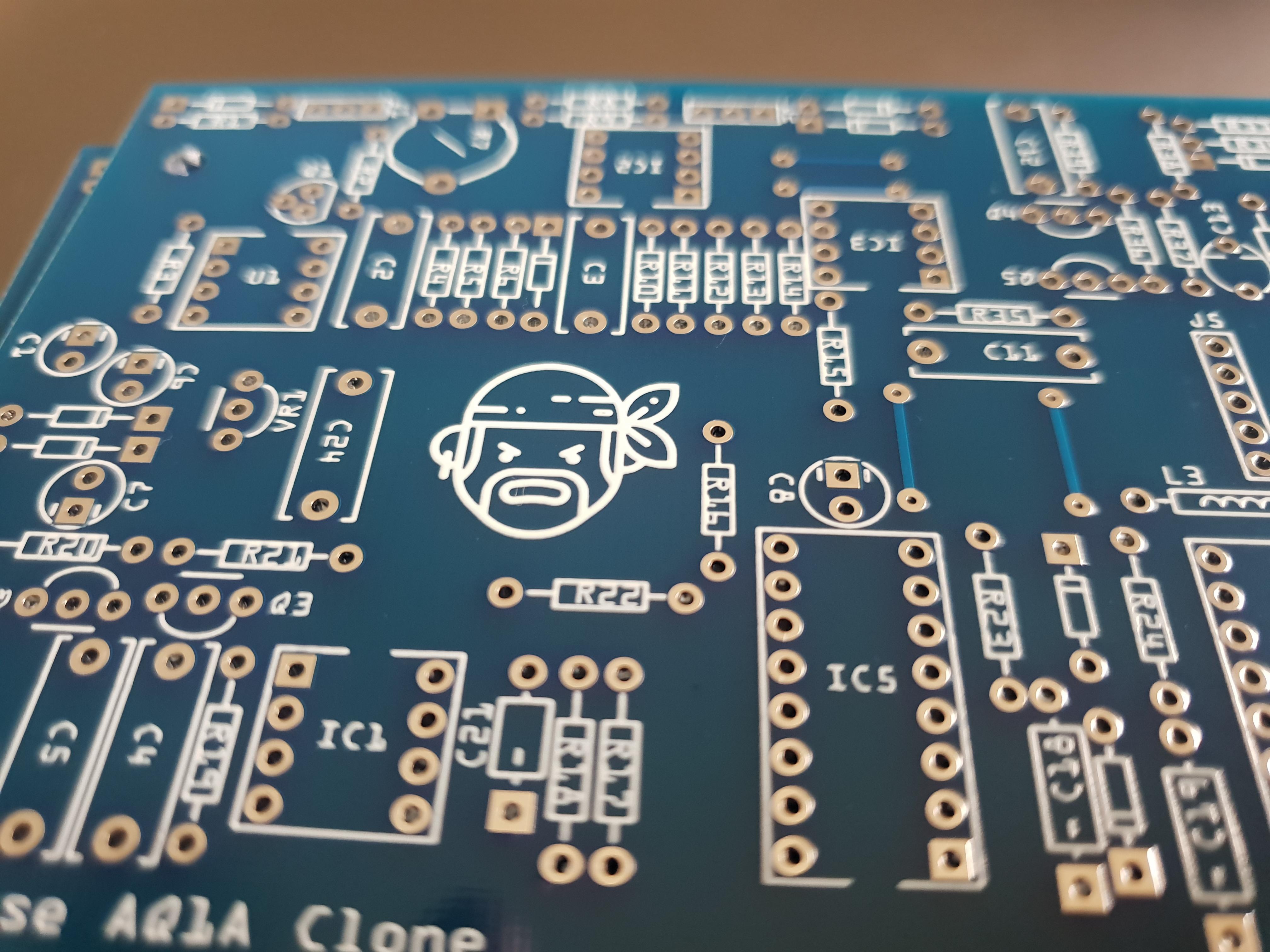

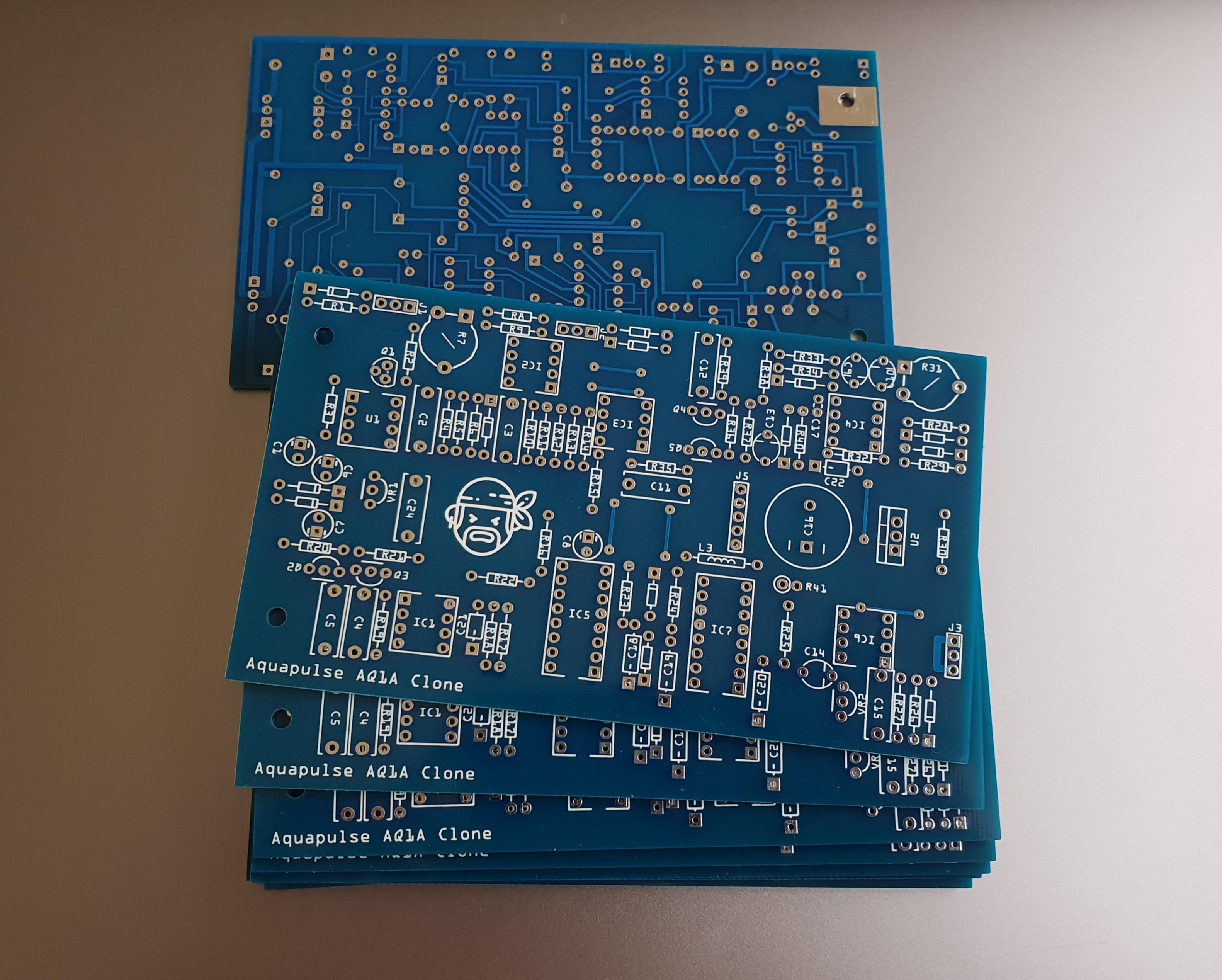

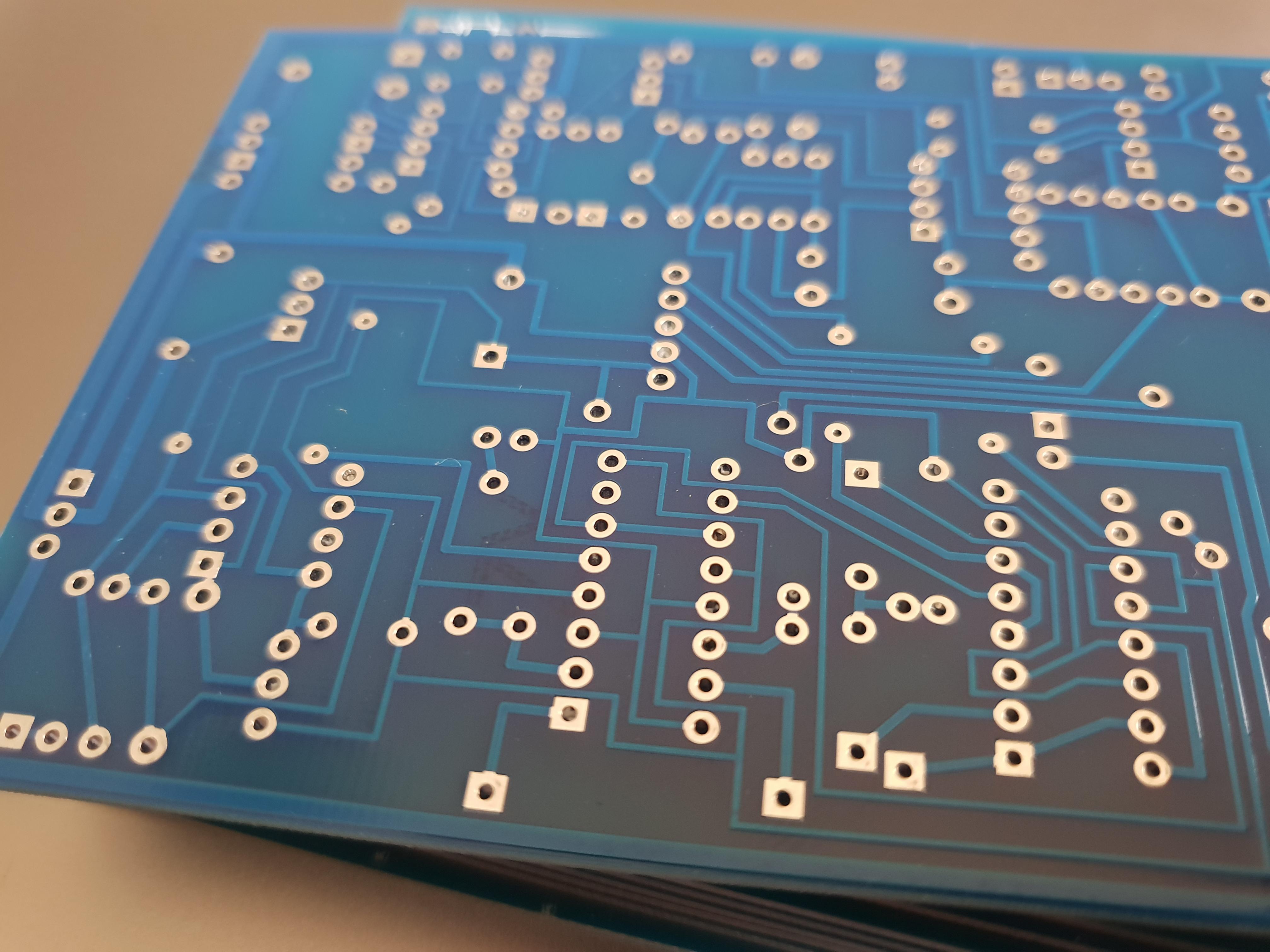

    My boards just arrived, still waiting for half of the components to be delivered
    Will be checking over the boards to see if there are any shorts.

      They look nice, got any spare ?, this is a joke but just connect a battery you will soon find shorts
