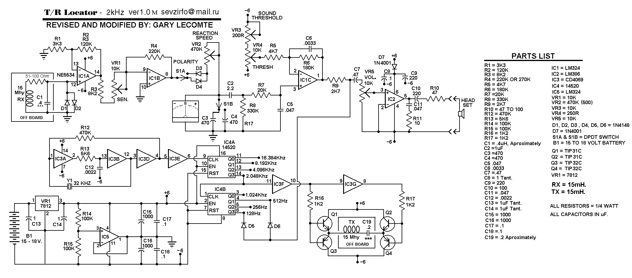

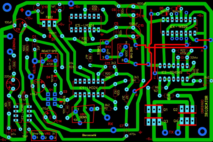

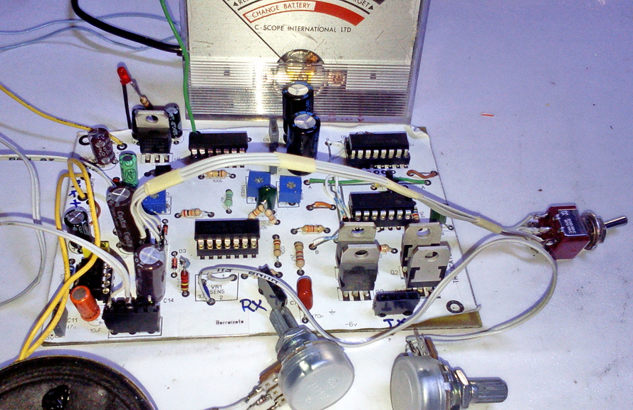

hi guys.. has anyone successfully built the two box metal detector? need some advice on my project.. thanks guys!
two box

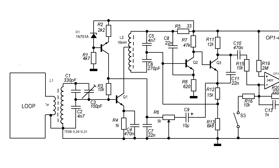

I took for basic "deep seeker" - project ETI 566 and Gemini-2. If look more careful these two detectors have similar circuitry. Circuits are on this site and in net. If you redraw receiver of Gemini2 you`ll get part of receiver ETI 566. First stage of Gemini...Attached Files
