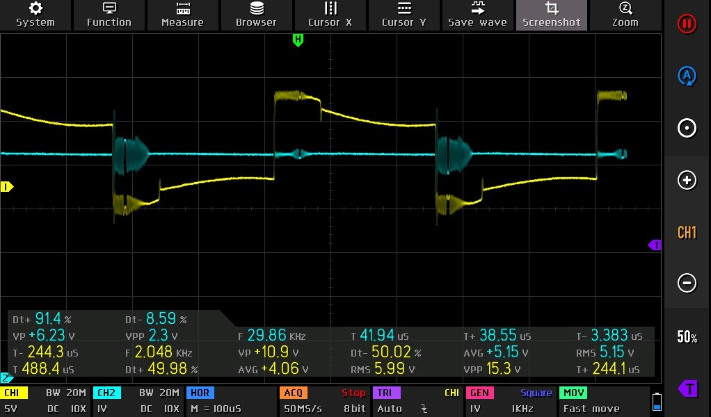

    • #92
      disconnect the coil from PCB,
      put scope on Rx coil withouth C1 = case 1 and with it = case 2. What amplitude you have at 1 m ?
      I couldn't get it to resonate although i put several values of capacity
      i only got the resception to about 1khz - 26khz its oscilating very much whatever capacity value i put
      i did follow one recommendation to put 0.82uf on both sides to get near resonance​
      This is the scope readings with cap 0.8uf on TX and none on Rx
      Thanks for your help

        • #94
          readings with cap 0.8uf on TX​ = and where is 120 V ?
          • #95
            This is the scope readings = very bad, = what you have on IC#G pins 8 and 9 ?​

              • #97
                For this circuit, an inductance of 15 millihenries and a capacitance of 470 nanofarads were required; try these values—or possibly 390 nanofarads—within this range. Ideally, the capacitors should be rated for 630 volts.
