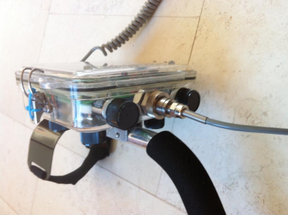

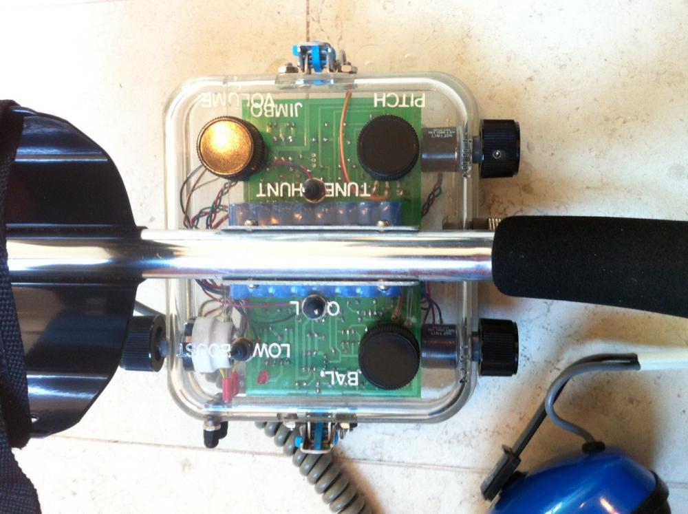

    This detector was manufactured 2 years ago for me. They are custom built by a couple of very talented people in Florida and modeled after a Nautilus detector. The technology has now been around for quite a while, but depth and sensitivity in the right sand cannot be matched This detector is virtually brand new and comes with both water coil and land coils and each has its own shaft to make the transition from land to water much easier. Paid $2900 new.
    The Aquasound detector is a very high powered TR unit (52V to the coil in high powered mode and 32V in low power). It has a custom built waterproof case that is a very strong, thick walled, clear polycarbonate (Lexan). The Aquasound must be used away from any black sands. The cleaner/whiter the sand, the deeper it goes. Tuning the machine is also critical (this is usually maximised after about 10 minutes of use). The coil loves to be submerged in water where the electronics can be really wound up.
    "Good" tuning will give you a depth of 18" but with "Great" tuning you will see 20" plus. The tuning then incorporates getting both "Null" controls centered really tight and then the 10 turn volume/threshold down really low.

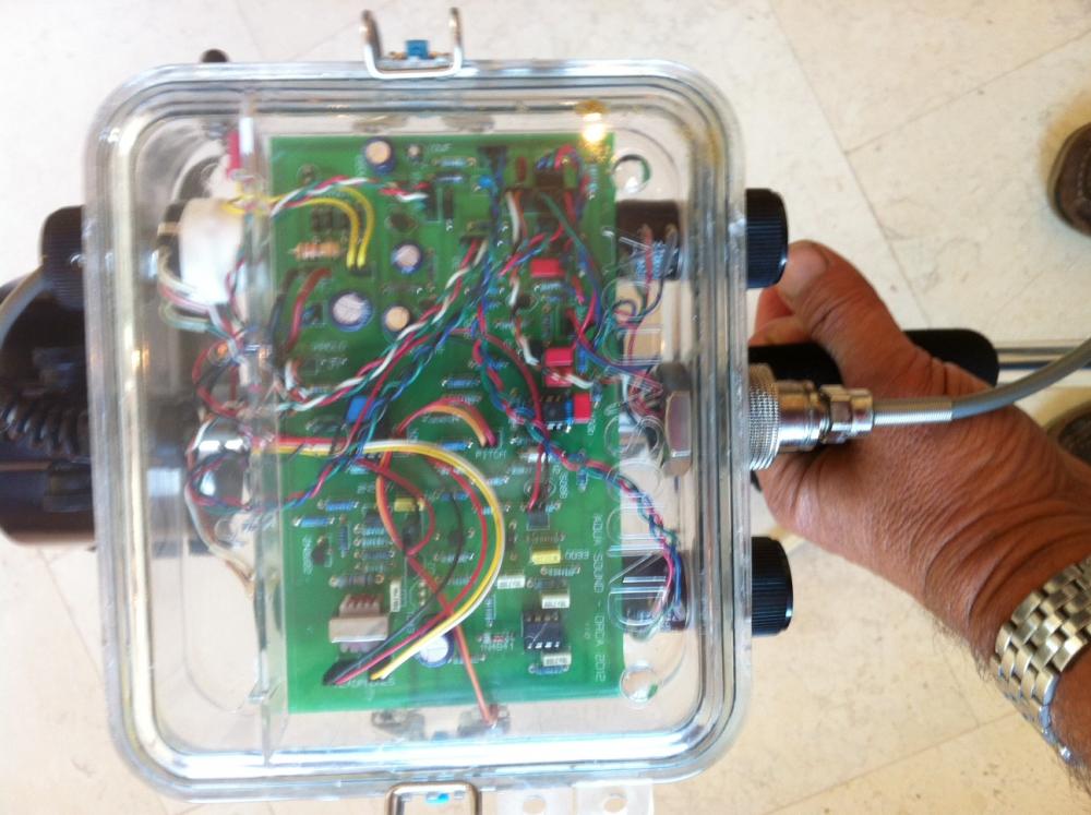

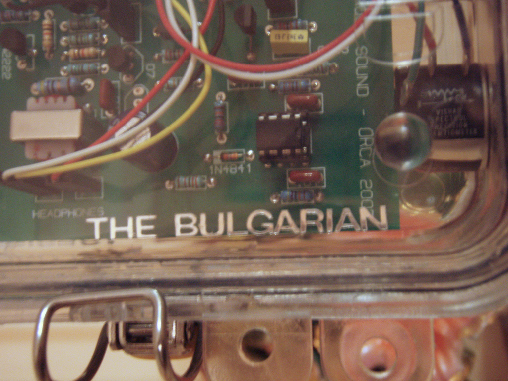

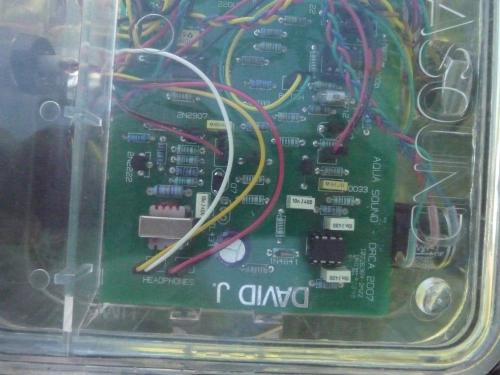

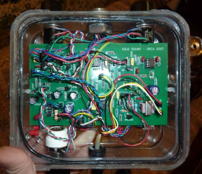

      thanks lots Don. one russian asked me about it what I have not. I see preamp built-in coil, some like as Nautilus.
      still one pic of AS.
        How to get 52V HI POWER TX mode out of Don schematic?
        Thanks Don!
          the high voltage is getting in the specific winding of TX, it has a point for generator connection and end wire where is HV. something
          like if you will take a fishing rod and begin to swing it - on its end you get more amplitude at its very end than you apply some low amplitude to some rod's begin part.
            Oh yes, I see. We get out it on autotransformer way. Thanks to point it out, KT315.

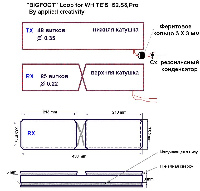

                      Following discussion on those Russian forum: as far I know Bigfoot is not RX Figure 8 coil, but TX Figure 8 coil. Or I am wrong?
                        do not know sure. big foot was been discussed in another thread, Carl there answered something on your similar question that I am not able to find momentary.
                        if you losed this info I put here again those pics from the thread. you see here clearly at pic RX has 8 config (the data gotta from Jurij Petric, ciklon; not mine).
