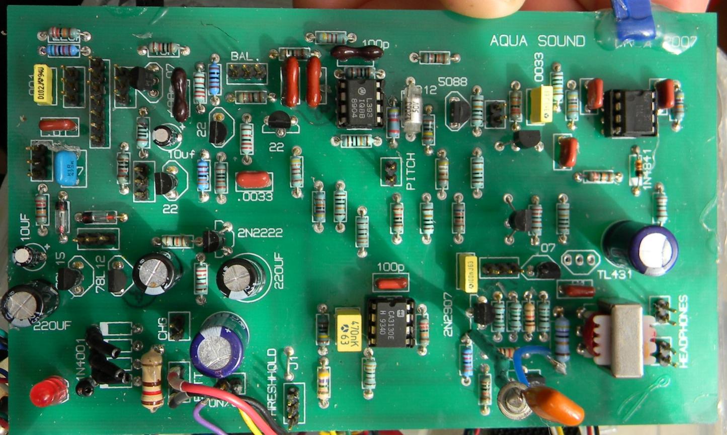

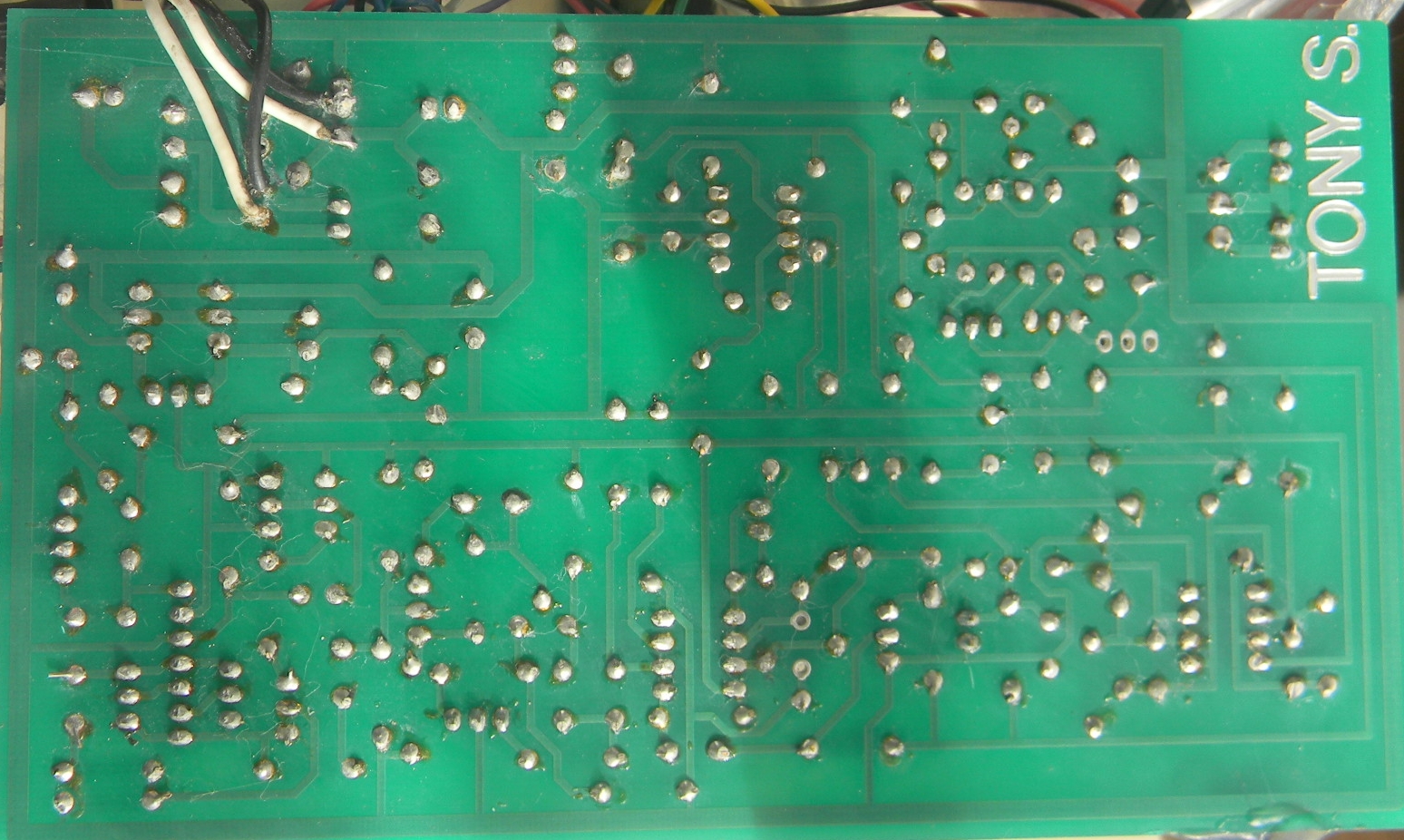

          i cant remember where i got these images from but they have been on my onedrive for a few years now

            thank you JNZ. read pls my small opus before to do the pics.

              Thanks for those. I'll trace the PCB and compare it to the known schematic. Now we might have a viable project.

                  The photos of the PCB are good enough to begin working on the reverse engineering.
                  If there are more pics to come, then all the better.
                  I have enough to begin the process.

                        I have finished tracing out of the layout. Only remains to assign component values and ID.
                        They need to correspond with the schematic.
                          I've completed the PCB layout and labeled all the components values etc.
                          The PCB from the photo provided matches almost perfectly with the known schematic.
                          There are some observations I made while tracing the layout.
                          1 The LM358 opamps are switched around, therefore opamp A and B are switched between the PCB layout and the schematic.
                          2 There is a 100k resistor between pin5 of 393 chip and ground. This is not shown on the schematic.
                          3 There is a 10nF cap on either side of jfet source and drain connected to ground. Only one is shown on the schematic.
                          4 There are a few additional resistor's and a transistor and a tl431 voltage reference (tlc431 is left unpopulated on the PCB), associated with the audio section that is not on the schematic.
                          Otherwise everything looks good.

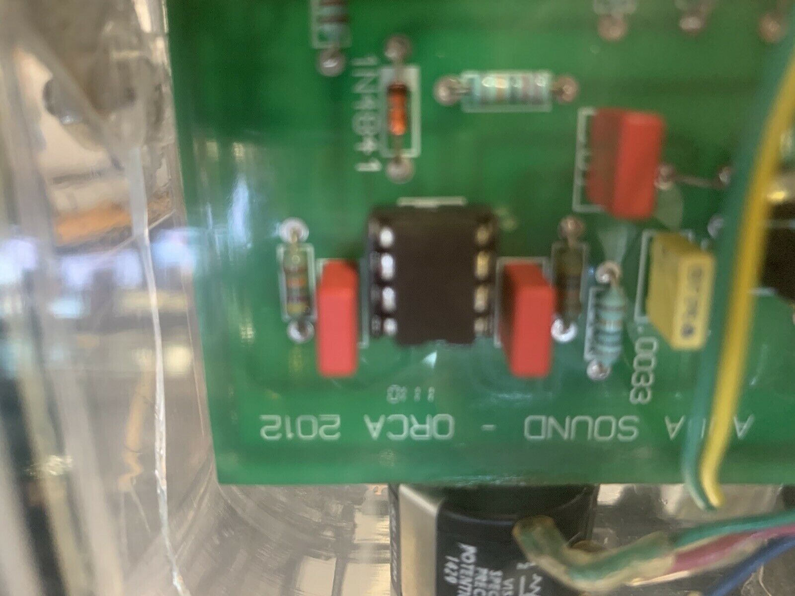

                              Guys,
                              on Ebay there is a sell unit; pcb is dated 2012; pheraps it have a more updated schematic.
                                Here is the layout. Please you can look over for any mistakes. But I think it's good.
                                One very interesting thing I noticed was that this particular unit has an additional 78L15 regulator which can be switched in instead of the the 78L12, maybe it is used when bat voltage is good, when battery voltage drops, you switch over to 78L12. Or maybe it's normal/boost functionality. I'm not sure, but that's how it's wired. Perhaps the user manual can clear thing up.
                                I'll update a new schematic.
