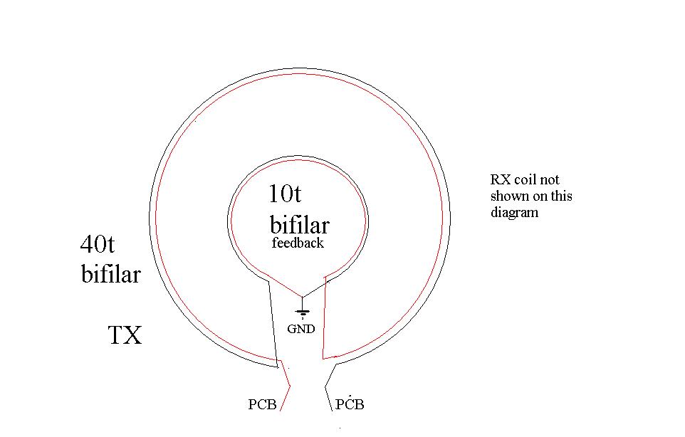

              This is the Nautilus coil. The number of turns can vary according to the size(diameter) of coil, but this is how it is wound in the bifilar configuration.
              • #52

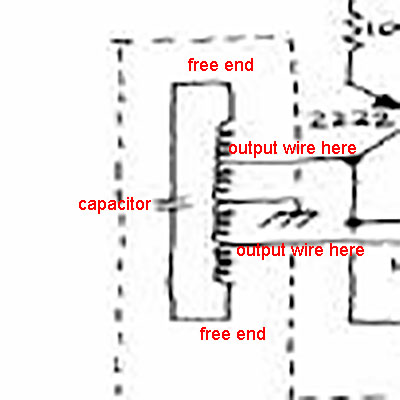

                  Just tying up a few loose ends.Some more observations, paying particular attention to the TX circuit and coil.Firstly, the pnp transistor which drives the coil is mislabeled on the aquasound schematic, it should be 2N2907.Secondly, and this is important, the tx oscillator will NEVER oscillate the way the coil is shown connected in the schematic. It should be connected at both ends of the TX coils and NOT at the point of the feedback coils. I will draw the corrected scheme and post later.
                  • #54

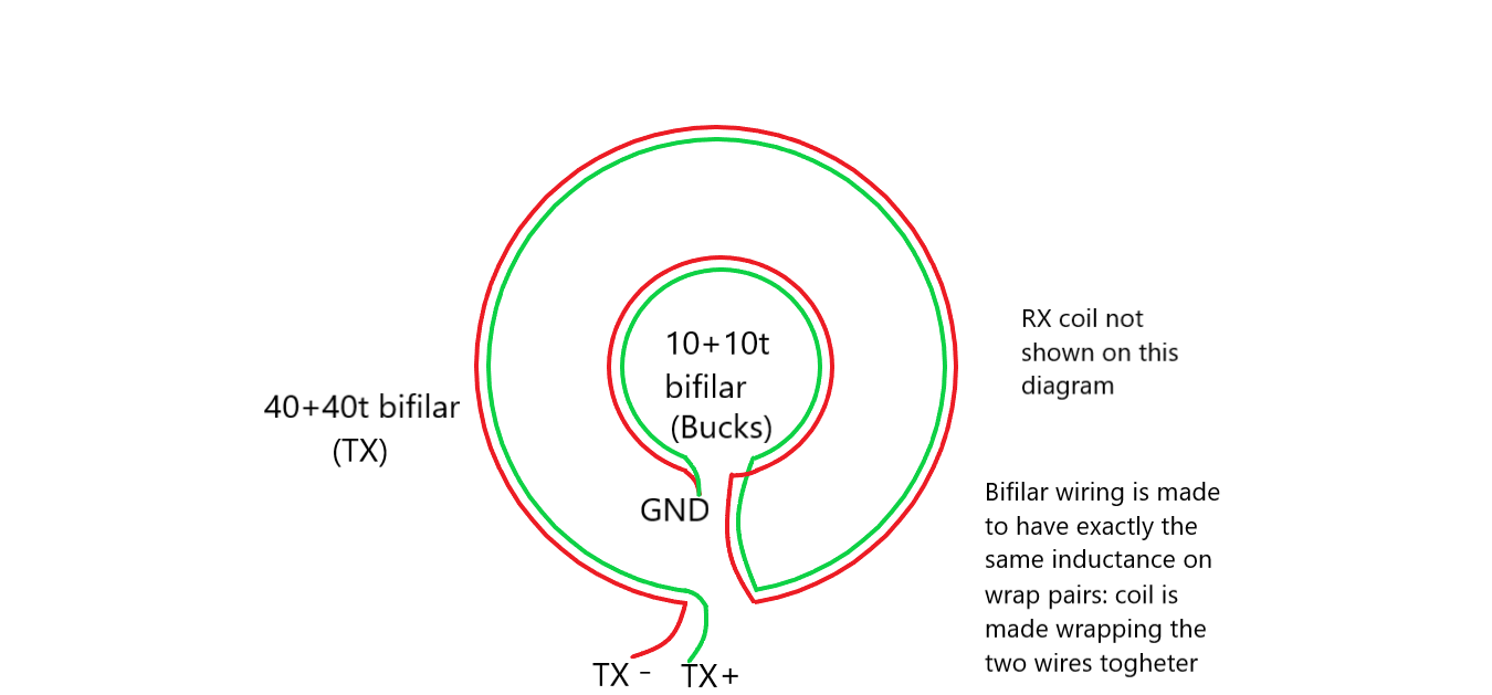

                    I think the coil is made like on this draw:
Name:	Aquasound coil diagram.png
                    • #55
                      [ATTACH]50110[/ATTACH]
                      Hmmm, interesting.

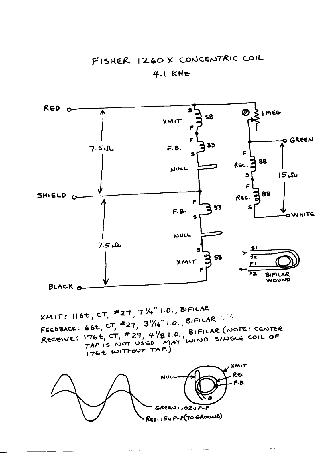

                      I base my drawing on Fisher 1260 coil guidance.
                      • #56
                        I think both your drawing and mine are electrically the same.
                        Yours is better because it is less confusing.
                        My drawing gets me dizzy when I look at it.

                            look on schematic. you have to see what you do not want to see.
                            The coil will not oscillate the way it is drawn on the schematic. I tried in ltspice. I will put the file.
                            • #59
                              After pondering some more on your diagram of the coil, I think you arrangement is absolutely correct.
                              When the first tx coil is energised, the expanding flux excites the second coil( because they are wound bifilar), this doubles the energy transmitted by the coil. In other words, the second bifilar tx winding aides the first(mutual inductance).
                              In my drawing, although I followed the Fisher 1260 diagram, with first tx excited, the other bifilar winding is energised, but in opposite direction, so it opposes the flux field. Intuitively, this subtracts from the total energy of the coil. Not what you want.
                              So in the end, I think you got it right.
                              I think I will build your coil and just the tx circuit on breadboard, and check to see if kt315 has a point.
                              • #60
                                I'll be able to check both ways by simply changing the connections.
