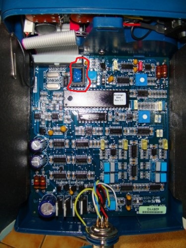

Information Minelab soverein elite.salve try the scheme of Sovereing elite. even if I do not find the pattern if someone can help me. I opened the metal and I fall and the internal screw that tightens the box pin 4 on the metal wires when I connect the plate goes off take it off and goes to the door. Integrated changed lm 2931, and TL062 .. chepuo be. It heats the 2931 when I connect the plate. thank

hello I am attaching the picture, and circled in red if you do not know what route he and impedance .the he placed the metal but the discriminator does not work. how to get up potentiometer disck off his dime. then it makes me sound bad on the copper coins. and good on the foil what can be
then as I said hello. metal working me. but it has little sensitivity. then he does not answer the discriminator .alzo potentiometer of discriminatore.mi removes the coin rame.e I suna the .cercavo foil the discriminator circuit diagram. Integrated I changed, i.cd 4073, cd4077.cd.4066 cd74hc00..tlc277. tl 062.lm2931.tutti mosfets. . what else should trank
Can you hear sound in the speaker? If so the blue bobbina is good, do not replace. That is an audio transformer that is part of the speaker driver.Originally posted by destiny755 View Posthello I changed the cd 74HC00 metal is fine .... but now I do not know that blue bobbina what it is and what you can put in place
