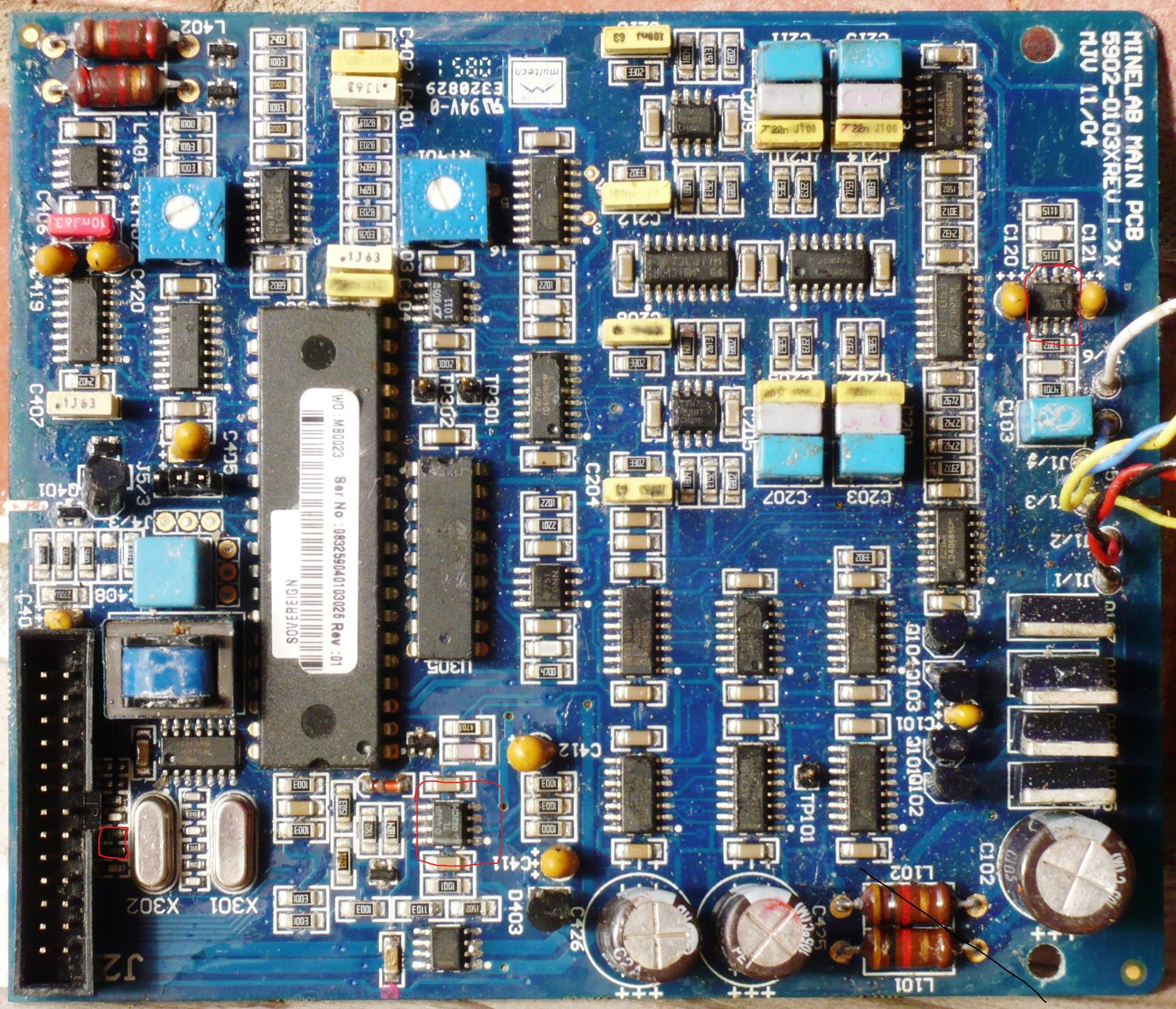

    Originally posted by destiny755 View Post

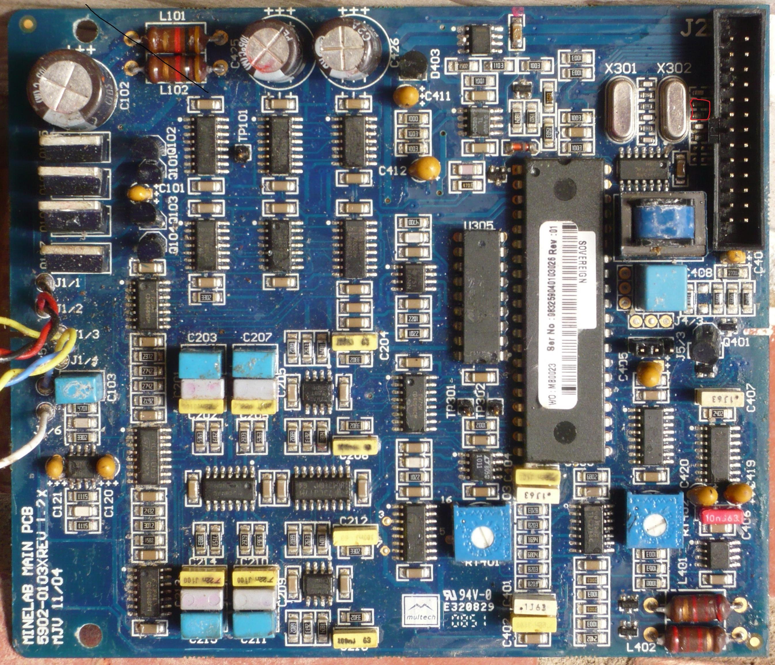

    but thanks kat and photos .. I was wondering if you could get the outline of the pcb
    hello kate I broke you the two resistors or marked in red do not know the values if you can help me .. if you do not need do not put them through
      L101 & L102, Those appear to be 1000 uh Coils.
      Not Resistors
        He means the two SMD resistors in the RED box, top right corner of the PCB image.
        The lower one looks like '01E' = 100K Ohms.
          is the square ones in red .. how shall be marked 103

              hello to all the talk about it Sovereing elite. no one can help me .. the metal was fine. then turn on and off I go a beep sounds as if she wanted to leave but did not hear anything does not sound went out after and how I can get my hands integrated all changed,, do not know anymore what to check
                hello I was broken markedly transistors k940 but do not know where to find it
                  Do a Google Search for a 2SK940.
                    hello guru I found nothing montato.ma part makes a beep as if to leave but nothing .. I do not know what to check the voltages are affixed to power all changed
                      hello guru but those that I have built you circled in red numbers that are ... my mounts tl 062, and one h and a 833 lm right
