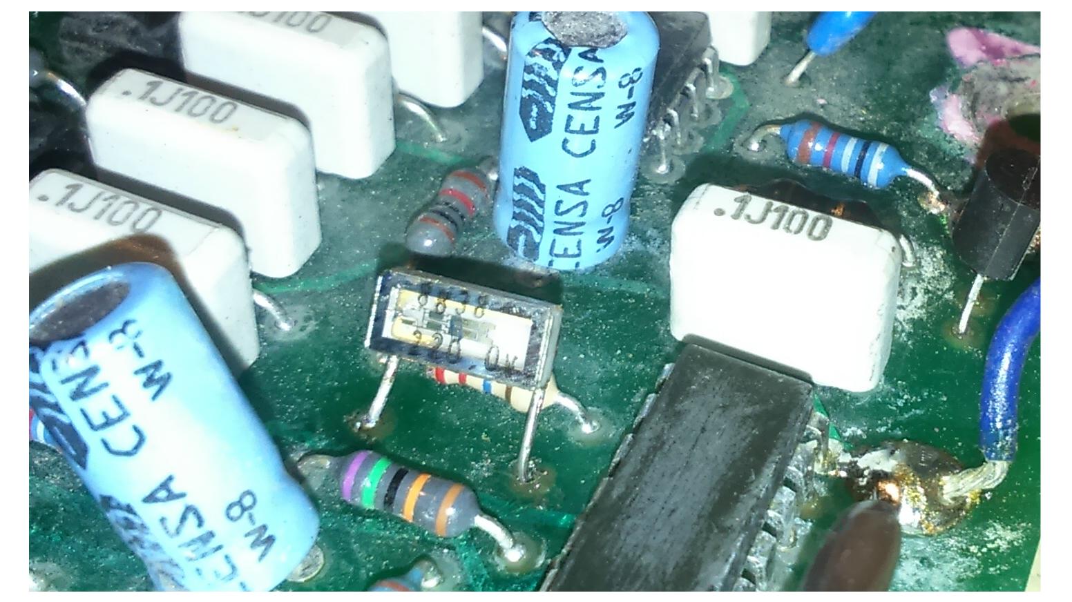

    Anyone know what is this component labeled 8838?

    Is that a ceramic package with a glass window? Could be a crystal resonator. A better straight on photo, perpendicular to the window would be nice. 8838 looks like a date code, 38th week of 1988. Need a better view of the second line. Anything on the back?
    Rick
      Looks like a tuning fork crystal. The glass window allows it to be laser trimmed.
        This has sparked my curiosity. I agree that it's most probably a tuning fork resonator. 220.0 kHz perhaps?

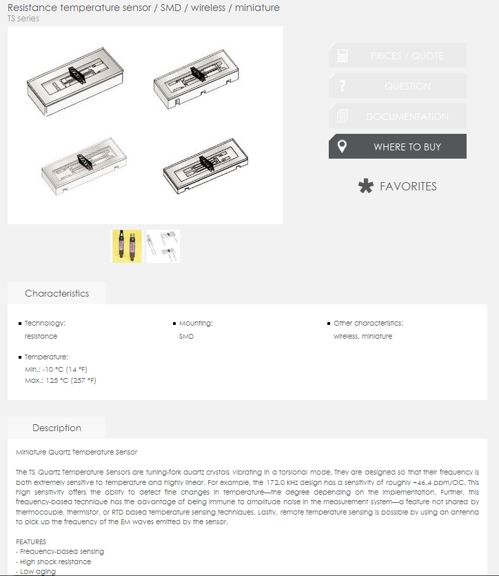

        To leave nothing out, there is a remote possibility it may be a resistance temperature sensor.

        It looks like a 22 MegaOhm resistor partially hiding beneath the mystery component.
        I'm mentioning it, because I've never seen such a high resistor value on a "normal" PCB, just in high voltage circuits.
        Link: http://www.directindustry.com/prod/s...70-499111.html

          Also could be the feedback R in a Pierce oscillator. However, I don't see any shunt caps.
            glass capacitor. use GOOGLE.
              Could it be a 220 uF capacitor ?
                no no. desolder it and measure on C range.

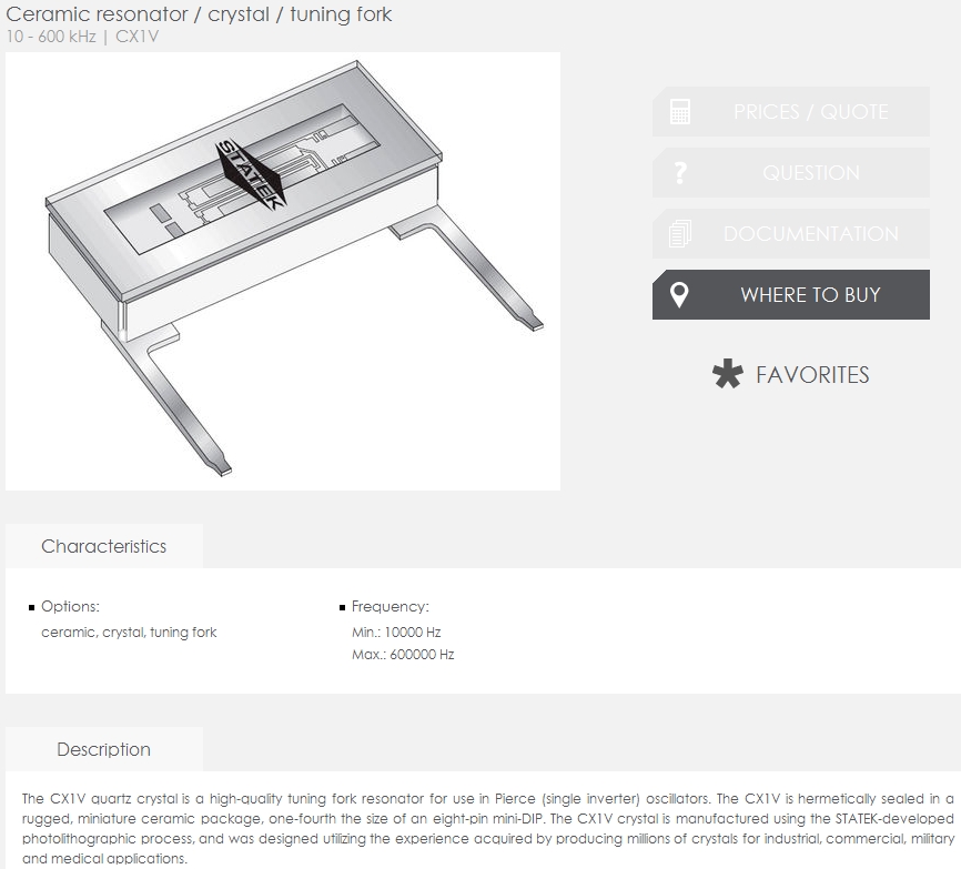

                  It's a tuning fork crystal, 100%. I would assume 220 kHz, it's a package I've come across before, CC1V, I think, though that may be with a metal lid, rather than the glass? top.
                  Edit: See here.
                    Tuning fork crystal by STATEK. 220 KHZ ... similiar to these ( 32.768 Khz ).

                              Looks like the OP is reverse engineering the cct ..possibly removing some sort of potting / epoxy .. note also the chip iss have been scratched off. If the OP could post a picture of the back of the component then we could refine our opinions. Dont think its a glass cap though ☺
