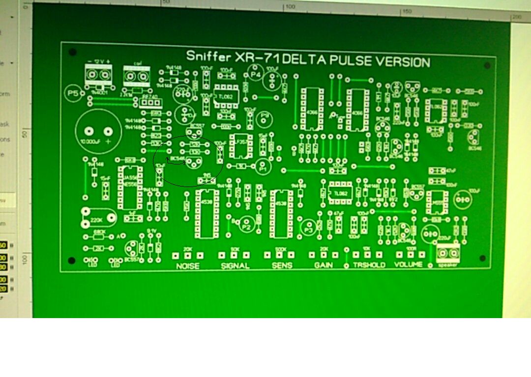

              Diar kt315, first of all thank you very much for your time and willingness to help.
              I think i found the error, the pin7 from the UA556 is not connected to the emmiter of the bc546 as it should be.
              The upper track stops and is not connected as it should be.
              Take a look.

              Jezz you can try it also.
              Respect to forum!!!
                with this error dp must work, but a circuit of overloading protection is turned off out.
                  What do you mean? That this is not an error but was made that way? By connecting this I disable a protection? Pin 7 is the vss pin and now it's floating!!!
                    ERROR
                      Ok got it, what i found is an error that must be fixed, but what you mean "...but a circuit of overloading protection is turned off out."?
                        VT2 VT3 is a circuit of overloading protection.
                          Sorry but you confused me again! By VT2 and VT3 you mean the pair of the BC transistors I suppose. After I connect the missing track from the pin7 of ua556 to emmiter of the BC transistor what should I be careful for to not overload the pi?
                          By overload you mean big input signal or is it possible to burn the pi?
                          Thank you.
                          PS. Be patient please, someone may have electronic knowledge but not great on pi subject.
                            ok. do you need electronics basic learning course? if i look on ANY schematic i SEE HOW IT IS WORKING in MY mind for SECONDS!
                            why you do not see for what VT2 VT3?
                              Don't need anything but an answer to a question that made in a forum from anyone that knows the answer. That is what forums is all about I believe. Now, to answer your question, no, can't understand what a subcircuit does if haven't fully understand how the whole circuit works. At my case now, no, can't see why the machine will maybe overload by connecting the missing track. All I see now without the track is a non working oscillator, or a partially working one to be exact. Anyway, thank you very much for your help so far. Have a nice tomorrow.
