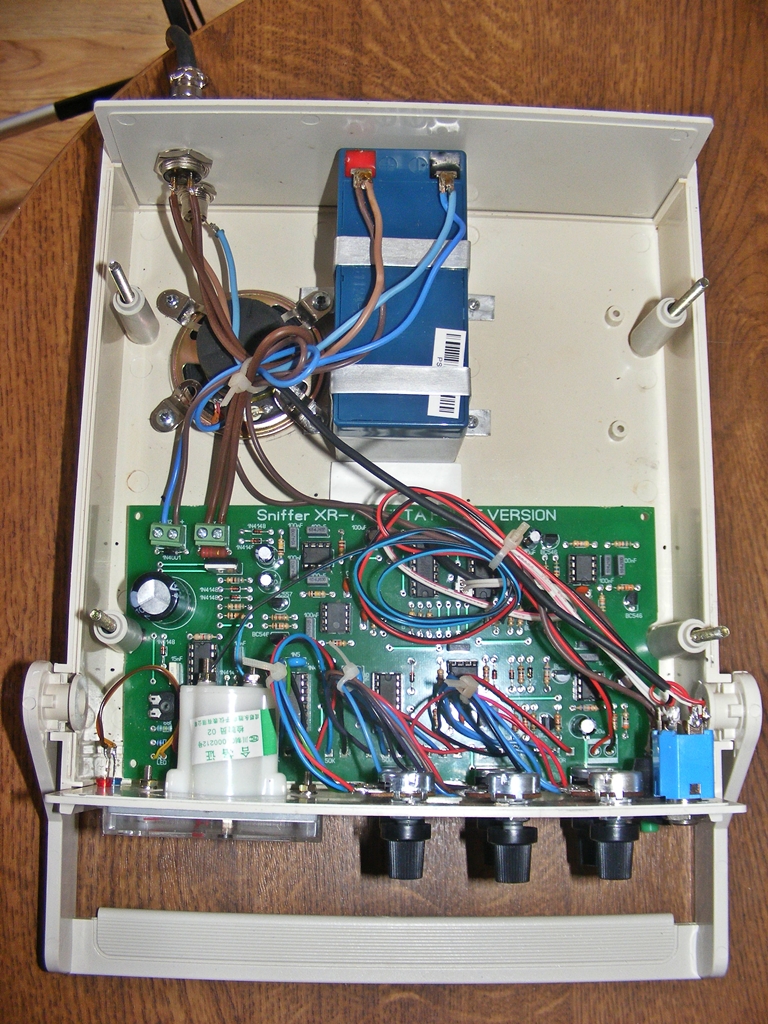

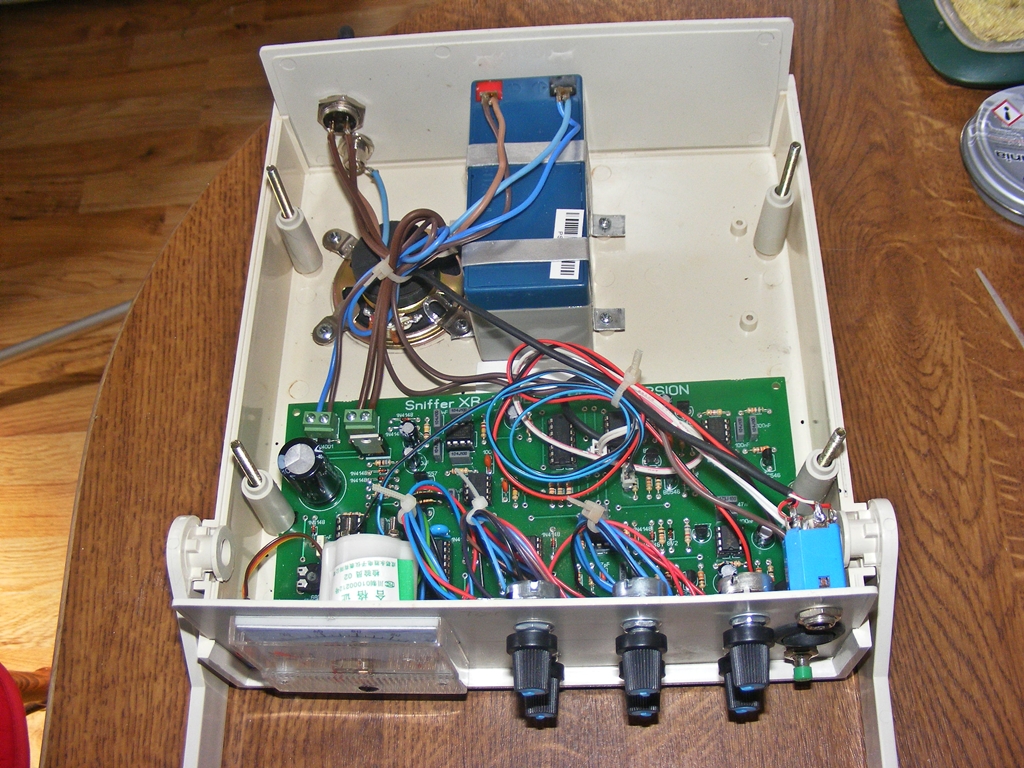

bad. what is your power supply? is it stationary impulse with 2A output current or batts?
Sniffer xr71 / delta pulse version

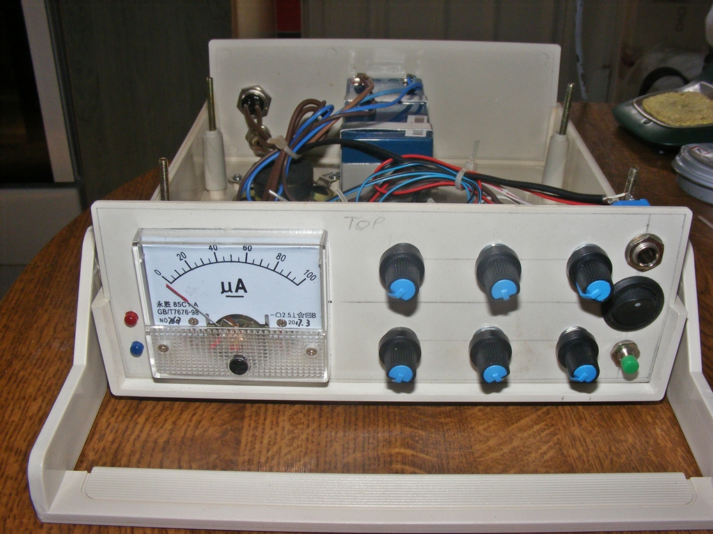

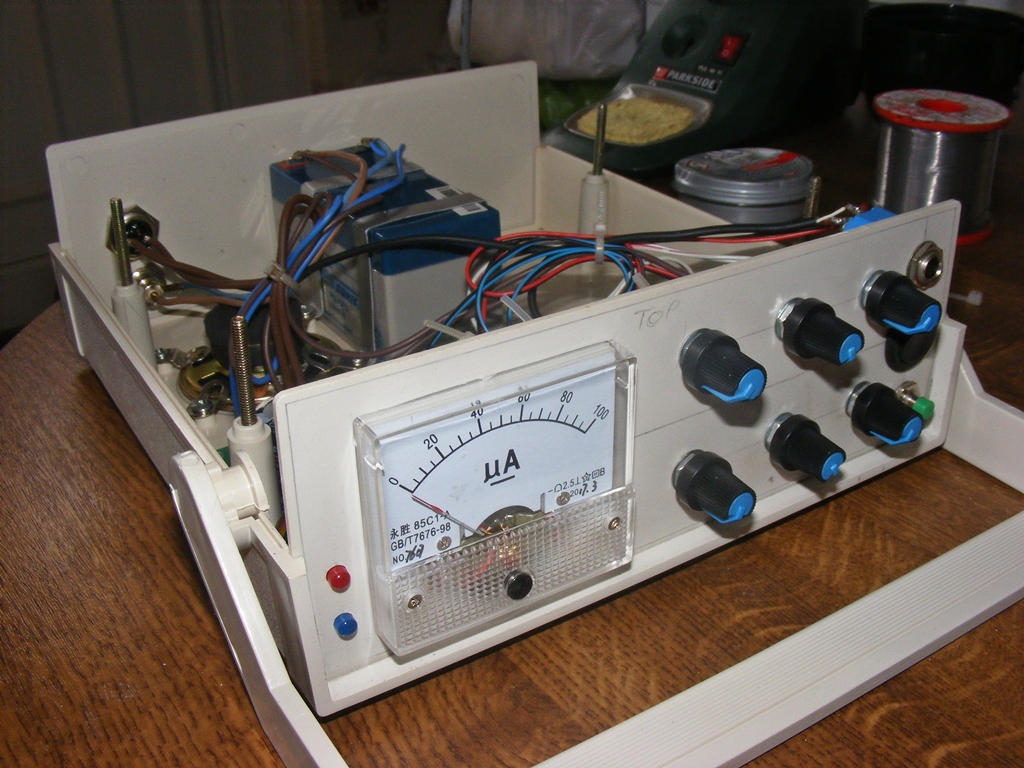

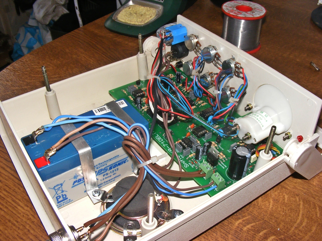

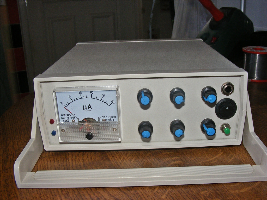

i had a bit of a play about with the machine earlier this afternoon out in the garden. i put the control box up about 2ft off the ground on top of a plastic container. same for the coil. i wasn't getting any EMI interferance. i tested the machine with a metal pan about 6" in diameter. rubbish, dosn't matter how you play about with the knobs. about 10" start to pick up was the best i could get. coins you are waisting your time. it hardly know they are there.
my board does the same as Jezz does. no matter where the "signal" and "sens" knobs are set they do absolutely nothing. i think we must of bought the same board off the same Ebay seller from Turkey
well it looks like it's going on flea bay for spares or repairs.
i am not kidding. the grandson once had one of these cheapy thinks bellow and it would of done a better job.
