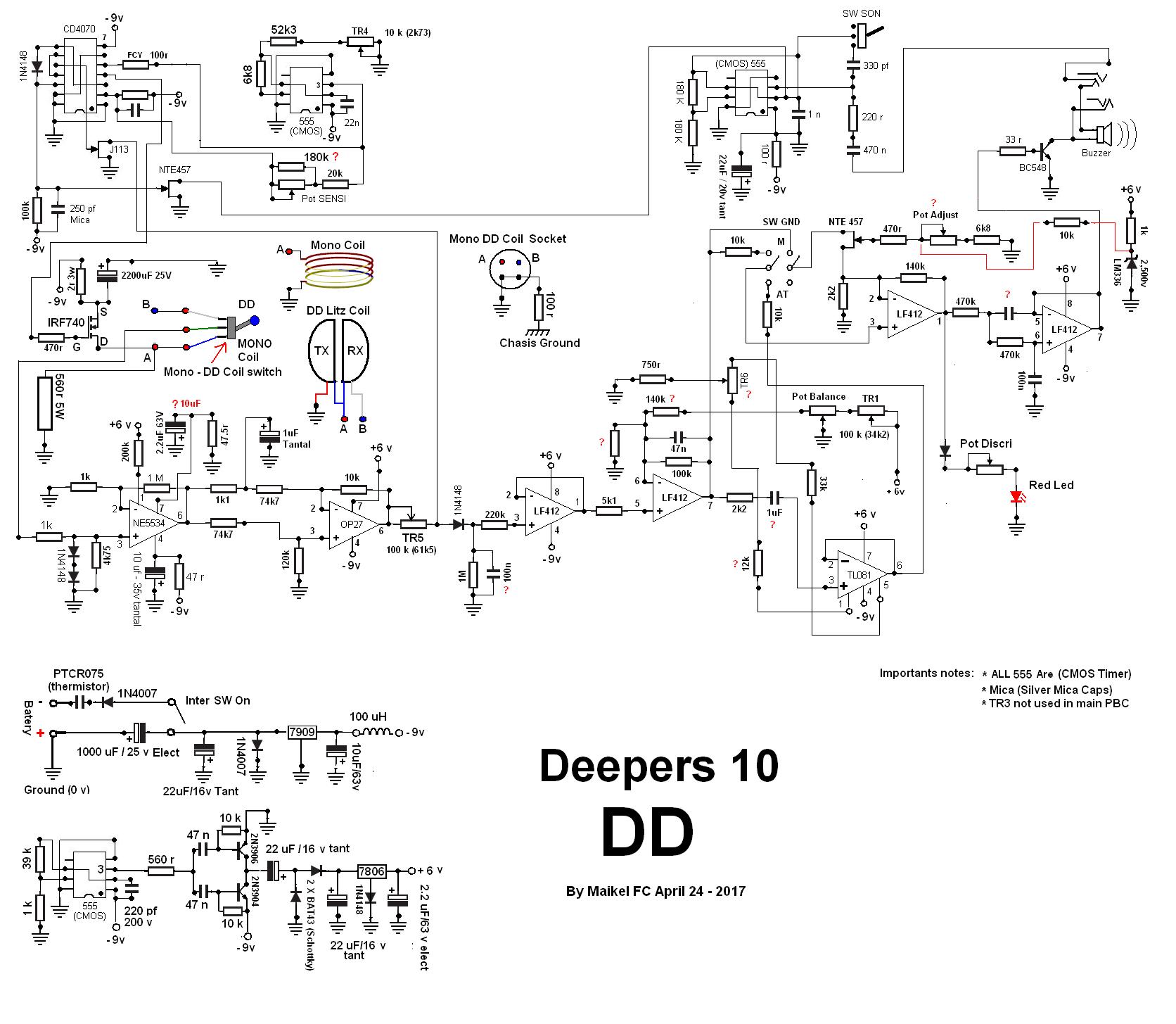

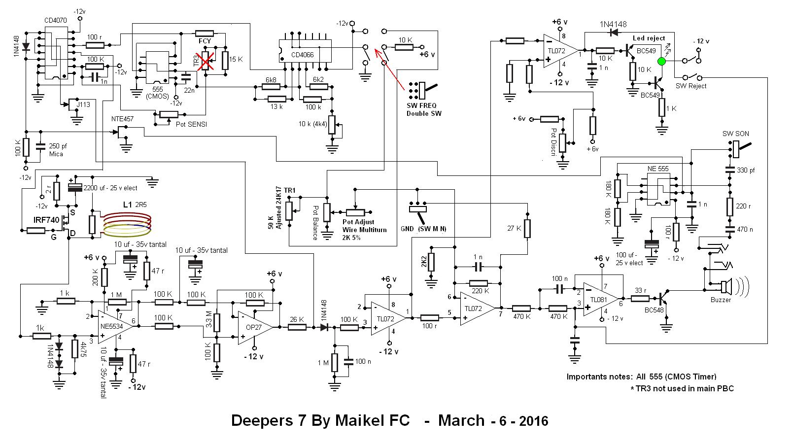

    Here I post two schematics Deepers 7 and 10, they are not complete yet. I don have the values for Deepers 10 DD but the sch I thing is correct. This is very similar to Deepers 8 AT.
    Deepers 7 reversed by me.
    All power source of Deepers are the same with a small changes.
    if somebody have the values for complette these schematics please post here.

                      Please forgive my ignorance but why are the electrolytic capacitors marked with Positive to GND?
                      Is this correct or an error in your labelling?
                        It is not an error because GND is Positive
                          Deepers 10 FULL.JPG. The LF412 pins at the audio output is error. Pin 5 and 6 reverse
                            Do not know what the author designed for the purpose of this circuit? Use double d coil to identify iron metal? Then its post-level amplification is correct, is stable, what are the advantages?

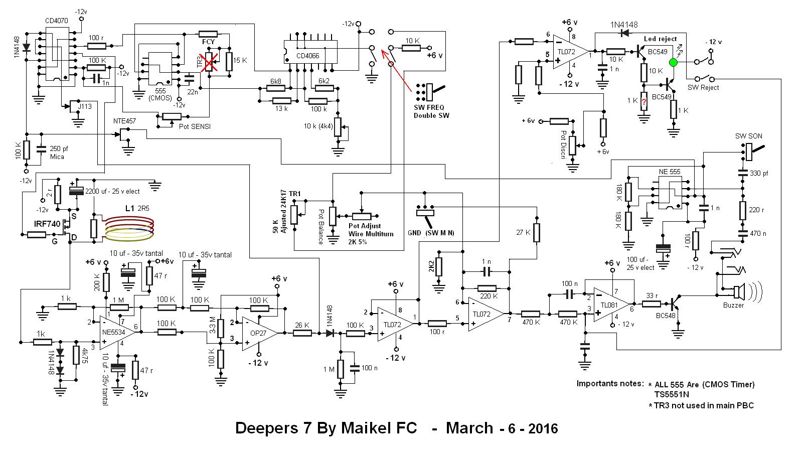

                              Hello again Here is a some correction for two schematics posted by me before.
                              I will post the hipersensitive search coil 53x25 cm factory details soon. Number of turns, dimensions and exact type of wire.
                              The frame 1mx1m is made from litz wire type. I dont have numbers of turns in this moment.
                              The Deepers 8 posted here in the forun is correct, I have been make it and test in ground, very good on a no mineral and low mineralized ground, in red ground is not Good, to many noise even using a DD coil. This PI Met Det is exact Deepers 10 design I think very little difference. The power source for Deep8 is not posted here. I will post soon the Deep 7 factory power source for you and I think is almost Deep8 AT. Same power source Ground(0v) -12v and +6v.
                              Any doubt or change, mistake etc please email me.
