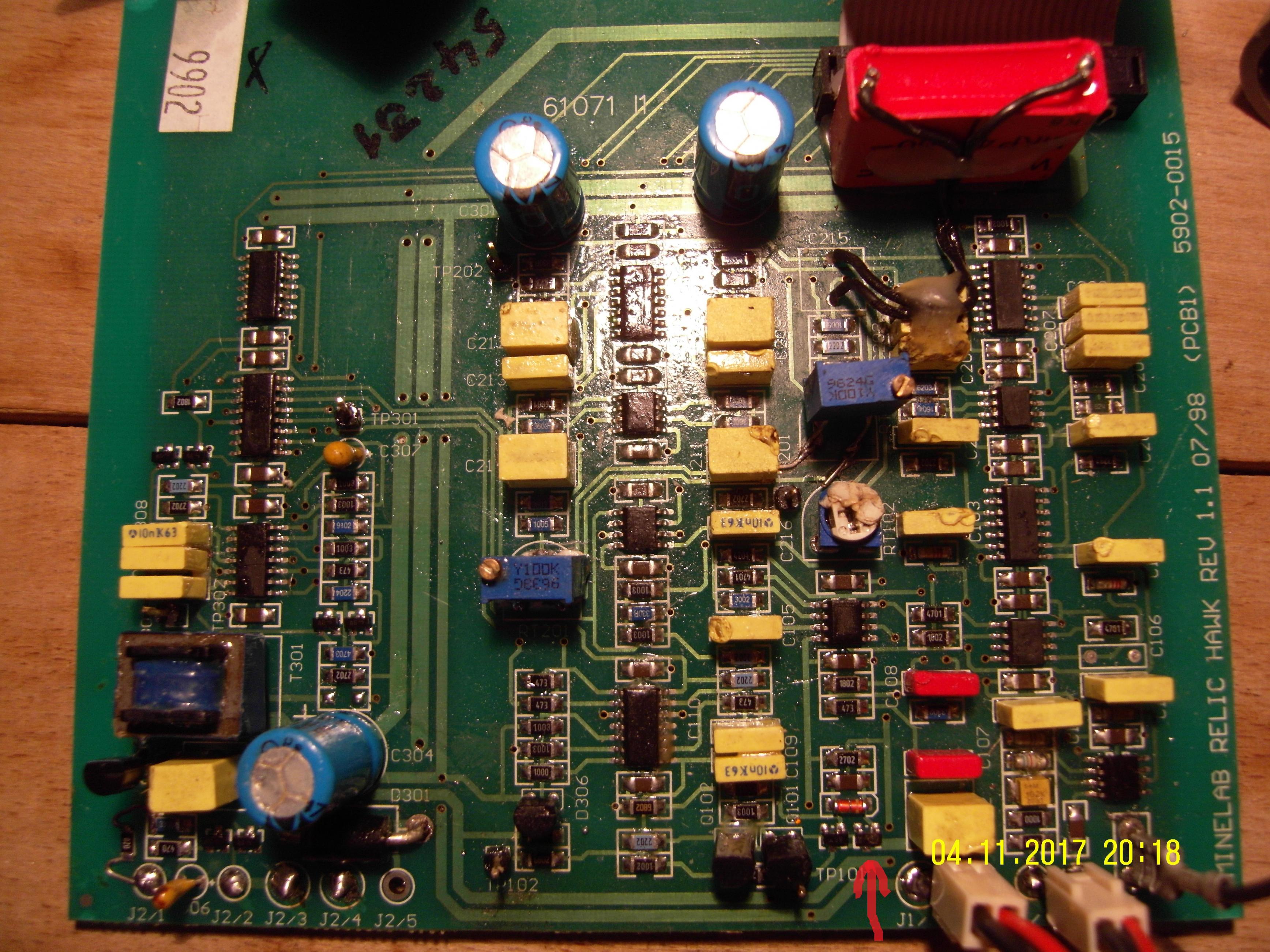

    Ho un Riparo Minelab in riparazione, è un vecchio metallo e non trovo informazioni in linea sui componenti da sostituire, ovviamente eliminati tutti i processi è difficile .......................
    certamente c'è un transistore bruciato e non leggi il codice
    se potete aiutarti sarò grato a te
      Hi Qiaozhi
      sorry for the translation
      good morning
      I'm Luigi Cataldi resellers and Repareir Metal Detector on Italy
      I have a Minelab relic hawk in Repair, it's an old metal and I do not find information online for the components to replace, obviously eliminating all the code on integrated the processes is difficult ........ ............. ..
      there is certainly a burnt transistor and you do not read the code
      if you can help me I will be grateful
      the images attached are minelab relic hawk in repair

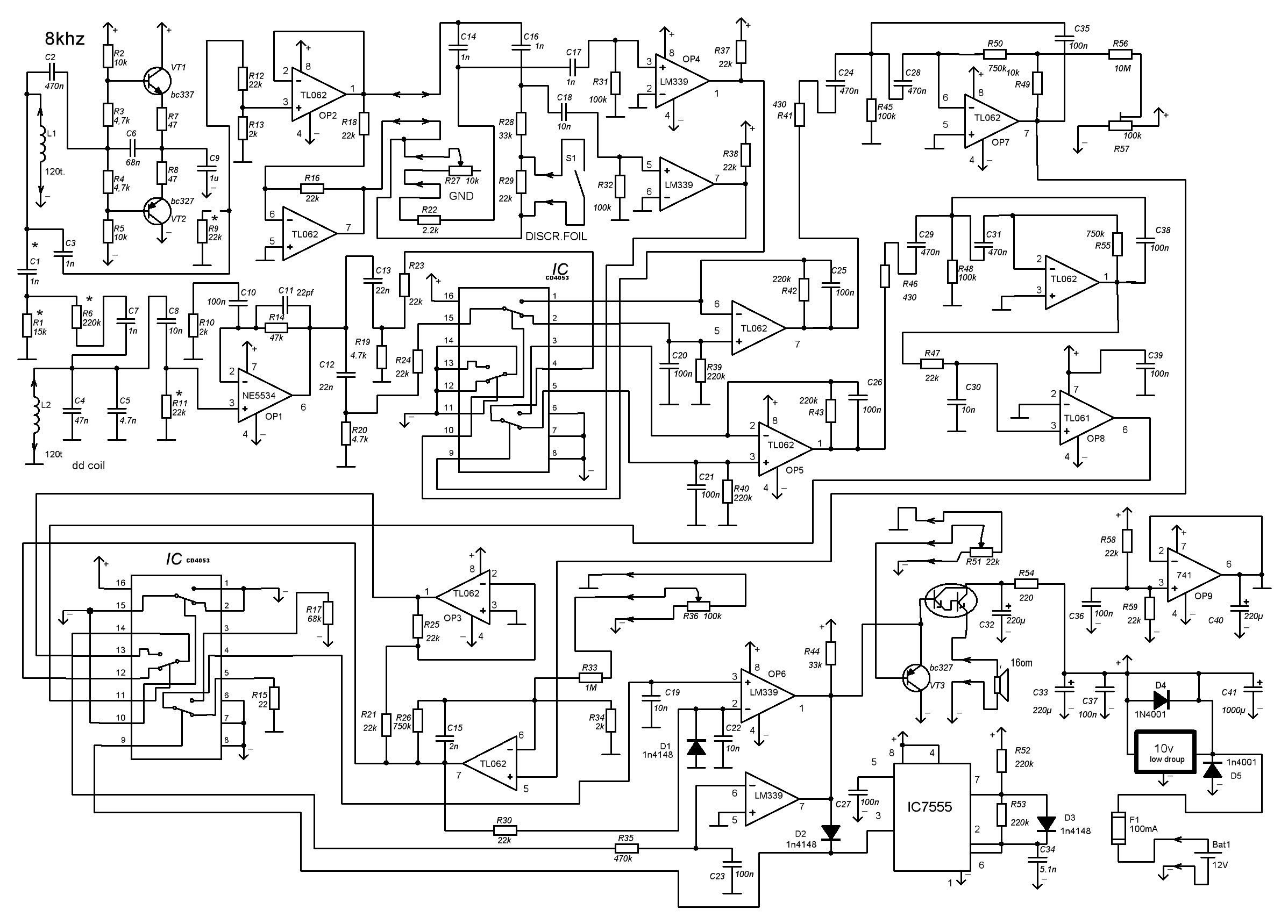

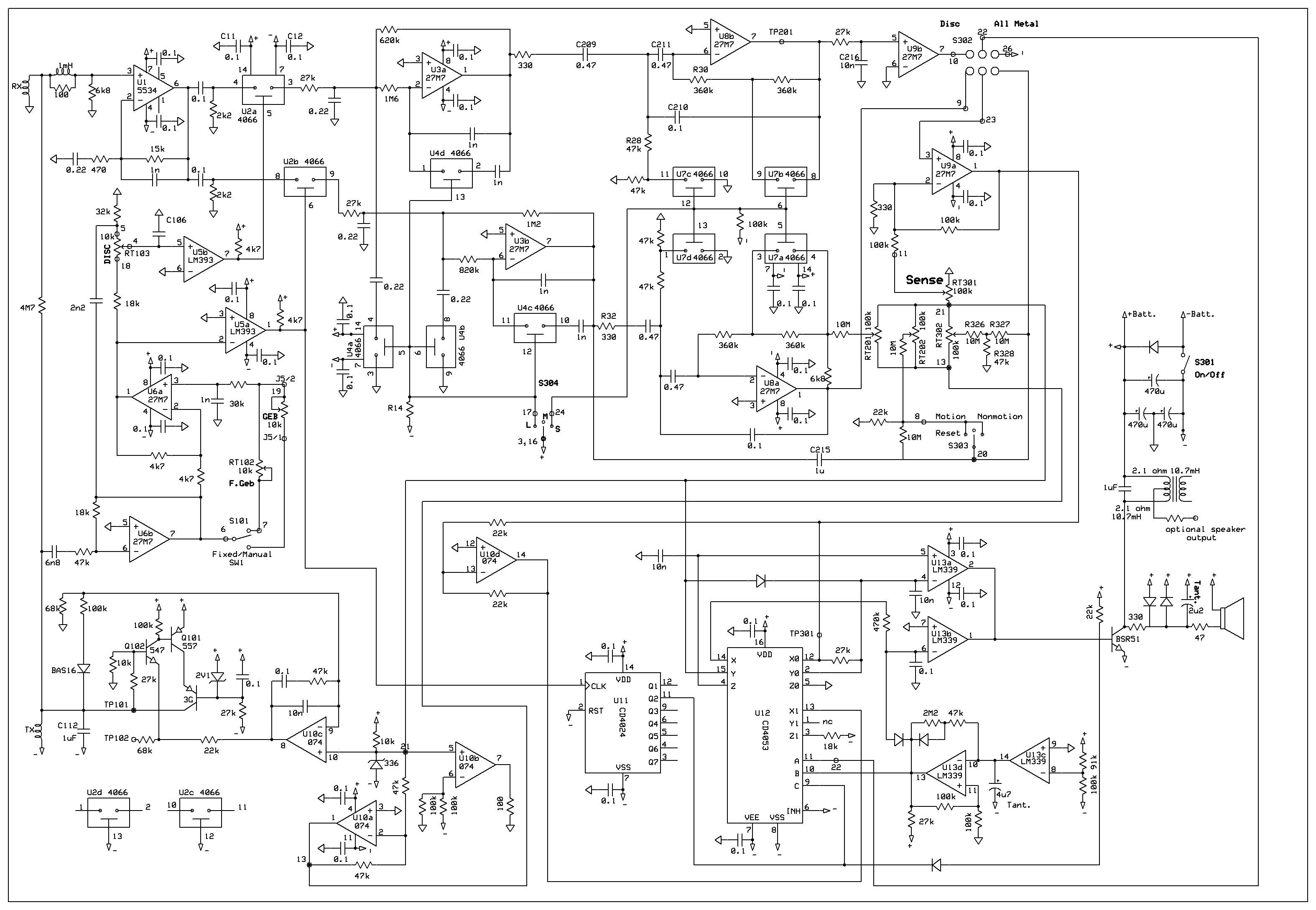

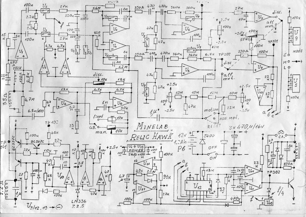

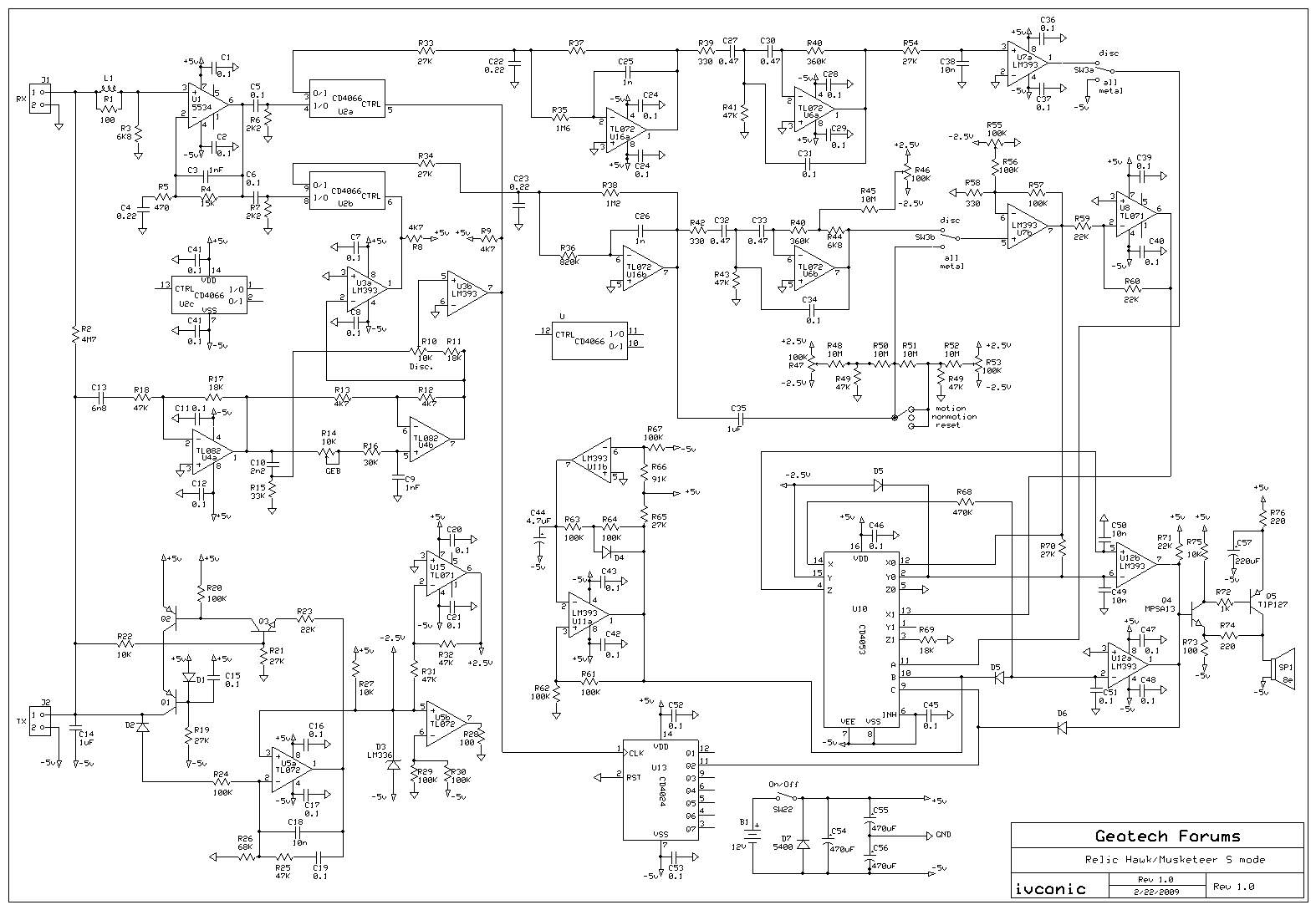

        The only information I have are a few schematics of the Relic Hawk. Some have transistor numbers and some don't.
        These might give you a clue.

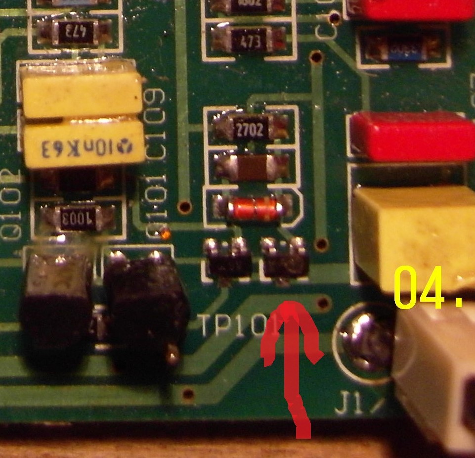

            thank's Mr. Quiaozhi maybe i found the missing transistor in BC 557 that is connected to the diode on the coil TX, as soon as I make the necessary changes of components I update you
            Mr. Kt 315 if you need better photos, for me there is no problem tomorrow I do other with a photo camera 15 megapixel
              thanks guys problem solved
              I changed the bc 857 and the brs 51 to the audio
                      I don' think the file "re=.jpg" is for the Relic Hawk. In fact, I can't see what's driving the TX push-pull stage.
                      Interesting circuit, though
                        yes infact "rel jpg" it's schematic the musketeer
