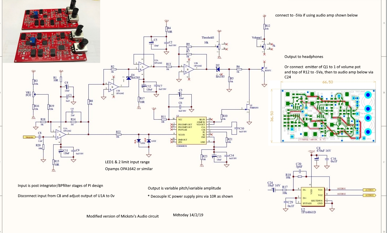

    Here is a great little VCO circuit Mickstv posted back 2-3 years ago and I've had veroboard version for use on my bench for so long..it finally gave out so I decided to put it onto a PCB.
    I added extra decoupling, changed Fet and added option for audio amp connection..all vanilla stuff.
    Had 10 Blank PCBs made by PCBway for $25 Au and $20 of that was delivery.. Thanks for the heads up on that Moodz.
    I normally use a digital audio version of this but sometimes analog is a better fit and Mick's circuit was worthy of a pcb
    It is SMD using mainly 0805 parts.

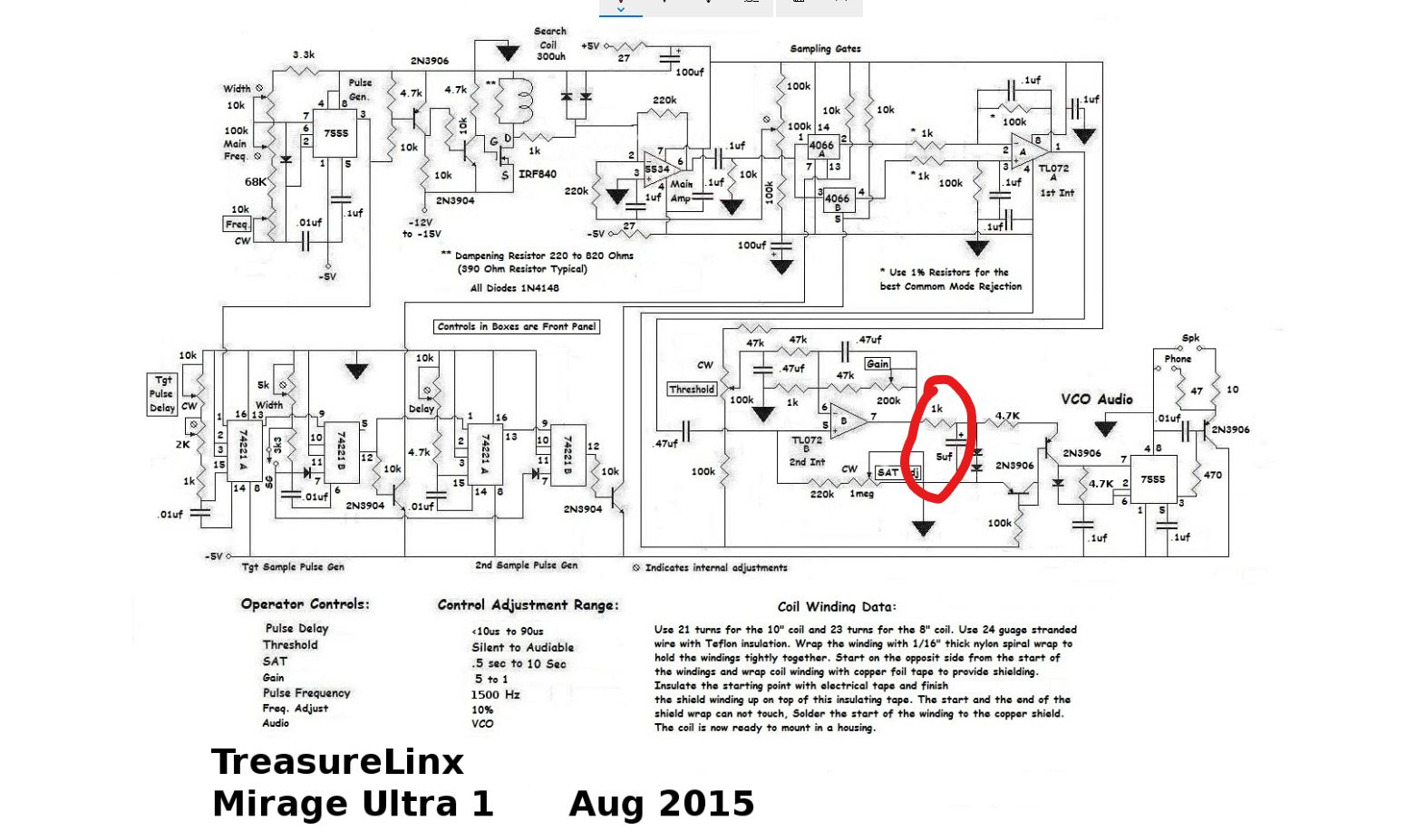

    How might this design vary in functionality compared with the TreasureLinx Mirage Ultra 1?

      Hi Elliot,
      I'm not familiar with the audio of that detector sorry,so I cant really compare.
      This circuit has a nice stable threshold, good sound, good input/output range and can be added to most PI front ends after the integration and filter stage.
      You can drive headphones direct or couple the output to the audio amp section shown with little effort.
      Its variable pitch variable amplitude back end..
      cheers
      Mdtoday
        Elliot
        Ok, now I have looked at the Mirage PI PCB, its a version of Carl's Hammerhead , from what I can see anyway...
        In that case the input to the circuit I posted would come from the Output of 3rd gain stage..
        The difference in audio stage is that the Hammerhead (version 1 is what I'm referencing) has the option for variable pitch or constant pitch variable amplitude.
        Mickstv's circuit has both rolled into one. Maybe the mirage version has both too, I cant tell from looking at pictures
        cheers
        Mdtoday
          You're good at this - I can tell! Yes, the Mirage is a derivative of the Hammerhead. I don't like VCO outputs generally, so to have the option of a single tone and variable amplitude would be nice. I have attached the schematic of the Mirage. I assume that the output from the Mirage would be around the area I have circled.Click image for larger version

            Mdtoday, thanks Mick has some great circuits, dont know if he is still around.
              Elliot,
              Thanks for posting the schematic
              You could pick off from there, although there will be mods around the threshold...don't need 2 ..
              Umm, I think we have wires crossed...Micks circuit has variable pitch and amplitude

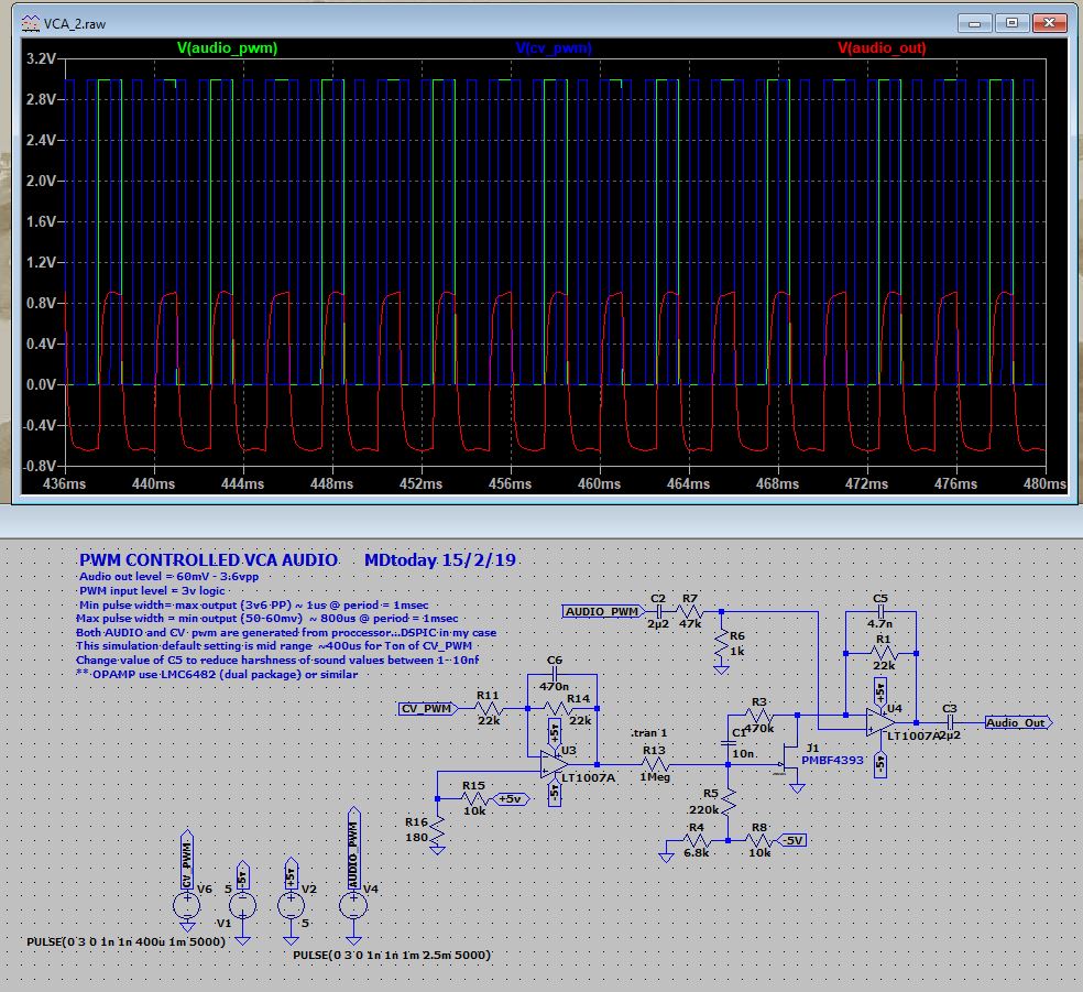

                        Here is the processor controlled audio I generally use...has variable pitch variable level.
                        It works well too. It uses 2 pwm outputs from DsPic.
                        Spice circuit and screenshot attached.

                              Just to add a bit more info..
                              My VCA circuit while designed to be driven from PWM outputs of a dspic or similar, is versatile enough to be a standard variable amplitude single tone output by using a 555 , cmos osc etc as audio input and feeding the CV input with a conditioned 0-2v DC signal from your favourite integrator , filter and gain stage. I don't vary the Pulse width into audio input only frequency ..eg digitise front end signal after integrator and filters then pump the value out to the PWM. The CV input is set frequency but variable pulse width which is based on same digitised signal input but inverted and firmware filtering and threshold added to it
