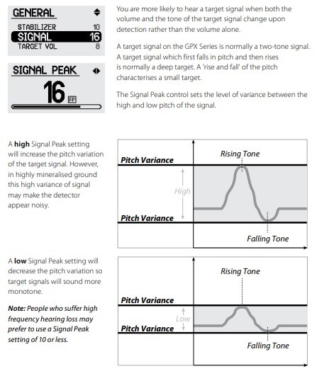

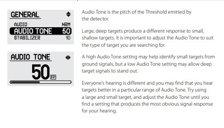

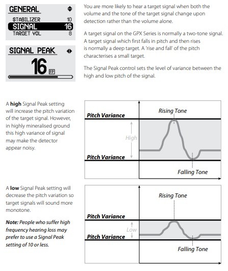

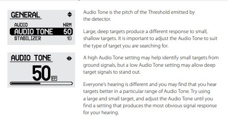

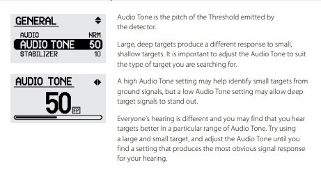

      For better understanding, please first see the following pictures. It is a part of GPX 5000 menu, its audio part.
      As you see, the machine uses two options the named Signal and Audio Type.

      Now, please consider Mr. Mickstv's schematic. Can you guide me how to add two pots (variable resistors ) for controlling the signal and audio type?
