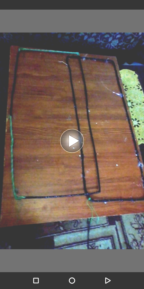

    this is my new deep vlf metal detector
    12 khz high power tansmitter
    40*80 coil
    discrimination with led

    Hi ossamaussama,
    What type of ground balance are you using?
    Auto, Manual ,Preset?
      manual ground balance
      the coil is made using fiber glass anf it is heavy
      i will post sechmatic and pcb later
        https://www.photobox.co.uk/my/photo/...d=501970155203
          It sounds like a Pulse Induction machine.
            no it is vlf

                coil is like DD
                  Awesome
                    Pulse induction machines also have DD coils. Maybe this detector has pinpoint mode.

                      no my friend it is really vlf static mode with discrimination
                        Hello ossama. It's not bad MD. but not deep at all. because with such a big metal boxe you tested it with, you should have maybe 2 meter or more, because the coil is really big, normaly we expect a long detection distance.
                        best regards.
                          best regards.
                          you are right but the coil is 40/80 and not tested with max sensitivity , i decide to make another 50*100cm coil but big problem is weight try to find another method rather than fiberglass
                          advantage over pulse induction is discrimination and sensitivity to gold frequency is 12 khz will not suffer from interference from 50hz powerline

                            Hi ossamaussama,
                            Can you give a example of your disc on large items?
                            Maybe place the items on the ground and swing the coil over them to hear ground response as well as target response. If possible disc out a coke can and still hit a large peice of real lead.
                            And What is the depth loss at those disc levels?

                              ok i will do that later and upload video
                              there is no ground response because of ground balance circuit
