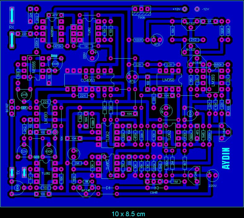

        how can I send my PCB to this forum
          DeepVlf
          my question:
          this PCB is correct ?
          where is led connection?Click image for larger version
            Originally posted by sayan1345 View Post
            my question:
            where is led connection?[ATTACH]48171[/ATTACH]
            NE555 is reversed.
            The top left should be pin 1.
            Pin 4 and 8 must be connected together.
            The 100k trimpot cannot be connected in series to the Tx coil.......
